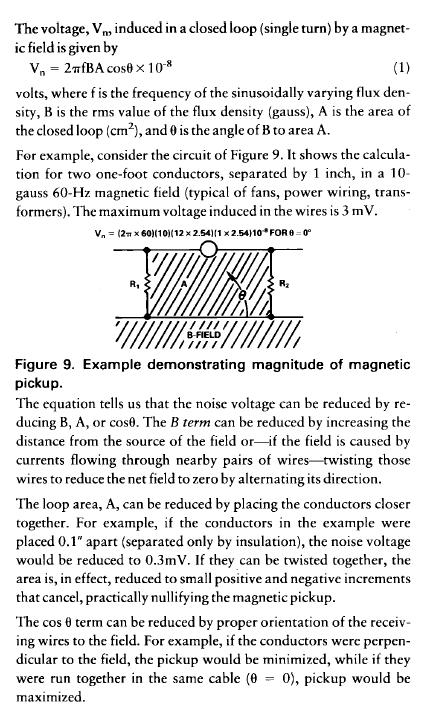

An observation I have made, not only in this thread, is that many
controversies, not the least those that tend to lead to personal
insults, seem to have their origin in the fact that arguments are
presented only in plain text and are often somewhat sloppy or
ambiguous. I think many of these controversies could have been
avoided if someone had brought in some mathematics early in
the disussions. Unfortunately, it seems many threads have a
tendency to die out when somebody dares to do so. 🙁 Personally
I applaud Freds initiative to post the formula above.
In Sweden we use to say that a picture says more than a
thousand words (I don't know if you say so in english too).
I think one could just as well say that a formula says more
than a thousand words.

Christer said:I think many of these controversies could have been
the disussions.
I thought I was the only one suggesting that more math would be helpful in understanding the skin effect topic.
Unfortunately, not one soul listened, 🙂.

But I don't know that the forumla actually resolves the issue.
For example, look what happens when theta equals 90. The cosine of 90 is 0. Which will give a Vn of 0. Does that mean that Vn is zero because there's no induced voltage anywhere in the loop or because the voltages across each half of the loop are of the same magnitude and polarity, i.e. common-mode?
The posting of a formula doesn't necessarily solve an issue
immediately, but a formula is usually a much more precise
statement than text is, so it is easier to discuss the issue
when referring to the formula. Your question above is very
clear becuase it directly refers to the formula. As for the
answer, well that's for somebody else to give, I am afraid.

More specifically, where Whitlock says:
AC magnetic fields induce voltages in wires. The magnitude of the voltage depends on the strength of the field, which depends on the distance between wire and field source. Therefore, equal voltages will be induced in the two wires of a balanced cable only if they are equidistant from the field source. Any voltage difference is added to the signal as noise.
Twisting of the two wires is a first-order technique to make induced voltages identical by averaging the physical positions of the wires.
The "statement in question" however says that magnetic fields induce voltages differentially, not common-mode and therefore cannot be rejected in a balanced interface. To repeat:
Noise induced by varying magnetic fields will be differential and not rejected by a balanced circuit, which rejects common mode noise.
So the question to me was, which is it? Are voltages induced by magnetic fields always induced differentially as the "statement in question" states, or can they also be induced common-mode as the Whitlock reference states?
If one is correct, the other must be incorrect. If the induced voltage is always differential, then there's no common-mode component.
The Whitlock reference says that the purpose of twisting is to assure that the induced voltages are as common-mode as possible so that they can be rejected at the input. The Capgo reference as well as the page Fred just posted say that twisting works by alternately flipping the loop so that the voltages induced in the loop cancel such that ideally, there's no noise voltage to deal with at all, differential or common-mode.
This takes a few rereadings to understand the train of thought behind it but it seems correct.
When equal voltages are run on both send and return of the balanced cable it will be seen by the balanced receiver as being common to both and will be rejected.
The question that arises is :When are the two wires equidistant from the source of radiation?
When the send and return are tightly twisted they would be equidistant, wouldn't they?
Does it say that? That's not how I see it.
It's really badly worded and it's not what goes on in a twisted pair.
