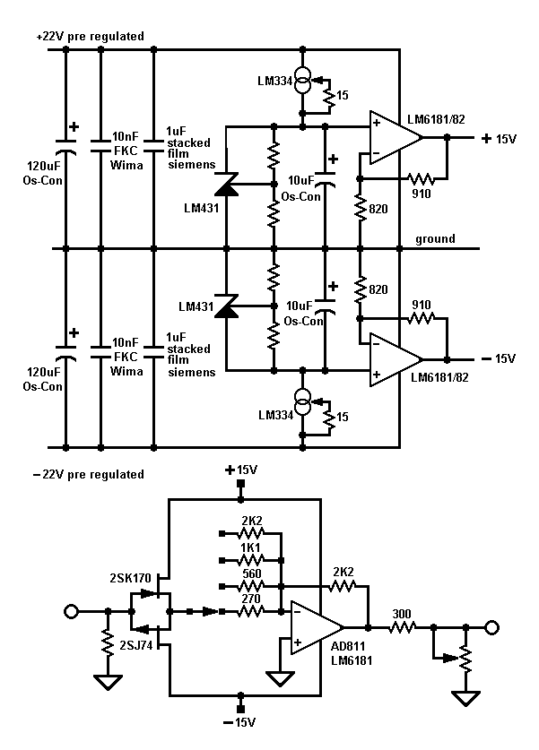

"PS, attached a rendering of an experimental linestage from a few years ago, drawn by Carlos M. from a description by me, no guarantee for accuracy, I never drew a schema of this, all this is from memory and my memory is notoriously bad.
I think I had a 1k resistor (maybe 10k?) between reference Voltage and Op-Amp input for the reg."
With 10k and probably around 47uF Os-Con (that's what i tend to keep around in my parts box) we have a 1st order filter with 0.33Hz Corner Frequency, with 1k (I really can't remember - I probably used 1k) we have a 3.3Hz corner.
This means at 33Hz our noise is aready 20db down from that of the bare LM431, at 330Hz it's 40db down. And I agree, even so the noiselevels could be improved. Of course, I was not actually chasing lowest noise myself (Didden San is), I was chasing a very different parameter.
I know. Place the resistor needed for stability in series with the inverting input. As said, lowest noise and lowest output impedance as such where not design goals.
Fully agreed. Don't even bother to try to measure the PSU Lines with a normal 'scope. The regulator and amplifier circuit will oscillate with the load capacitance of a 'scope probe, while I found it stable in normal operation. For the Amplifier, we have a large enough value "build out" resistor to make the circuit operationally unconditionally stable, except when someone pokes around with a 'scope.
Funny. I seem to have missed you actually building the circuit. So empiricism seems not to have featured. But semantics is hardly a specialty of mine.
Sayonara
Fred Dieckmann said:(Yes there is a way to put a large cap in the feedback loop to drop the AC noise gain to unity with DC gain still greater than one, and have still use a current feedback op amp)
Fred Dieckmann said:Anybody that wants to take a shot at this circuit should have about a 500 MHz scope and resistive scope probe. A regular scope probes capacitance will alter the stability of this circuit when measuring it.
Fred Dieckmann said:I hope this was empirical enough for everyone.
Sayonara
I am sorry I was going by the schematic and did miss that. I still maintain that the LM431 is a much poorer reference the LM329 in terms of noise which is very relevant in audio supplies.
I would not put the LM334 directly in series with the LM431, as both derive there characteristics from feedback circuits, and some pretty nasty circuit stability can result. The transient response of the current sorce and voltage referece ore nasty enough by themselves.
"As said, lowest noise and lowest output impedance as such where not design goals."
Kind of strange, PSRR, noise, and output impedance are the merits on which voltage regulators are judged. There is a pretty wide consensus that they correlate pretty well with how a regulator sounds. The RF stability and rejection are usually addressed with decoupling caps for some pretty good reasons. What is it that this regulator does so well again? No comments on the push pull versus single ended question?
"Funny. I seem to have missed you actually building the circuit. So empiricism seems not to have featured. But semantics is hardly a specialty of mine."
I think you need a new Psychic. You seem to be getting a lot of misinformation on my activities. I don't think I could have come up with all of this from reading data sheets. I have been working with high speed analog circuits for over 15 years. I guess don't understand what your real dispute in my observations and numbers.
I then trust that you must have quite some experience with building and listening to the Jung regulator since you so readily disputed Andy's observations and made statements contrary to my findings as well. From some of your comments, I wonder if you have read the articles about its development. I think technical concerns have been addressed some time ago. The stabilty concerns are kind of funny considering the equally valid stability concerns of the LM6181 circuit Those who live in glass houses..... By the way, I believe Andy knows more about the circuit that even Walt Jung does at this point.
I feel that semantics will become a specialty of yours given the amount of attention you have devoted to it of late. I welcome your input on improving my communication skills.
You stated that you liked the LM6181 regulator sound but switched to valves. Maybe you didn't like it that well then?
Good night from soon to be sleeping giant,
Fred
"As a pre-regulated supply is supplied the 120 Hz rejection is not an issue."
Let me try and understand this....... you were describing the virtues of 120 dB of PSRR, and now you tell us we should use a preregulator as well. The whole point of my discussion of the PSRR was as a matter of comparison with the LM317 which is a pretty good benchmark fromits use in many high end audio line level circuits. It appears to me (and I will be happy to be told otherwise) that your regulator is about 10 times worse in this parameter at 120 Hz, where a large portion of the supply noise in the unregulated supply before the regulator resides.
A lot of people feel that PSRR is one of the most important parameters in a regulator for audio. I have heard the superiority of shunt regulators mentioned by many here. The real advantage of a shunt regulator is very high rejection of noise on the unregulated supply (PSRR) with a reasonable level circuit complexity. I would even dare to speculate that a preregulator would not be required.
"Except, the cable capacity as such does not directly load the regulators, merely indirectly."
Cable reflections (your topic originally, I believe) and RF noise do induce currents from the output of the preamp. These currents come from the supply terminals that the LM 6181 is regulating. Pretty much all of it ;with no decoupling caps for the op amp, (or other circuit types) I would think. RF currents in the output wind up on the supply. The cable capacitance is not directly across the supply but device and layout capacitance and will resonate with the inductive output of the regulator at have frequencies. Audio circuits don't like RF and its presence is often audible.
"While all you say is true you are as usual of poor reading ability, as you seek not to understand but merely to "proove a point". Had you bothered reading yould have noticed in my original post the following remark: PS, attached a rendering of an experimental linestage from a few years ago, drawn by Carlos M. from a description by me, no guarantee for accuracy, I never drew a schema of this, all this is from memory and my memory is notoriously bad."
Fred

A mix seems to work well...
I was playing around with various fixed regulators for a preamp project I've been working on. For various reasons the last few I've tried were On semi's: MC78M15CDT and MC79M15CDT, along with the 12V versions (purchased from Arrow); and National's LM2990S and LM2940CS, also in 12 and 15 V versions (from Digikey). All were TO-263 style.
The scheme is +/- 21VDC (RC filtered: 0.1R with 20kuF per rail) going via 0805 ferrite beads to 15V regs and the output from the 15 regs goes to the 12V regs--15V regs are 'pre-regs' for the 12V regs. (There is circuitry, a load, being driven by the 15V regs and the 12V regs.) Caps on output of regs are Cornell Dubilier SMT Ultra low ESR (SPV107M16M24T; Mouser) 100uF/16V bypassed with 0.1uF PP in 0805 SMT.
The LM series looked pretty clean on my scope, but there were still some high freq garbage, especially on the neg rails. When the MC series were substituted, the neg. rails looked very good, but the pos. rails were absolute garbage. A lightbulb can on, so I swapped out the MC pos. regs and substituted the LM pos. regs. I kept the MC neg. regs in place.
This mixture gave extraordinarily clean rails. While I only have a 20M scope with my lowest scale at 5mV, using a 10x probe showed 5mV of ripple going into the 15V regs and then nothing was visible after this, just a flat line. (To better accentuate matters, I drove the preamp circuit with a 120Hz signal; it syncs my scope better; changing freq didn't reveal any more junk.)
Sonically, the circuit with this mixture of regulators is quieter than I've ever not heard.
To summarize, the best combo: 15V are MC79M15CDT (-15) and LM2940CS (+15) and the 12V are MC79M12CDT (-12) and LM2940CS (+12).
Robert
Robert
Re: Re: local stuff
Well, you got me stumped here. In the beginning post #2 you mentioned you used exactly the same opamp for supply & amp, and told me how to get that working. Then again in post #80 you even capitalize the word EXACTLY. In my book, that's pretty close to advocating it. But it seems we're back to the semantics again.
Maybe Fred and I can get a discount if we sign up for the same communication skills course?😉
Sayonara,
Jan Didden
Kuei Yang Wang said:Koinichiwa,
I did not ADVOCATE this, I was merely playing a number game. In this case I I was pointing out that the calculation where based on so to speak "cascading" the same Op-Amp.
Sayonara
Sayonara,
Jan Didden
