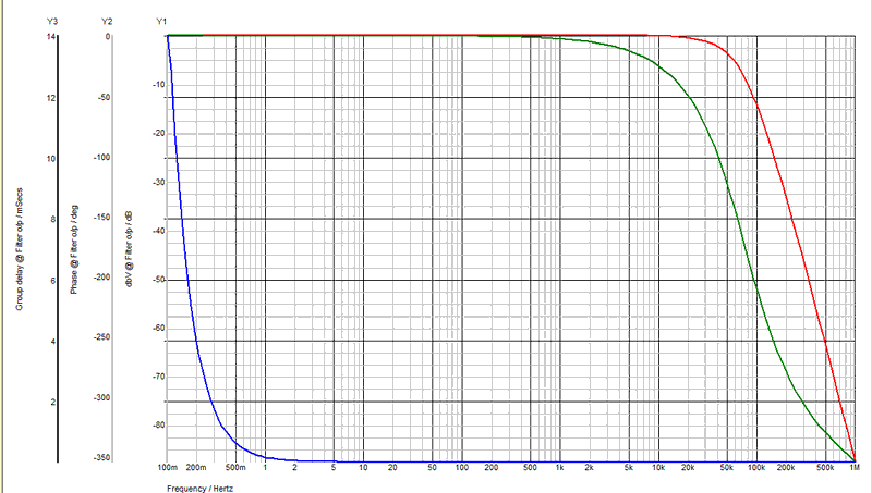

Actually, the lowpass filter does introduce phaseshift. It is really easy to measure too.
Hmmm, I'm struggling to measure it and hear it....you sure your test gear worked?
Red = amplitude, Green = phase, blue = group delay.

Not sure whom you're responding to...
Sorry, I assumed you've tried it.
If you don't band-limit the input signals, then wider bandwidth elsewhere may well sound better, that wasn't my point.
If you bandwidth limit the input signals badly, then the degradation is audible.
Do it with the filter response above, and you may well find things sound even better.
Before you ask though, I'm not publishing that design - sorry (it's not mine).
Andy.
You have a high-pass element in there somewhere? Just wondering why your group delay's increasing down there in the low end.
Oh, and seeing as you've got time for plots, how 'bout those FFT plots of battery noise you promised?
se
Yep.

Koinichiwa,
Well, according to your test gear you have 50 degree phaselag at 20KHz. To me that is much more than your claim quoted below would suggest:
"The input signal is then limited by a very high quality low-pass filter within the preamp, that limits bandwidth to that which is audible. It does this without introducing any musically important anomalies (e.g. phase etc)."

Re: Re: more b********* from the psychic
Yes, he did overstate on the issue of phase shift. But again, phase shift in itself is irrelevant. If you'll look at the group delay plot, you'll see that it's flat out to 1 MHz (excepting the low frequency group delay due to the high pass element). Meaning that all frequencies are arriving when they're supposed to and there's no alteration of the waveform.
