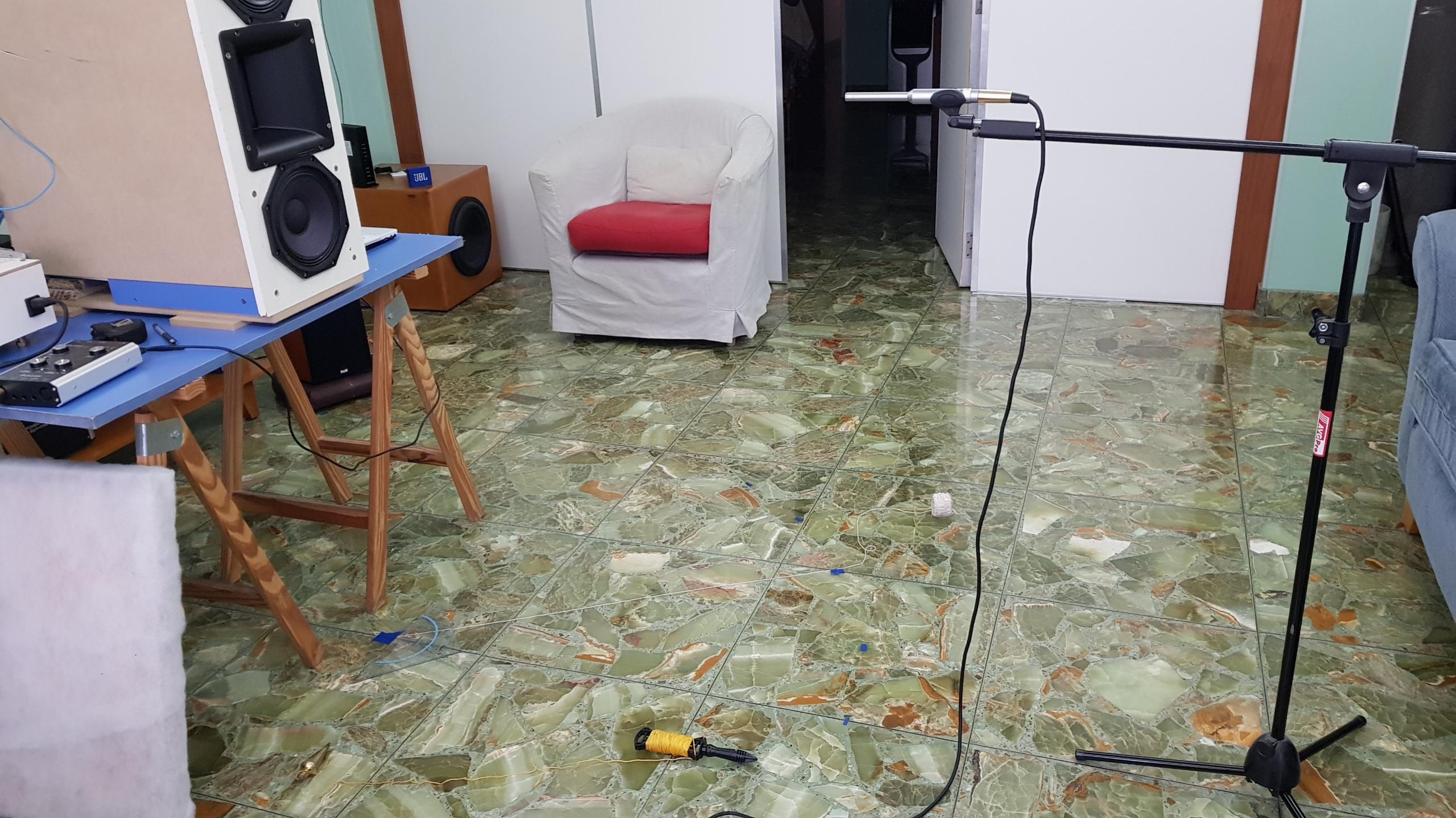

To document what I'm doing, and to get feedback:
I placed the MTM on a table such that the the middle point of the tweeter is at half room height level. So ceiling and floor reflections are equidistant. I have an absorption panel on the floor to reduce intensity of that reflection.
The ceiling is 1.2 away from the tweeter midpoint. The bounce from the top midrange and back to the mic will travel 2.7m, or 7.9ms. I set FDW at 5 cycles in REW so all reflections above 650Hz will be gated out of the measurement. Is this ok or too small?
The mic is at 1m from the tweeter mouth. I marked on the floor at 15 degree intervals and 1m radius. You can see the first picture shows the blue marking on the floor and the thread marked at 1m, with the angle measurement at the point below the center of the baffle.

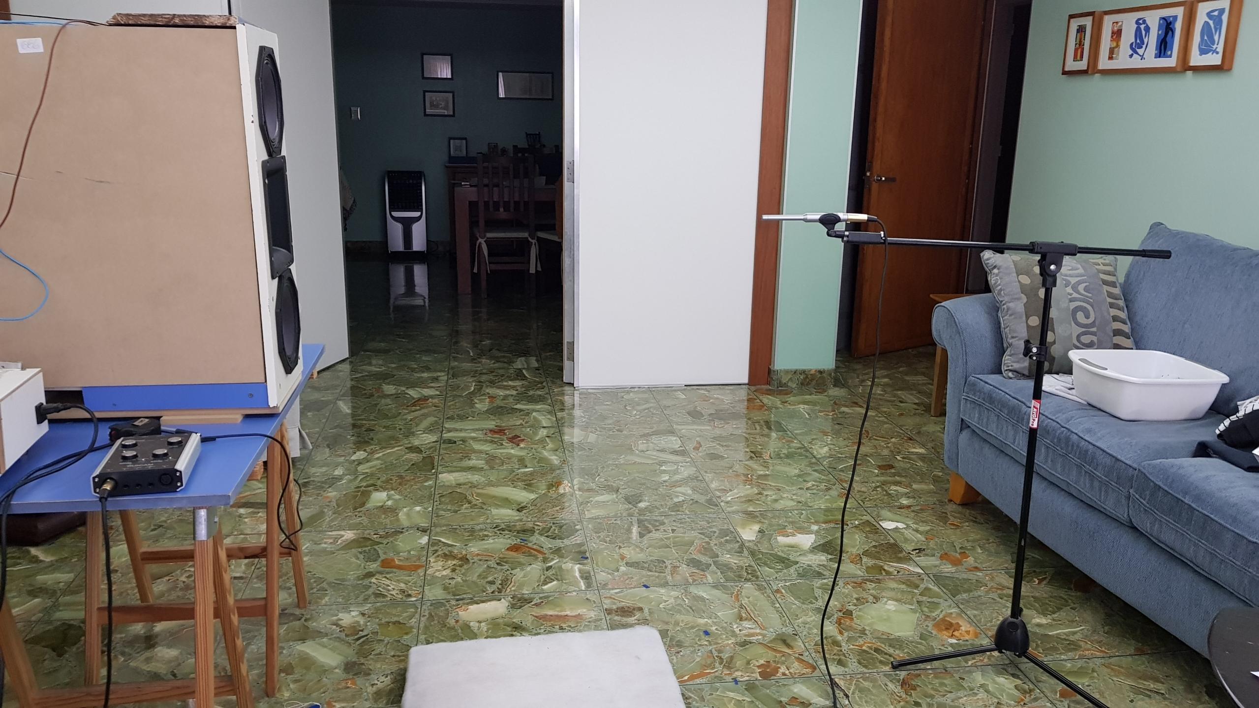

You can see the white panel door opened so to avoid the right reflection. The mic is 2m away from back wall, and baffle 1.8m away from front wall. So in the middle of the room.
Next up: measuring on vertical axis and at different horizontal angles every 15 degrees.
For vertical measurements I plan to bring the mic down (since I have the absorption panel) and towards the opened white panel doors.
Feedback?

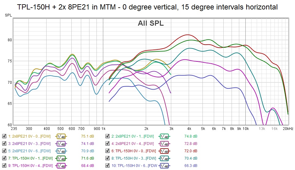

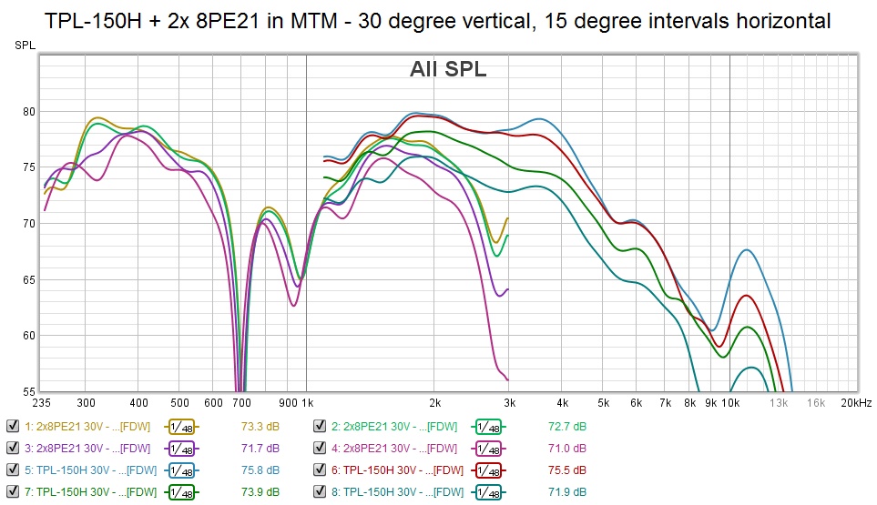

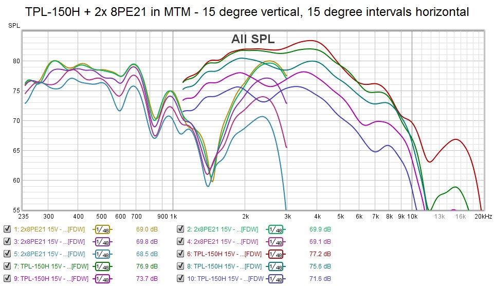

Did some measurements today. Attached the ones at 0, 15, and 30 degrees vertical and 0-60 degrees horizontal.
Pretty significant nulls at 15 and 30 for the twin 8" before the planned xo at 1600Hz. On the horizontal looks good, though.

Your third plot shows a null at 700Hz...
If you think this means 50cm difference between the mids then this would only happen at 90 degrees (guessing the distances by looking at the photo).
It must be something else, maybe the floor. Your pad is not enough to absorb 700Hz.

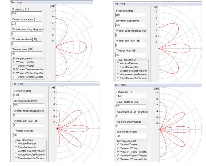

Attaching X-dir simulations of the double woofers playing alone. In X-di, driver distance is the midrange center to center distance to the tweeter, correct? In my case c-t-c is 45cm (close to you estimated 50cm!).
Looking at the first graph at 700Hz: the vertical lobe is as atrong as direct sound. In my experiment, when my mic was at 30 degrees below the tweeter that means the floor bounce had a 60 degree incidence angle (vs tweeter horiz) which we can see in X-dir has same intensity as direct sound. That sound traveled 184cm to bounce on the floor and get to the mic and took 5.4ms to get there. At 7 FDW, at 700Hz the gate is at 10ms, so the floor bounce must be it and as you say the panel used doesn't seem to be absorbing enough at those frequencies.
Coincidentially, at 15 degrees the null is at 1400Hz, double the frequency showing null at 30 degrees.
So most probably this is a measurement artifact. What should I do?

[I have made a mistake. Of course 50cm is a wavelength at 700Hz, not a half wavelength :eek:]
at 90 degrees
Simulation like this is helpful. Did Bills program expect you to use 225mm instead of 450mm?
Building the tweeter to be narrow at the cross, and getting the woofers closer.. this is the challenge of horn MTM. I am thinking two things, one is to use a more shallow slope when you cross so you share and smooth out the problem, and you can use your polar measurements in a crossover simulator that calculates power and shows the combined polars. The other is to manage your verticals with room treatments.
Compared to the tweeter, between 1-2kHz, the woofer is more wide in the horizontal and more narrow in the vertical. Maybe this is a place you can cross because it averages out (and maybe it is difficult to run the tweeter lower).
[I have made a mistake. Of course 50cm is a wavelength at 700Hz, not a half wavelength ]
Glad you called it out! I made the same mistake!! So my explanation would actually address the 1400Hz null. This would be good news because it's in the xo region but would seem like a measurement artifact, right? How can I confirm/test this?
The weakness in X-dir is the lack of a help function. I searched online and found references to being the c-t-c from woofer to tweeter in an MTM setup. But nothing really from the author. Over at Parts Express tech talk forum member fpitas "seasoned veteran" said so. Is he right? Dunno.
