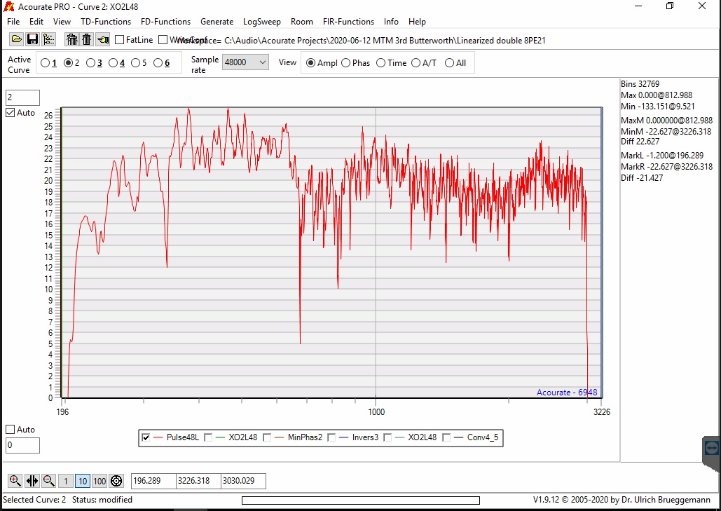

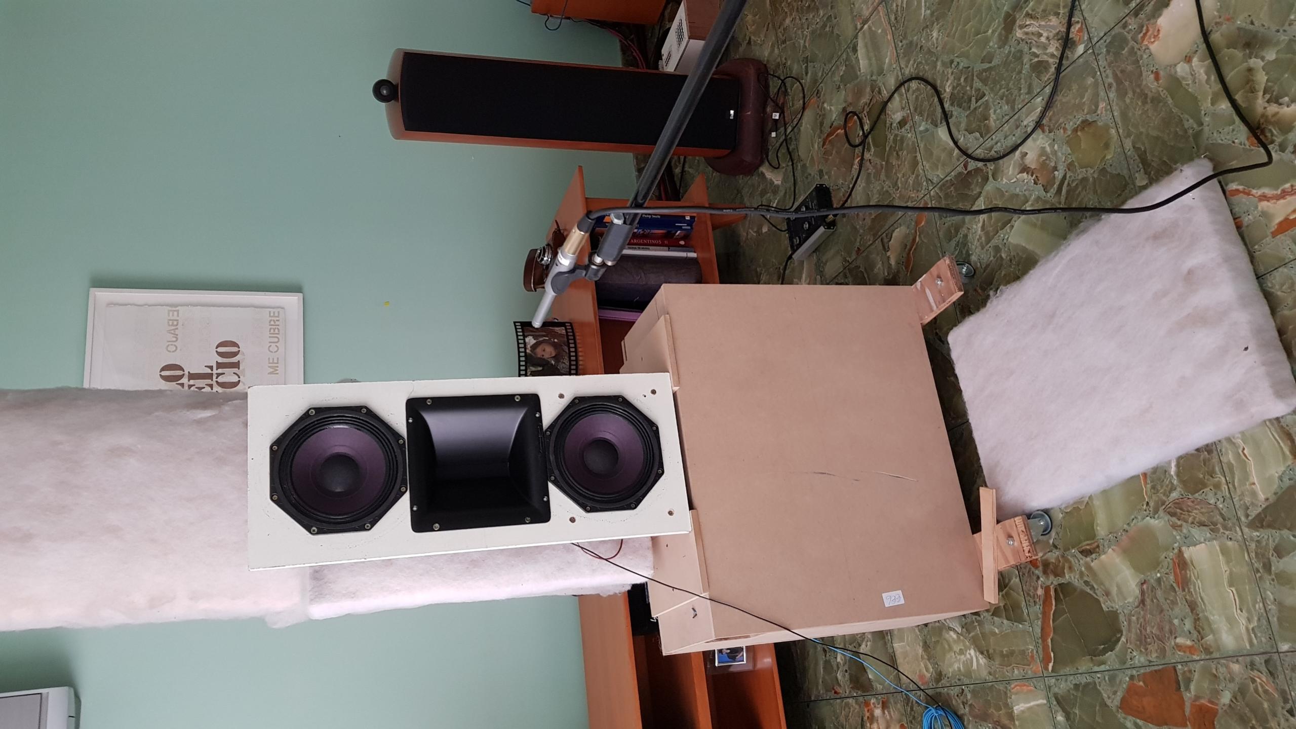

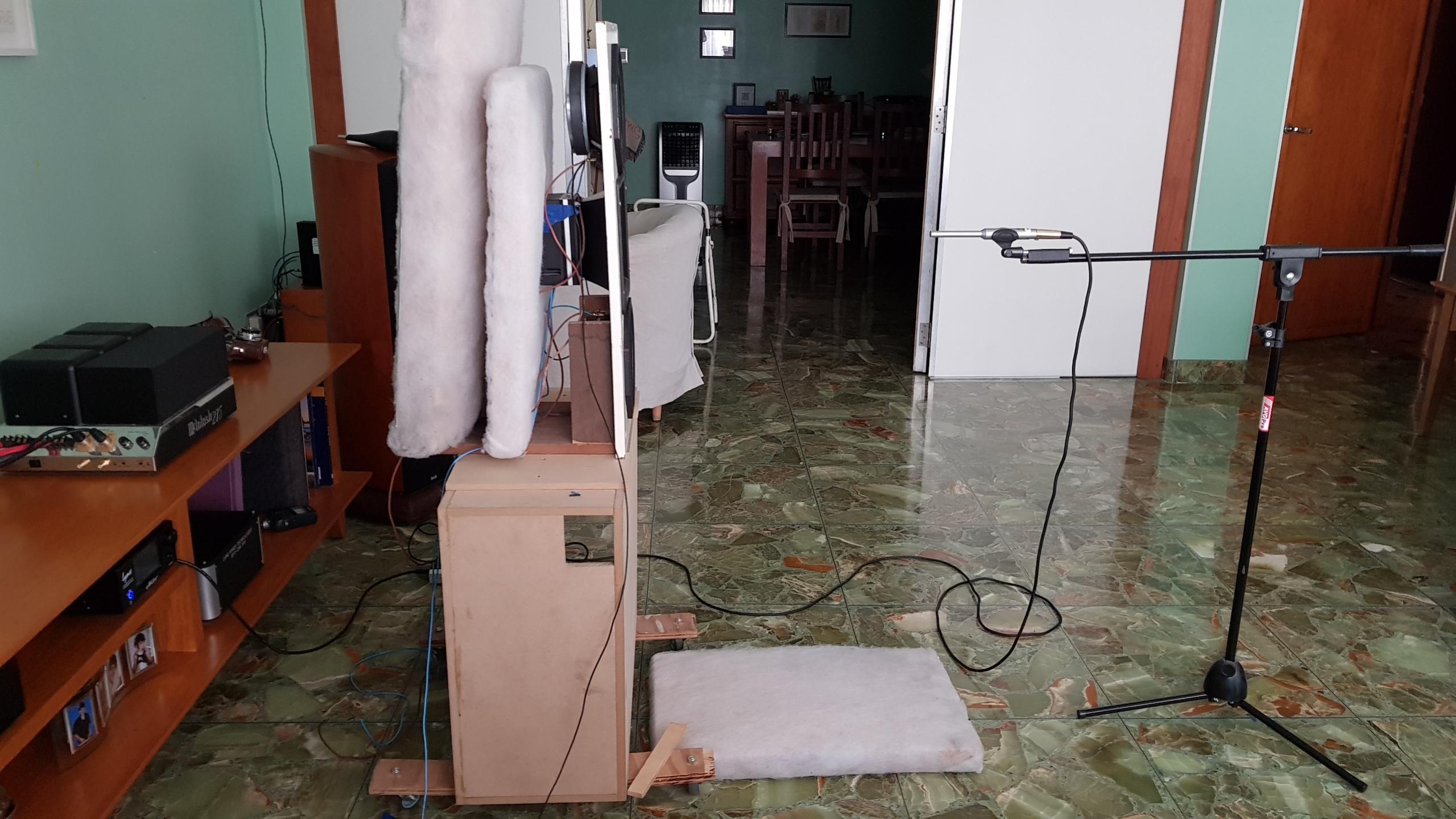

I measured the twin 8PE21 today. Attached pictures of the setup:
  • I added the panels behind (fiberglass) to attempt to mitigate the back wall reflection. Same for panel on floor.
  • Mic stands at 50cm from front baffle. The 8PE21 are 45cm apart, so I figured it was a better balance between being close to minimize reflection effect vs being too close that would be too off axis for the 8-inchers.
  • Measured 200 to 3000Hz, looking to linearize between 250 and 3000Hz (xo to TPL estimated at 1600Hz).
Feedback??

I wouldn't try to make this flat to your response measurement. You haven't considered what is happening with the baffle, or the cone. You may just run it out of range.
Not sure I'm understanding. This driver is spec'ed by B&C for 90 to 5000Hz, and 250 to 3000Hz looks rather undemanding from the uncorrected measurement on the post from today. What am I missing?
I think it depends on what you are trying to measure, right? I was measuring to linearize the driver thru Acourate, and measuring close is appropriate for that end.

I would only ever measure closer than 1 meter if I was doing a near field for a low frequency driver. There’s no reason otherwise to measure closer if you have the ability to gate the response using FFT. REW and ARTA can do this quite easily and is critical for removing the room from your measurements.
Typically you’ll want the mic distance at least two times the greatest distance across your baffle. If your baffle is 60cm high then I’d measure at least 120cm away.

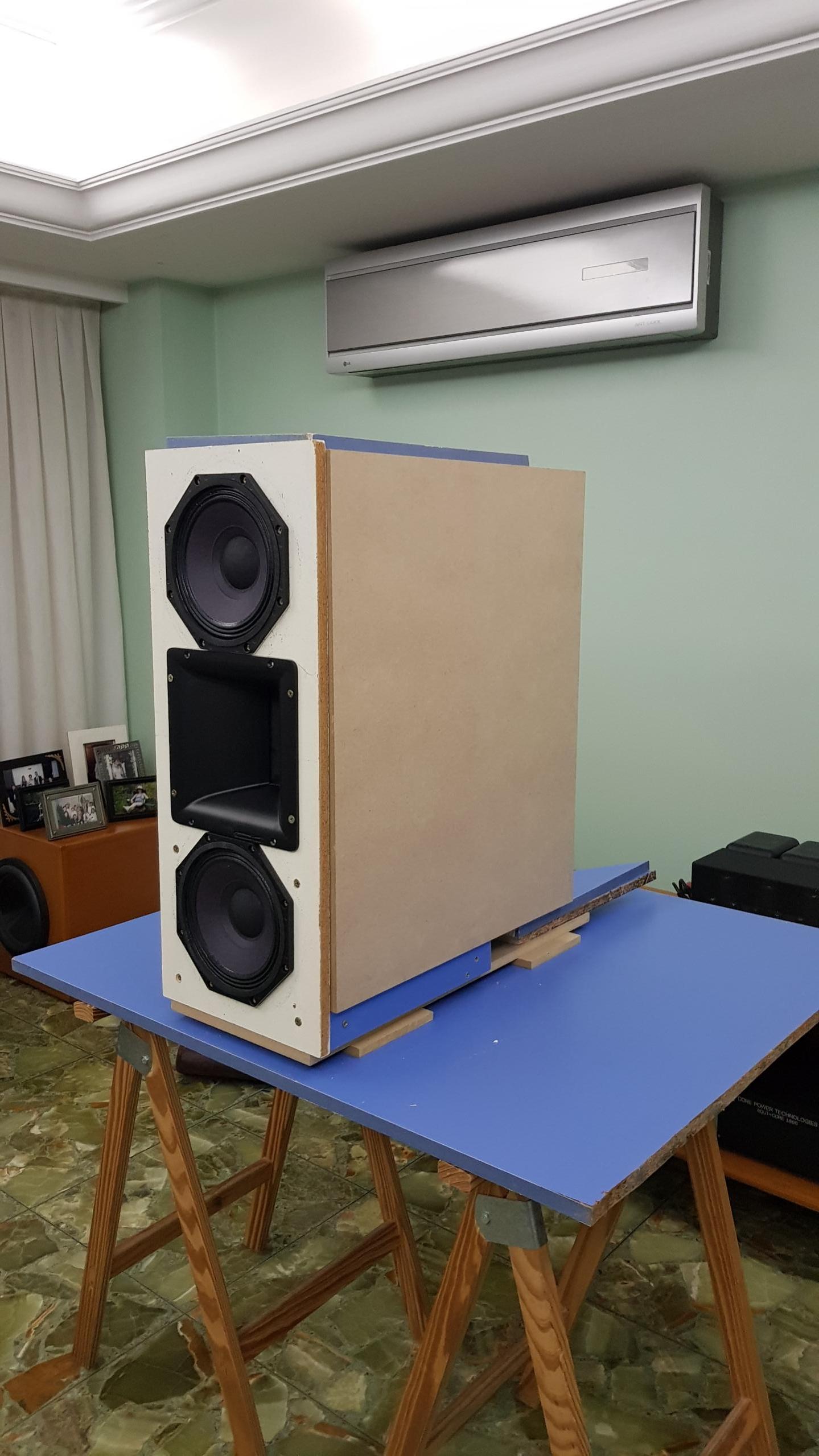

BTW, I was able to repurpose another box I had to bemoan the enclosure, so the back wave concerns are taken out of the equation. Looks better in the picture than what it actually is, but fits the purpose ��
For some reason this website doesn't rotate pictures from my phone...
