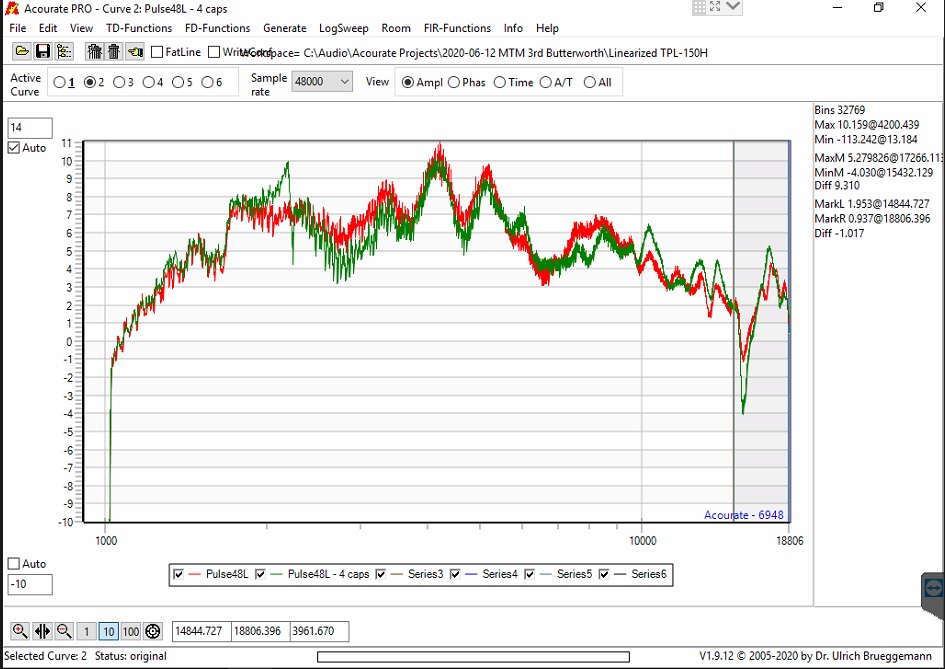

Interesting. Had not seen such remarks before. FWIW, attached what I just measured about my TPL-150H, measured at 8cm from the mouth edge at 0 and 30 degrees off axis. It doesn't seem to exhibit such behavior. Measured using Acourate, as I'm on my way to linearize the TPL before tackling the 8PE21.
Green is on axis.
Red is 30 degrees off, on the horizontal plane, 0 degrees on the vertical.
Both measurements include a protection cap that kicks in at 1600Hz, which I need to increase. That's my next step
Green is on axis.
Typically off-axis should be measured at 1 meter or further. If you’re too close then all your measurements will look similar. You need to gate the measurement to remove the reflections in the room. For anything above 1kHz you can use a 3.5 millisecond gate which means you need the speaker away from any reflections within a meter or so.
I think it depends on what you are trying to measure, right? I was measuring to linearize the driver thru Acourate, and measuring close is appropriate for that end.
