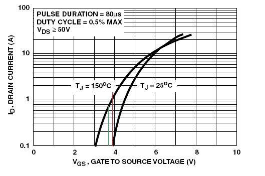

I know that IRFP mosfets have a positive tempco, but i've been looking at it's gate voltage vs drain current plots and noticed that the difference between current at 150 and 25 ºC shows an increase of some 400 mA worst case. This means that, when powered from 55V rails this would give an increase in dissipation of some 22W, but the heatsink will increase its dissipation from 0 to 30W (3W/C Heatsink to air), I'm not saying that i'm planning to run the transistors at 150ºC, but rather that this compensating effect would prevent them to reach that temperature.
Furthermore, since the transistors are showing a transconductance of more than 4 S everywhere, the increase in current will give a decrease in current of about 0,3 A with 0,25 ohms degenerating resistors, reducing the effect to an increase in dissipation of only 0,1A*55V = 5,5W.
If i'm right bipolars show a huge tendency to thermal runaway due to theyr very high transconductance. Is this correct or i'm going to burn my house?

Can you post something with reference marks to show where you are taking your numbers from?
I haven't seen your graphs, but I doubt you're reading them correctly.ionomolo said:I know that IRFP mosfets have a positive tempco, but i've been looking at it's gate voltage vs drain current plots and noticed that the difference between current at 150 and 25 ºC shows an increase of some 400 mA worst case. This means that, when powered from 55V rails this would give an increase in dissipation of some 22W, but the heatsink will increase its dissipation from 0 to 30W (3W/C Heatsink to air), I'm not saying that i'm planning to run the transistors at 150ºC, but rather that this compensating effect would prevent them to reach that temperature.

You are right about me not reading the datasheet properly. In fact I did it properly but the n-channel one has a much higher tempco and i did only look at the p-channel plots.
But the question is still there. Thermal runaway is caused by the transistor increasing it's power generation faster than the heatsink can dissipate and the degenerating resistor can block, not simply because it's increasing it's current.
The red line shows the effect of heating the device 125 º. Assuming a 2 ºC/W thermal resistance with natural convection at the heatsink, which should be reasonable for a 100W amp then increase in dissipation is about 63W, but increase in heat generation is increased by 55W. This does not mean that 150º is the point where i plan to operate it, but that increase in dissipation + degenerating resistors would counteract thermal runaway.

a ten fold increase in bias current and now you're left with no reserve in output stage dissipation capacity. i.e. the amp has no capacity left to output any signal.
It might survive the high bias, but it can no longer operate as an amplifier.
BTW,
the heatsink will probably be running at 20 to 30 Cdegrees below the Tc and this could be another 10 Cdegrees below Tj.
So, for Tc=150degC, the heatsink could be at 110degC to 120degC.
What is ambient now? and is deltaTsink-amb?

You are right about that. I will add that Vbe multiplier in the circuit, but i've found that resistor biased amps sound better than vbe-multiplier-biased ones. This might as well be due to the lenghts of wire requierd to place the Vbe multiplier in the same heatsink than the output stage.
Use different output devices if you don't want to use a Vbe multiplier. Renensas 1058/162 or Magnatec devices do not need thermal compensation. Check the AN-1645 app note from National for info on these devices and biasing.
