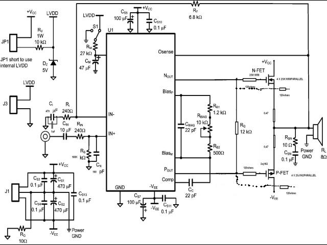

I work on LME49830 right now...
Hmmm...
I use 4 pairs of laterals but I can't go upper than 25mA with the basic aplication.
I tryed to go lower on the RQ12K....to 2,2k and the bias is 35mA....still not enough.
I tryed to go lower...100ohms (90mA) but LME became really hot...too hot and I use a large heatsink for him.
Also I moddify the Rb1,Rb2 and Rbias to upper values and also lower values but bias can't be change.
My needs is to bias each lateral with 150mA-200mA.
Any thoughts will be appreciated.

Can you post your schematic? What FETs are you using? 4 devices per side in the output stage?
-SL
-SL
It looks like you have the gate resistors to the other FET pairs in series? Is that a schematic error? The gate resistors should all connect to the same location so each gate resistor and FET is in parallel. On the board I have with LME49830 and these FETs (2 pair) I use about 700 ohms resistance between the bias pins. I have a 620 ohm resistor with a 200 ohm pot to adjust. Using supplied of +/-60V I set the current from each supply to about 250mA. For 2 pair this is about right to get stable bias across temperature. Start with much smaller value of resistors on the bias to start with low current and then increase from there. If the FETs are not matched be sure to use a source resistor of like 0.1ohm. You might also try starting with a higher value compensation capacitor like 30pF or 47pF to be sure you have stability then reduce down as possible for best SR.
-SL
-SL
Yes...I was in a rush.
My psu have +/-68V.I will try tomorow to change the bias values indicated and post the results.

# SpittinLLama
It works.I use 1k pot bias series with 500ohms for 500mA bias (for 4 pairs of laterals) in series with psu.It seems ok.
What value did you use for RF 6,8k?
Do you have some fiss on the speaker on maximum power without conecting the input to the music source?
Thanks.
Thanks.
Yes, I used the schematic pretty much on the datasheet, 6.8k for the feedback and input resistor. I don't think I had hiss on the speaker but I also didn't check with the input floating, always had it connected to a source even if the source was off. If you have a scope you might want to check to be sure there is no oscillation happening when the input is floating. I know the LM4702 will oscillate if the input is left floated but didn't check that on the LME49830. Thanks for reporting back that it is working. I'd be interested in any other observations such as sound quality, performance numbers, etc. It sounded good to me but I don't consider myself a great listener.
-SL
-SL
The sound is good.I compare with my tube triode monobloks and the LME49830 with laterals and enough bias will do the job right.I go up to 600mA for 4 pairs.The heatsink and the transformer is the limit😎 .
I choose 9k8 for Rf. and I have aprox. 306W/4 ohms and 236w/8 ohms and no signs of instability.My goal was to obtain a fast amp with high damping factor to drive the woofers into an open baffle(4ohms).
