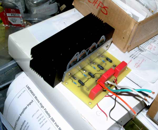

Do you mean "bypass" -- I have used several and don't really detect a difference in sound quality or objective test measures -- here's a current output board (no, I still haven't sent them out for production!!!): The board uses WIMA polypropylenes from the power supply rails to ground, and one across the power supply 470nF/400VDC
