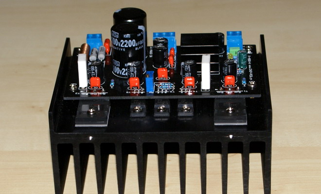

49810+BJT/MOSFET
Mono Design
Output stage: BJT J4215+J4315 or MOSFET K1530+J201

I think LME49830 can drive 4 pairs of laterals without any other "predriver".The 810 maybe not.
I'm thinking to replace the semi R bias with fixed resistor and also without TIP 31 ...considering laterals.
power amplifier of MOSFET with the input capacitance great, if parallel more devices, will add to the burden of LME49830.
I have tested the LME49830 driving two pairs of 2SK1530/2SJ201 and 2SK1058/2SJ162 directly or with an extra current gain stage. The only difference I could measure was less output power with the extra stage because of the loss of voltage to the gate at the FETs. High slew rate (35-40V/us) was possible with either design. I don't know what would happen if you go to 4 pairs but you can look at the differnt datasheets for for the above parts and compare gate capacitance to see what you might be able to figure. Or add the footprint for an extra stage to your PCB and either use it or jumper it to test. Easy enough to do.

I feel that the LME49810 with 2SK1530/2SJ201 (assuming good layout bypassed electrolytics, no caps on the signal path and my "trick": placing a snubber on each power transistor's drain) is one of the most detailed amplifiers i've ever heard. With IRFP ones it's more warm in a way that reminds me slightly of the new ipod's retail earbuds. I don't know how it compares to anything expensive since i really prefer to invest the time needed to earn the money that these cost in building mine! But being such a wide range of available driver ic's nowadays it would be nice to read sonic feedback from builders before deciding the way to go.

ionomolo, what values do you use for the subber from the drain on each FET? Is that drain to GND? In the big BJT vs MOSFET thread that Bob Cordell started he talked about a snubber from gate to drain and one from gate to GND like his paper showed. I am just curious if I can increase stability with such additions so I can reduce the Comp cap further to get higher SR.

I only use drain to gnd with 0.1uF + 2R2. I also use gate to source clamping at much less than breakdown voltage to get short-circuit current limiting. I don't feel the need for additional snubber since it's stable at 50V/usec slew rate and probably slightly more.
I've never had any stability issues with simple mosfet output stages, only with mosfet-Sziklai ones.
Thanks for the info. I don't have much oscillation problems but using the LME49830 I can only get a slew rate of 40V/us. I can't reduce the compensation capacitor value lower to increase SR without some oscillation. Stability is pretty good with the layout and 0.1uF caps on the supply line right at the drain. The next board I do I will have to add the option for these snubbers to test. One more ?, for gate clamping do you just use something simple like a couple Zeners?
-SL
Yes, it's important to choose proper voltage so current limiting won't be set at a too low value taking care of temperature variation. This also introduces a self-limiting effect that translates into less output current when temperature increases (Assuming negative tempco at the current limit).
What i've found to be the most critical part regarding stability is the gate stopper resistor. I always place it attached to the transistor's gate and sold the mosfet with it's legs as short as possible. This makes heatsinking more difficult but provides more stability.
