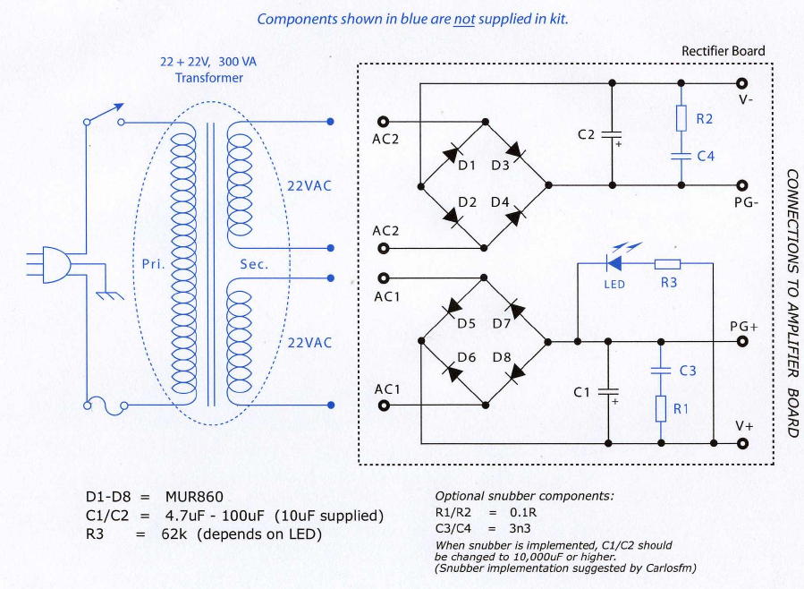

Got my simple bulb tester... negative and earth into block connector and live into bulb and out othr side of bulb.
Rewired transformer to amp and powered up... Light didnt light up or flicker at all. However when I put probes onto AC side the bulb is lighting up.
MMMmm I'm getting a bit !$*@%&$ angry now. Think I might call it a day and try again tomoro. Only upto rectifier, got the amps to go though yet.

You checked the diodes and they seem to measure fine, I checked your pics and they are installed properly.
Forget about the bulb, it's good for testing complete amp, but you don't need it here yet.
See attached pic, this is how PS should be wired:
You have two sets of secondaries on the transformer, colors don't mean anything to us without manufacturer's diagram. Identify secondary pairs by measure AC voltages; connect one set to pads marked AC2-AC2, the other set to AC1-AC1 (the orientation of wires is not critical as long as two pairs are sorted out properly)
Now measure voltages between V- and PG- and between V+ and PG+, it should be approx 2x 34V DC. If LED doesn't light up, it may be installed incorrectly and you need to reverse it.
All those measurements should be done without PS connected to the amp boards.

Sweet just tried lefthand side amplifier and I'm getting 29.3v DC at the board... More impotantly No flashing lights or frazzling sounds.
On with testing righthand side and see if I'm as lucky. If so I will solder the rest together n break out the CD player and test outputs.

if you are getting a spark trying to measure between -V and -PG, something is wrong. The bulb is lighting up because lots of current is being drawn - your multimeter will not do this!
The multi meter will do this if it is set to mesure current . It was mentioned earlier in the thread about sparks when taking a mesurement.
