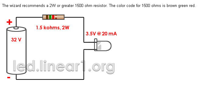

This is the LED i intend to use on rectifier board... I have a nice Optic fibre kit that will let me put a blue power light on the front panel.
Can anybody help with what resistor it will need. Transformer is 300VA 2x22v. Dont wanna solder one in to have it blow on me.

So im doing 22v, 3.3v and 30mA.. or do I add the 2x22v and use 44v as voltage... I know i'm a pain, it'll all be over soon.
Transformer is rated in AC volts, after rectification you can expect approx 32V DC per rail and that's what you use for calculations. This is what you get:
If you find diode too bright, you can further increase resistance (and that's what I always do). I'm using 64k resistor with a small Panasonic red LED.

Powered up transformer and tested output. Getting 24.5 volts from each. I was expecting a hum from it, but its silent. More importantly the fuse didnt go pop.
So far so good. Now I gotta order a 2w 1.5k resistor to do the LED as I have only got 1/4w and I'm guessing that wont be powerful enough.
