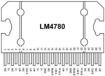

This is my transformer wiring diagram...
Technical notes: : Technical Information
I have got Red to AC1 nearest edge of board, Black AC1 Inner hole, Yellow AC2 Inner hole and Orange AC2 Edge of board.
Is this the right way?

Got my simple bulb tester... negative and earth into block connector and live into bulb and out othr side of bulb.
Rewired transformer to amp and powered up... Light didnt light up or flicker at all. However when I put probes onto AC side the bulb is lighting up.

The bulb should not light, or light only dimly... you may get a flash when everything is connected up and the capacitors charge. If the bulb lights up brightly and stays lit, it means something is trying to draw a lot of current, and the bulb takes the power instead. The beauty of it is that the bulb absorbs the power instead of whatever is shorted, saving the parts.
You were testing the diodes correctly - they should only conduct one way. It seems like they are OK.
The transformer wiring now sounds correct.
Start with a 60W bulb.

Only managed to find a 40W bulb... Power up is fine, no light, bangs or flashes.
I set my multimeter to DC, place red probe on V+ and black probe on PG+... I get a spark which freaks me out to start with... Then bulb starts to glow. Should I leave probes on for a time to see if bulb fades or do I carry on freaking and jumping back 3 feet.

transformer is ok, so its either the wires going into rectifier thats wrong or I've done something during rectifier build thats not right. I have looked though a magnifying glass and cant see any solder that is shorting anywhere. everything is in right place and the right way round.

You checked the diodes and they seem to measure fine, I checked your pics and they are installed properly.
Forget about the bulb, it's good for testing complete amp, but you don't need it here yet.
See attached pic, this is how PS should be wired:
You have two sets of secondaries on the transformer, colors don't mean anything to us without manufacturer's diagram. Identify secondary pairs by measure AC voltages; connect one set to pads marked AC2-AC2, the other set to AC1-AC1 (the orientation of wires is not critical as long as two pairs are sorted out properly)
Now measure voltages between V- and PG- and between V+ and PG+, it should be approx 2x 34V DC. If LED doesn't light up, it may be installed incorrectly and you need to reverse it.
All those measurements should be done without PS connected to the amp boards.

the purpose of the bulb tester is to prevent damage if any of the wiring is wrong and causes excessive power demand.
It is best used right from the start rather at the end of the building sequence.

if you are getting a spark trying to measure between -V and -PG, something is wrong. The bulb is lighting up because lots of current is being drawn - your multimeter will not do this!
Sweet just tried lefthand side amplifier and I'm getting 29.3v DC at the board... More impotantly No flashing lights or frazzling sounds.

Woo hoo... working all the way to speakers..... I'm a happy man!

The multi meter will do this if it is set to mesure current . It was mentioned earlier in the thread about sparks when taking a mesurement.
