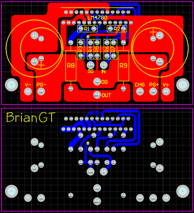

Here is my version that I started on last night based on Peter's sketch, and the National layout. I haven't finished it yet.
Any comments?
(besides the current lack of heat relief traces)
I will probably make the board 0.05-0.1" deeper, and pull the input pads down, allowing for the creation of a wider gnd trace between the input pads and the output pad.

Looks great, Brian. I agree about pushing back the pads for 16 and 18 for a little more room in there. Would putting the wiring connection pads at a 5mm spacing to support terminal blocks be worth while? Triple for input, doubles for the power, and single for the out and ground (poss a triple to include the chassis ground and +power). They look clean and make any component experimentation much easier. Per uses them often and the pics of his designs look very professional with them. I won't comment on any sonic impact they would make, but people could have a choice.
Philo said:Looks great, Brian. I agree about pushing back the pads for 16 and 18 for a little more room in there. Would putting the wiring connection pads at a 5mm spacing to support terminal blocks be worth while? Triple for input, doubles for the power, and single for the out and ground (poss a triple to include the chassis ground and +power). They look clean and make any component experimentation much easier. Per uses them often and the pics of his designs look very professional with them. I won't comment on any sonic impact they would make, but people could have a choice.
The spacing of the pads is 200mil, which is roughly equivilant to 5mm, allowing you to use terminal blocks. You will find that some people used terminal blocks for my LM3875 boards, such as shown here:

Not to be critical of the good work, but there are 2 amps on this chip, shouldn't there be spots for 4 caps?

National is using only 2 caps on their evaluation board.

Brian,good protel design.I like the traces to be routed smooth🙂

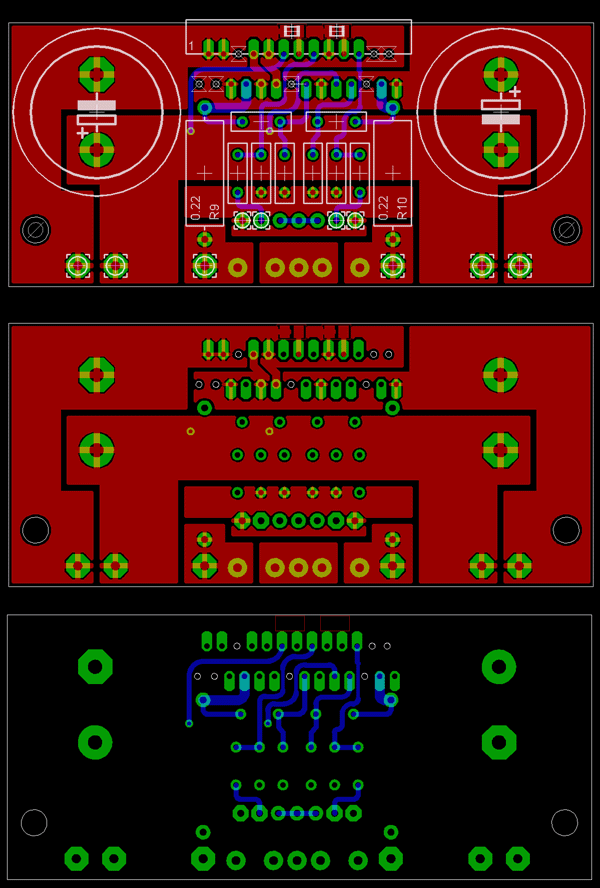

Hi all, I've been working on a similar project with the LM4780 in parrallel for months (being a student isn't all that great for all those side projects of mine, it is nearly a shame that it took me month to do what you accomplished in hours) After a few tests I found that this chip likes to be bypassed by a second set of smaller caps. I used 1.0uF BC Metallized Polyester caps and so far these are the best. I used Panasonic FC 1000uF in conjonction with the BC with good results. My board also had provision for an additional 10uF cap but I never used these and did not find the need to do so.
Now that I read the tread properly I think it might be because of my sub par layout but hey adding a little place for these is not excessively hard and they can almost already fit on Brian's board.
These are the images I used to make my prototypes. I don't have a good CAD software so excuse the roughness of the layout.
Note that the top image is mirrored because I'm using the toner transfer method to do my pcbs.
Now, if the group buy really takes on for this one, I'd probably get a dozen because my prototypes sure are sounding good and a professional board inside would offer even more eye candy in a nice plexi clear casing 🙂
Sébastien
Edit: I forgot to mention that my final board size is a tiny (but packed) 2.375" x 1.750". My power supply is a 400VA 25V+25V toroid with a regular 25A 600V bridge and 9400uF per rail.

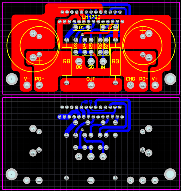

Here is an image of my revised layout, making it a bit deeper (0.05" deeper), and moving the output GND pad down more. I positioned the input terminals closer to the middle to keep the GND trace as thick as possible.
Any comments?
(ignore the dots in the the planes, as they are solid, but display differently in the screenshots. I also haven't added heat traces yet)

Just a question won't PG+ and PG- create ground loops if you connect them both?
And like I mentioned previously, in parrallel mode, this chip would become unstable without a very closely located film capacitor, I don't know if it would do it with this layout, but it would be simple to add the pads just in case.

The 2 PG inputs are from the power supply board, which uses dual bridge rectifiers (8xMUR860), so there the ground reference for the bridges are obtained on the actual amplifier pcb, not creating a ground loop. The CGND goes to the central ground.

I've built it without caps and it's more stable than LM3875.
To me the board is too wide (on a smaller side).

Leaving a place for a couple film caps as a bypass wouldn't be a bad idea. You can always point-to-point wire them in but if you leave a couple extra pads across the 1000uF caps people can experiment with different bypassing options. The National Tech notes have a 1000uF electrolytic bypassed by a 10uF MKP & then a 0.1uF ceramic. I'm not so sure I'd use the ceramic but maybe a silver mica which is good at high frequency would be something worth giving a try.

I never liked bypassing. The only bypass that worked were 4.7u BG N caps on rectifier board. It wasn't that much for stability issues as for better sonics.
If no space for small caps on this board, one can alway attach any caps in parallel with big electrolytics underside. I believe that placing them in a usual space on board, will compromise optimum layout.
