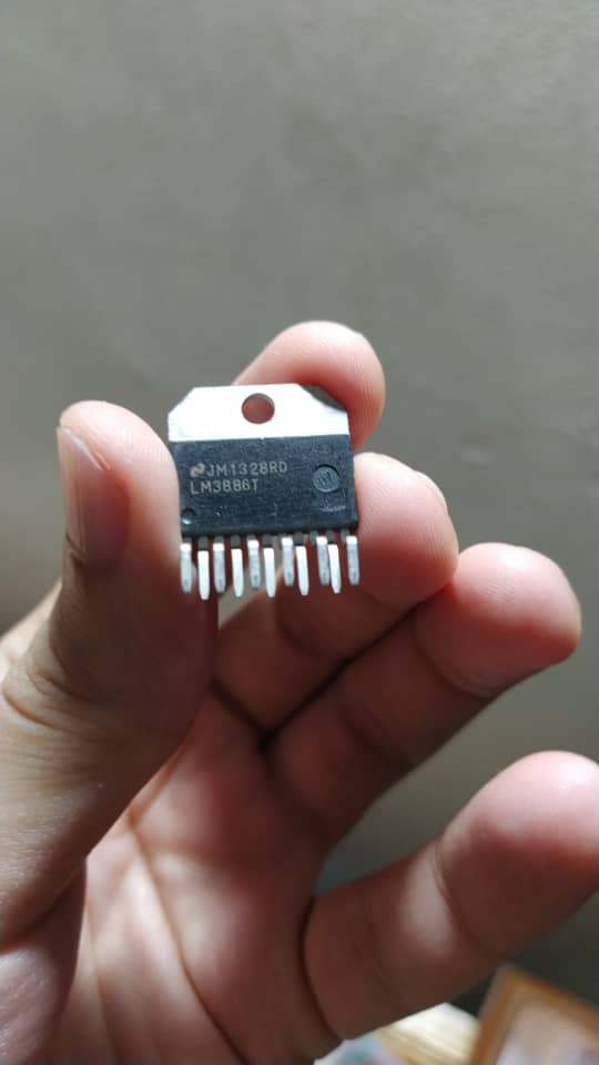

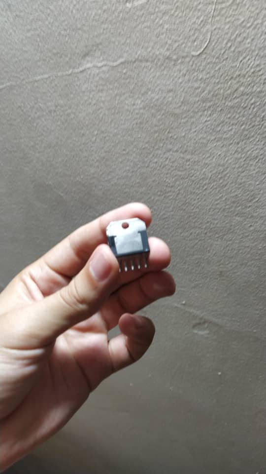

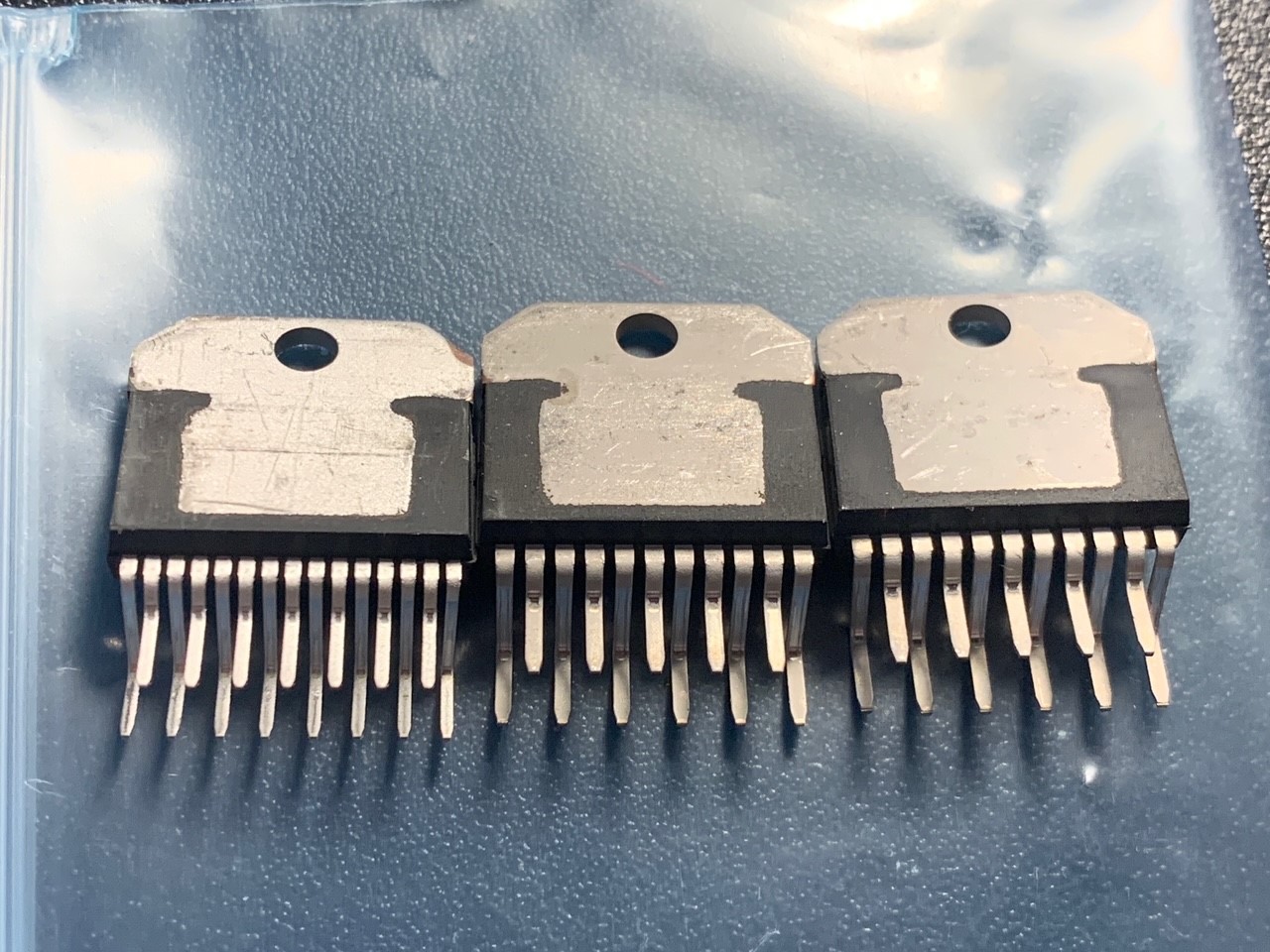

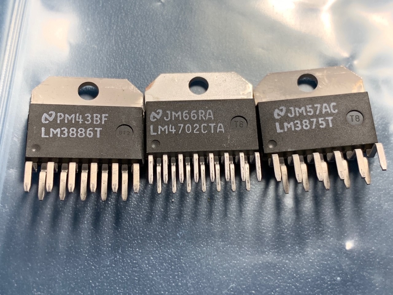

I texted the seller and they sent me these pictures, the IC looks better than the ones they have on their shop and I think they look identical to the original... what do you guys think?

I think they are not lm3886, the writing looks funny , it might be National/TI part, but not lm3886.

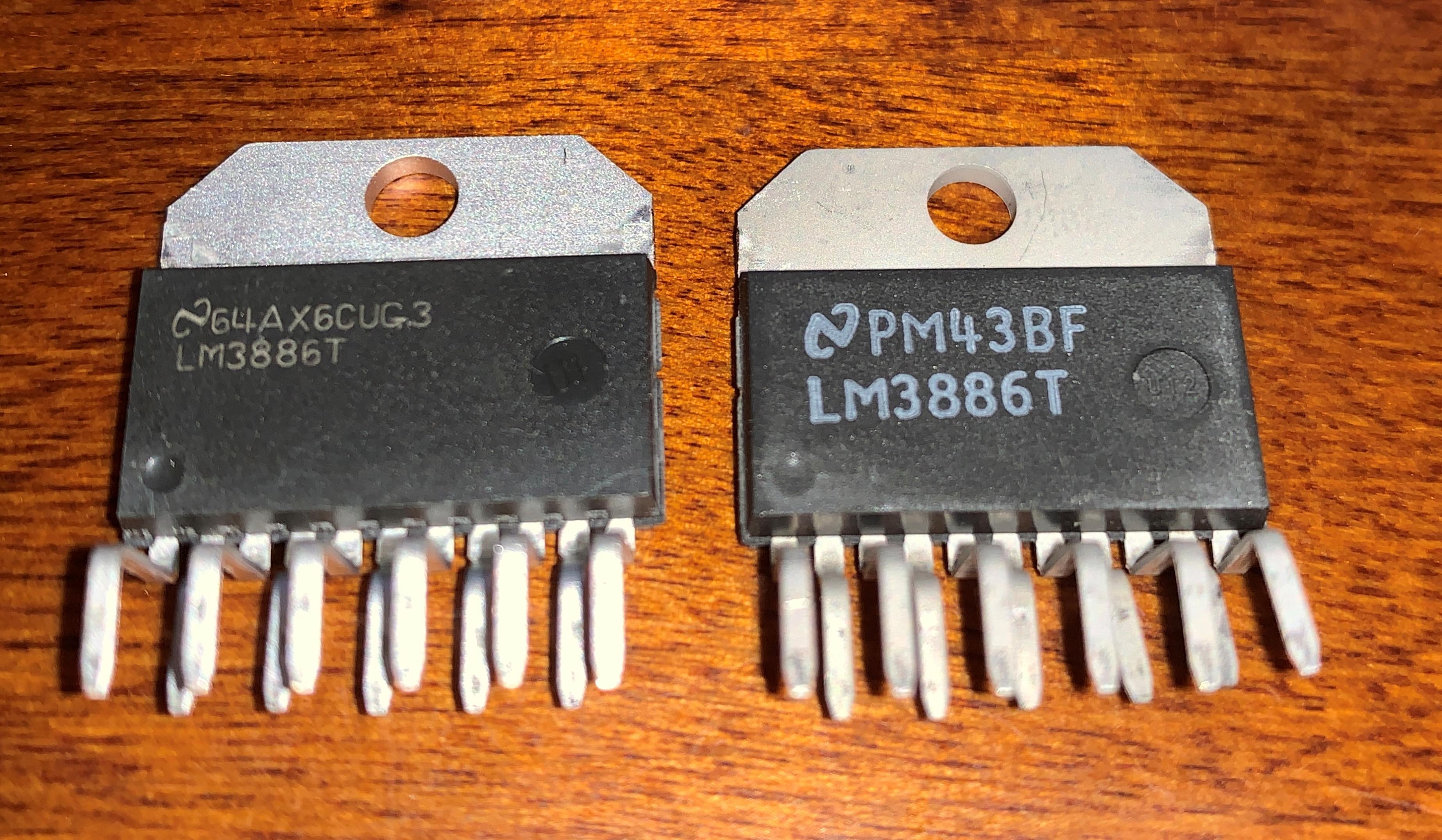

The one on the left at least is Laser engraved and *looks* professionally made, the one at right has TERRIBLE silkscreening, I can print much better on my kitchen table with one hand tied to my back.
Even worse: fully enlarging the image I can see the *thin* sharp outline of each letter, surrounded by a flood of white ink.
As a silkscreener: they had a well made original artwork, proper line thickness, etc, then inexperienced/cheap/in a hurry operator had a problem with ink drying up and clogging screen pores (a very common problem) so he added ink solvent ... way too much of it, so too liquid ink spreads too much around.
If silkscreening is that sloppy, imagine what they fit inside 😎
Most probably you can wipe that white ink out with a ball of cotton wetted in acetone.
We can´t add anything new to what is already written, just take the plunge and buy the U$13 one, I suggested a somewhat safe way to test it.

May be authentic, still stand by my very poor silkscreening comments 🙂
Since everybody and his brother went to laser engraving years ago, only way I would expect a silkscreened part from a major manufacturer is from very very old NOS.
Out of curiosity just checked a few old parts drawers: silkscreened ones showed dates from ´74 to ´97, one had a single digit code starting with 7 , might be ´97 or even 2007, all others were laser burnt.

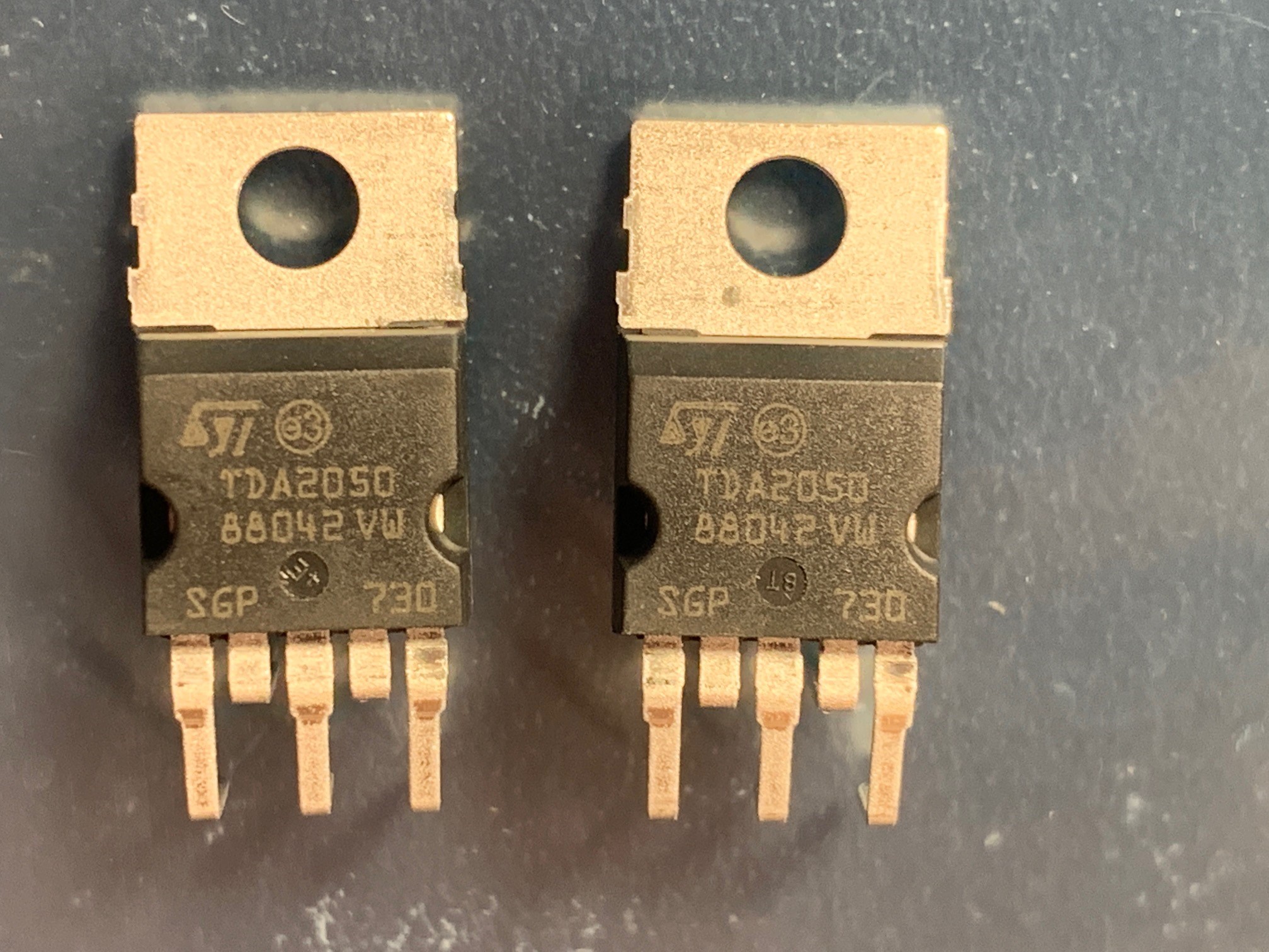

I would be very skeptical that there IS any NOS 3886 or TDA2050 left on the planet. The last of the original runs would be long gone and only recent manufacture 3886 would be available at all. If you’re looking for TDA2003 (and sometimes even 2030) you can still find them because nobody uses them anymore, and predecessors of the 3886 seem to be more available. NOS on all the predecessor types may still be around after the 3886 evaporates entirely.
If they do decide to EOL them it will be a mess - like the mad scramble to get the last 2N6609’s and Sanken MT200’s were. Maybe not enough industry demand anymore, but a lot of angry users left holding the bag.
Thanks everyone for your help, Ive decided to buy the LM3886 from this seller and just hope for the best. I initially asked because the IC in their pictures looked suspicious but now I know that the pictures are taken online and their actual units look more decent i'll take the risk.
