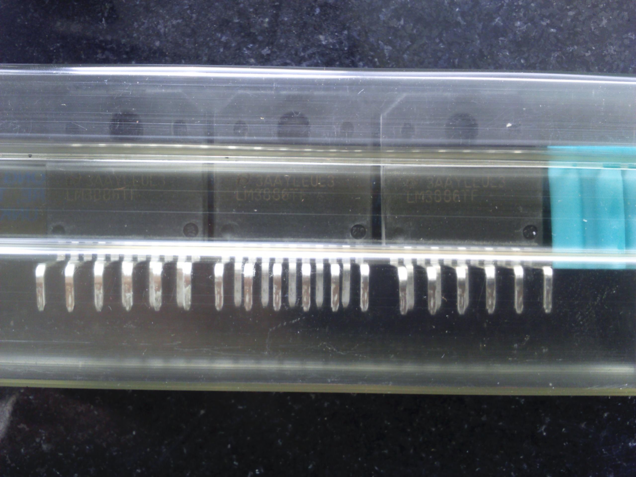

LM3886T - Original or Bootleg?
Sorry, I live in Venezuela
Can you please post the clickable links to vendors you mention in Venezuela?
Maybe that gives us an idea about how "serious" they are.
Text in the picture you posted has horrible Spanish grammar, clearly google translated and copypasted without the slightest editing, that alone hints at "no clue" seller, which is not exactly encouraging.
Can´t you straight order from Mouser?
Maybe postage is relatively expensive for "just one" since there will be a minimum charge even if you order a 10 cent resistor, but you might order a few othyer things you need, or even join needs with a friend or two, so you split Mail cost among a few.
That said, Customs typically allows "3 units of anything" tops, so you can order up to 3 x LM3886, 3 of anything else in the same order.
OR:
Plan B: order just one in Venezuela to minimize possible losses and test it.
Which means building 1 amp, applying +/-V rails, loading it with proper speaker (4 or 8 ohm) and driving it to *just* clipping.
Does it put out expected power?
Does it crack/explode/catch fire?
First with a resistive load, then with a real speaker: does it oscillate, clip weird, etc?
Real world testing.
IF good, order more; if bad try the other vendor, if both bad don´t waste time with EBay or AliBaba, go straight to Mouser, whatever it takes.

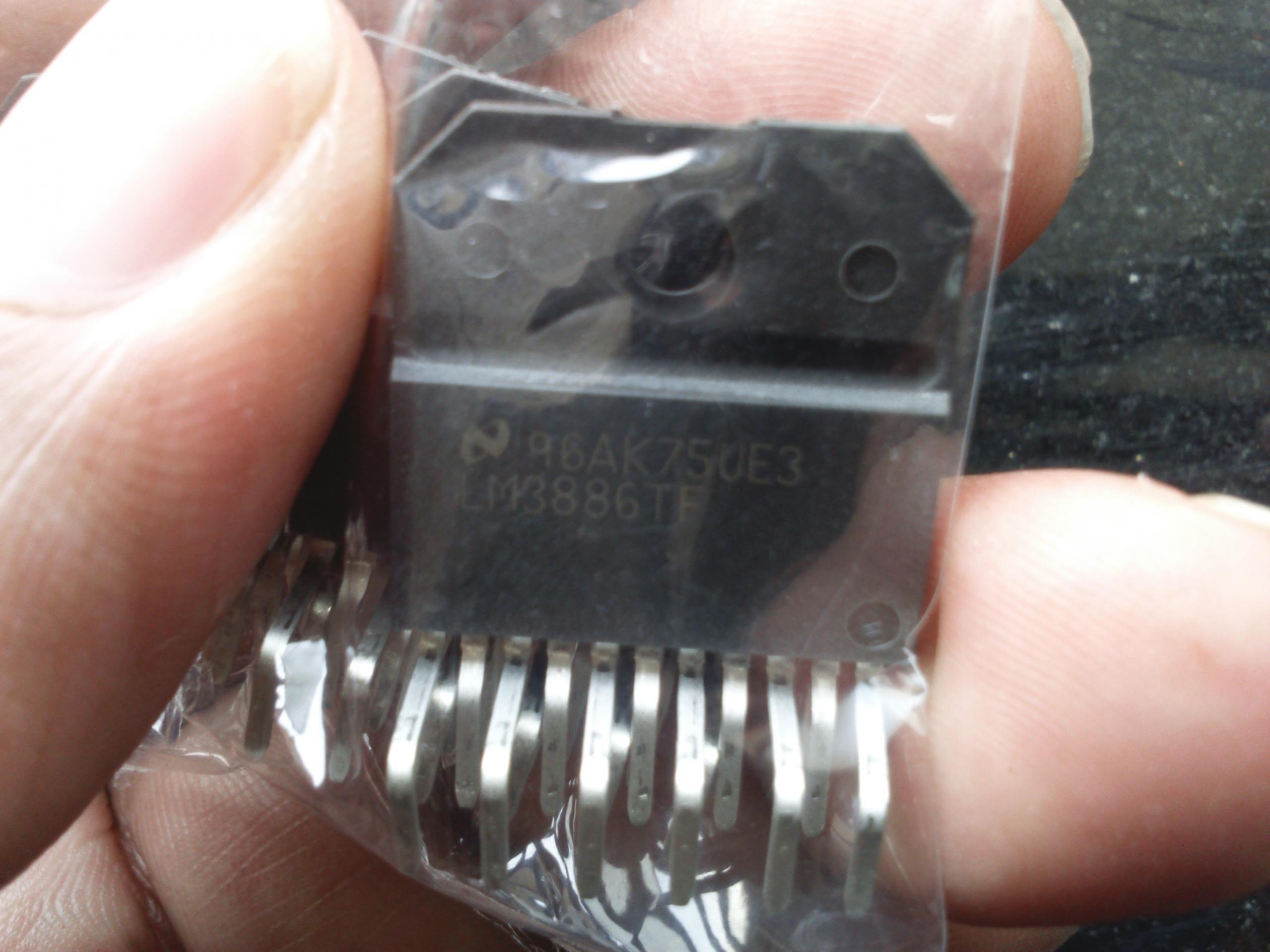

This is the link where I got the pictures from:
https://articulo.mercadolibre.com.v...cking_id=dcbe6cec-8785-46cf-9d3d-4ecc88c4bdfe
And this is the other one I mentioned: https://articulo.mercadolibre.com.v...cking_id=44db2829-5344-4203-9d13-f9b2094749df
These two are the only local online stores that sell it and accept Paypal, I would still need to check phisical stores to see what they got but I doubt they accept Paypal (Also Mouser seems to be out of stock)

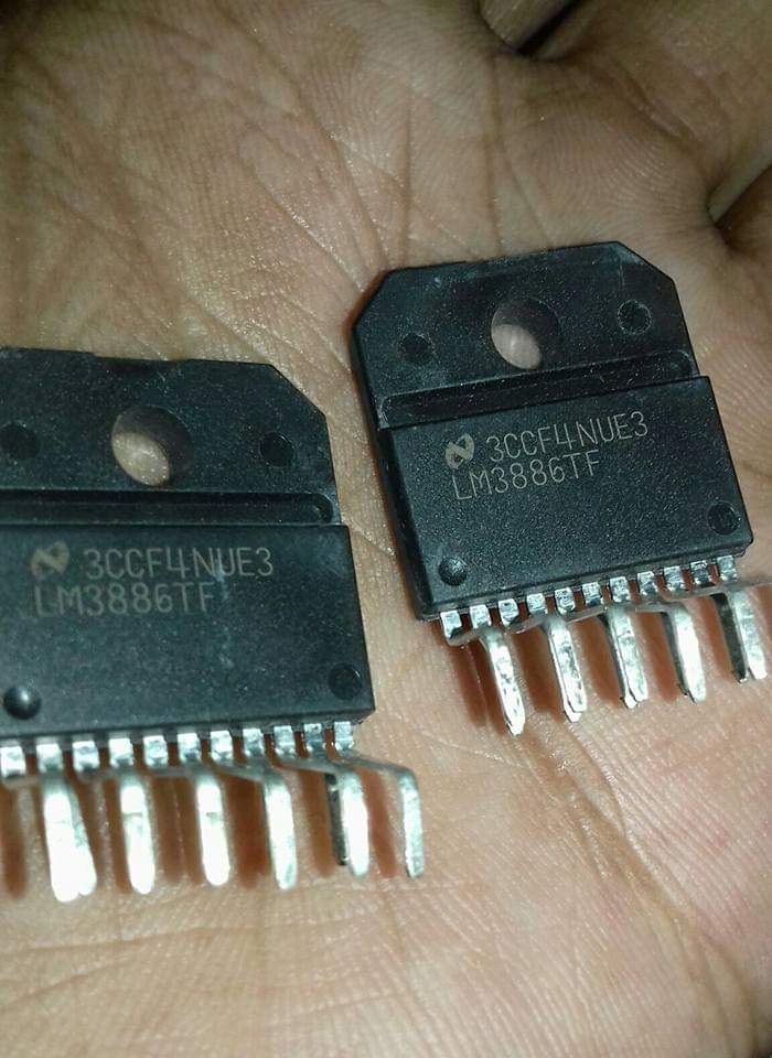

Genuine LM3886TF
All overture series ic's has Natsemi logo despite TI acquisition. Just buy from reputed source. I didn't purchase from international vendor like mouser, rs, farnell etc but from a local supplier and with very minimal price 😉

1) when quoting please edit message as I am doing now, no need to repeat it IN FULL when it´s just above, only leave *one* text line to identify it.
2) Mercado Libre sellers can be offering *anything*, but both have 100% good feedback/reputation, so they "should" be honest.
I would buy fom either of them , if anything the second (U$13) looks better: 11 years selling, >6000 completed sales, apparently ral pictre (the other one uses generic ones).
Buy *one* and try it, you are not risking much, in any case you have no other option.
Build it *carefully*, use a series lamp bulb limiter as protection, to avoid assembly errors and never knowing whose responsibility it is.
Or at least use a 100 ohm resistor in series with each +/-V rail from power supply, no speaker load, worst case they willact like current limiters and improvised cheap fuses.
IF all voltages look normal, specially 0Vdc at speaker out, replace them by 10 ohm resistors, connect speaker, and play it very low (a few milliwatts, earphone volume).
If all fine,connect amp straight to supply and test how it sounds.
Well, same here.. from Bangalore local market (SP Road). Unfortunately, even I got them just like that (no anti-ESD), what to do, good luck to myself! Maybe they'll work.
Looks authentic, i'm sure will work fine. I bought total eight chip for a big stereo amp(yet to finish) & later two more for one my friends. Sounds fantastic and inbuilt SPIKE protection works ruthlessly when needed!

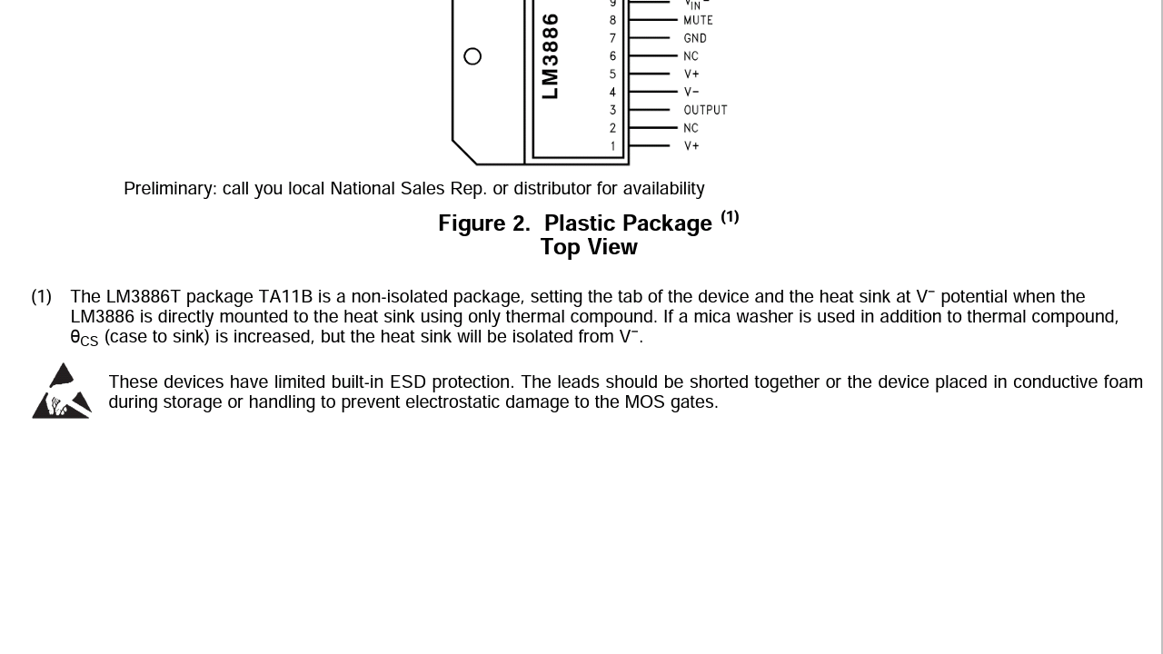

Don't think too much about esd blah blah blah...
nirupambhowmick said:
Don't think too much about esd...Looks authentic...
Not at all my friend, quite unfortunately, charge accumulation on insulators (including fingertips) and the damage that can result are both very true. It's best not to buy anything expensive (memory etc.) if it comes without the anti-ESD packing.
Coming to authenticity, I also happen to have a few engineering samples from National lying around somewhere that I could compare these to, when I find them.
EDIT: Found them, they look the same..

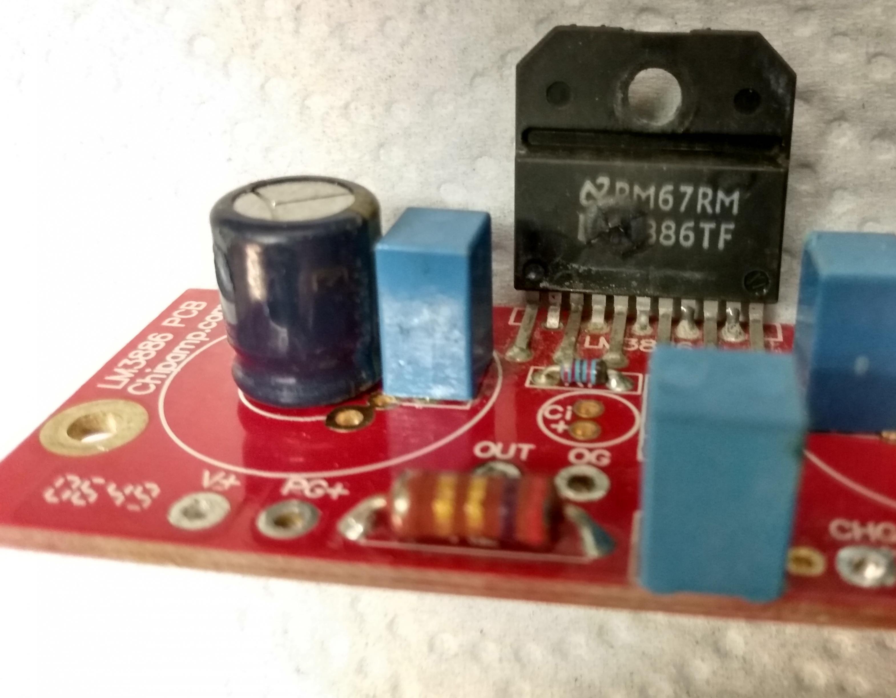

This is my Fake LM3886
Hey guys, ive found a seller in my country that has LM3886T chip amps for sale but... im not really sure if these are original or chinese copies. To my understanding National Semiconductor doesn't exist anymore so any new unit of these should be TI branded, right?
When this chip failed it ran 20 plus volts DC through my speaker, it ruined three voice coils.
When I rebuilt the Amp I added Tom's Guardian 686, and all Mouser parts.
