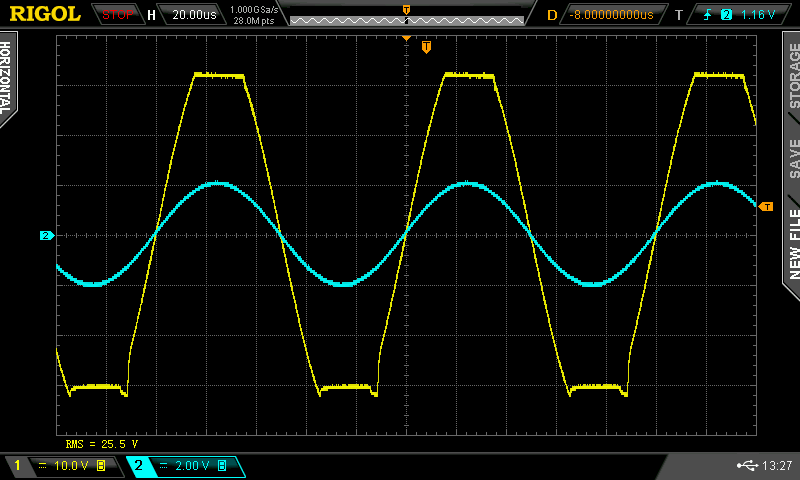

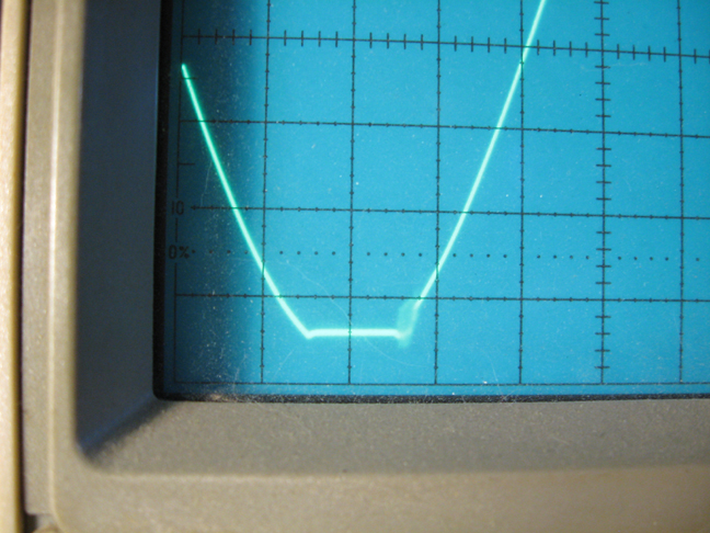

Strip off all the "optional stability components" (Rf2, Cf, Cc). Load the amp with an 8 ohm power resistor. Now run a sine wave into the amp. Crank up the amplitude until the amp starts to clip. You will notice a spurious oscillation near the peaks of the sine wave. I'm guessing it's a saturation clamp inside the LM3886 that oscillates. That's mentioned in the data sheet. National used the term "quasi-oscillation".
I would think, that it does not oscillate but only resonate. Cc reduces gain that much, that there is not much input at resonance frequency. Elsewhere you gave the impression, that, without Cc installed, clipping behaviour was that bad, that the amplifier could possibly not recover. How that? I figure, one should simply not feed the chip slew rates in xcess of 356KV/s (1.4V*2*Pi*40KHz). To that goal, equip input with 2KR2 series, two red LEDs anti-parallel and 1nF8 parallel. I mean, an amplifier is not a wire hence must not be treated as such. It needs bandwidth limiting at its input. People who want to listen to ultrasonics will surely have more sophisticated tools than LM3886s.

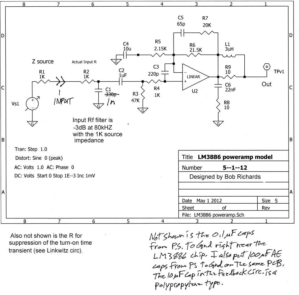

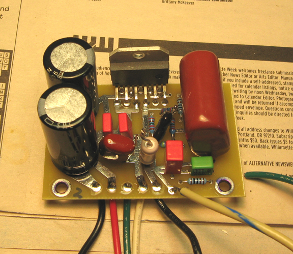

In my 3886 amp project I did a bunch of research, looking at how others did the compensation, looking at the data sheet from TI, modeled what I thought would be best in SPICE, laid out PCBs such that lead lengths and part proximities would be theoretically optimal, built it, and tested it.
What worked in theory, as usual, didn't quite measure up in practice. There was oscillation at the negative rail with a sine wave, when driven just slightly into clipping. I played around with several part variations until I got the oscillation pretty much gone. Much to my surprise putting a 220p cap across the inputs of the chip actually helped. I'd never done that before, and hadn't intended to use that cap.
My point here is that the parts layout, lead lengths, PCB traces and grounding issues all seem to affect the phase margin substantially, and any high feedback amp should be looked at very closely on the bench to see what actually works best. Theory gives you maybe a good default starting point, but then you want to mess with it until it actually works really well.
The attached circuit might be what I ended up with. I'm not absolutely sure I updated the schematic after the final tweaks, but I think this is close. The best comp part values may well be different for a different PCB layout, or other variables. Simply copying what someone else did may not be optimal. The picture showing the negative rail oscillation is before the final tweaks.

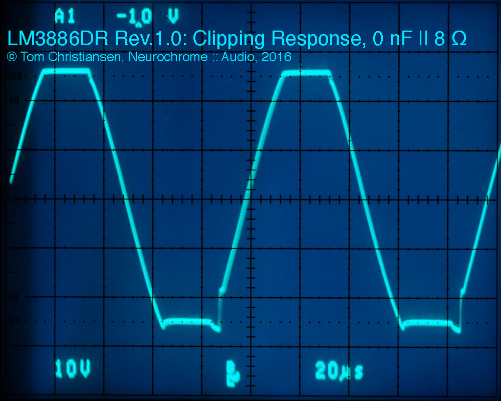

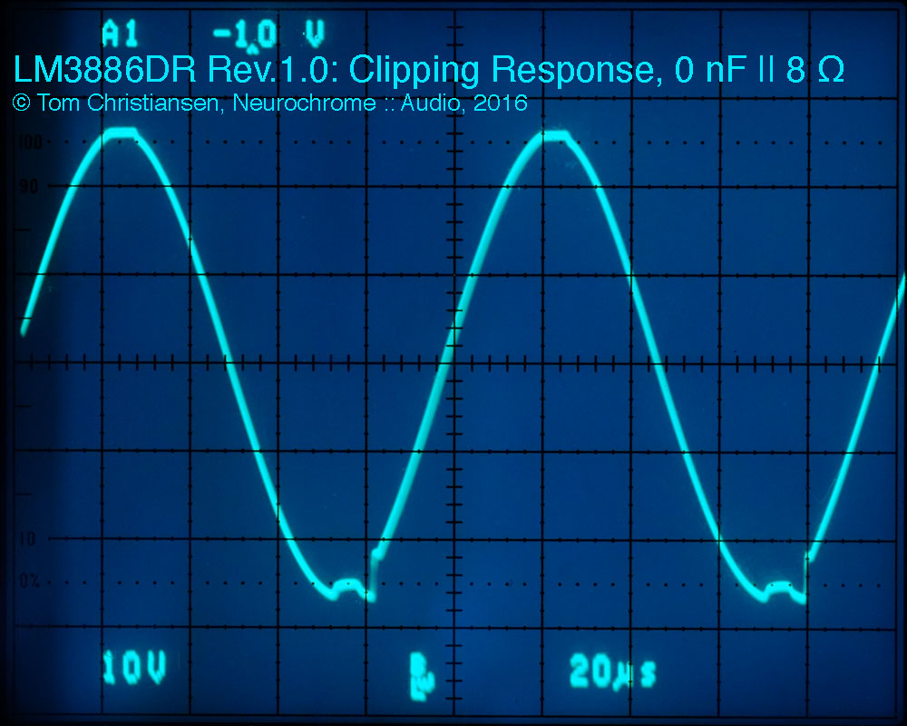

It is quite common BJT amps oscillate a little bit on the edge of clipping. At that point Ft of the output BJT's droops heavily, changing phase margin a lot. Also parts of the amp go into saturation etc. and there is no defined loop behaviour any more. The LM3886 is no exception.
Yep. Devices enter saturation and the loop gain drops like a rock. This causes instability until the devices are brought out of saturation.

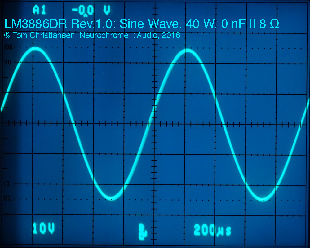

That said, the LM3886 doesn't have to do that. It can be made to not have that little buzz as it recovers from clipping if you follow the directions regarding the Zobel/snubber, Thiele, and decoupling networks given in the application section of the data sheet.
Attached images are from my LM3886DR. You still see the rail-sticking caused by saturation. The devices recover cleanly from saturation.
Tom
Tom
