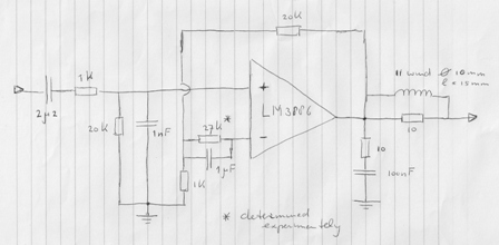

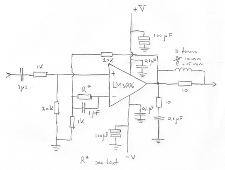

LM3886: the effect of the compensation network Cc, Rf2 and Cf
The output zobel (typically roughly a 10 ohm R in series with a .1uF cap across the output terminals) helps make the phase margin of the amp more predictable, by effectively reducing the high frequency reactance of the speaker, so the amp may be less likely to spuriously oscillate. But an additional feature is that it shorts out any Rf picked up by the speaker cables acting as an antenna (which allegedly can happen), the energy of which would be delivered to the negative feedback input of the power amp circuit, if the damping factor of the output stage is weakened enough by the rolling off open loop gain. This can allegedly be a significant issue, especially with tube amps that often have significant output impedances at the higher frequencies (roughly 1 - 4 ohms, especially when negative feedback is low).

..........But an additional feature is that it shorts out any Rf picked up by the speaker cables acting as an antenna (which allegedly can happen), the energy of which would be delivered to the negative feedback input of the power amp circuit, if the damping factor of the output stage is weakened enough by the rolling off open loop gain. This can allegedly be a significant issue, especially with tube amps that often have significant output impedances at the higher frequencies (roughly 1 - 4 ohms, especially when negative feedback is low).
Do you think so? At HF you end up simply with the 10 ohms in parallel with the inductor and the 10 ohms in series with the cap. It gives just 6 dB att. I must admit a Z of 20 ohms is quite low compared to the antenna impedance of a speaker cable. But not that low, so keeping out HF? I don't think so. But for unconditional stability a CR + RL is a must.
