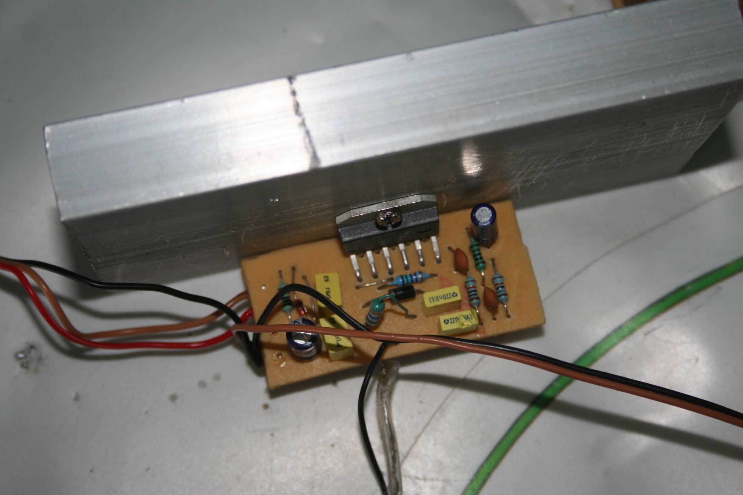

Tried the circuit . I am happy with the result , though i find that the volume level is not good enough . Dosent sound like a 60w amp . Does the circuit need a pre amp ? I connected it directly to a mobile headphone out . sounds like a 5 watt amplifier
Try it with another source, it should be louder then that.
Maybe you got a fake chip. Where did you buy it?

Increase feedback resistor 15k to 33k for increase gain.
I wanted to try out the amp .. so i had to use anything that was avaliable and it was my phone .
Yes , i did increase the gain by increasing the resistor value , but it i feel the sound is not as good as it is when using the 15k resistor . Still testing though since i made 4 modules for bridging into stereo . Will update as soon as it is done .

Here is my amp .. 4 modules done and working .. Now , in a fix as to how to bridge the amp . Do i use an external bridge circuit ?
