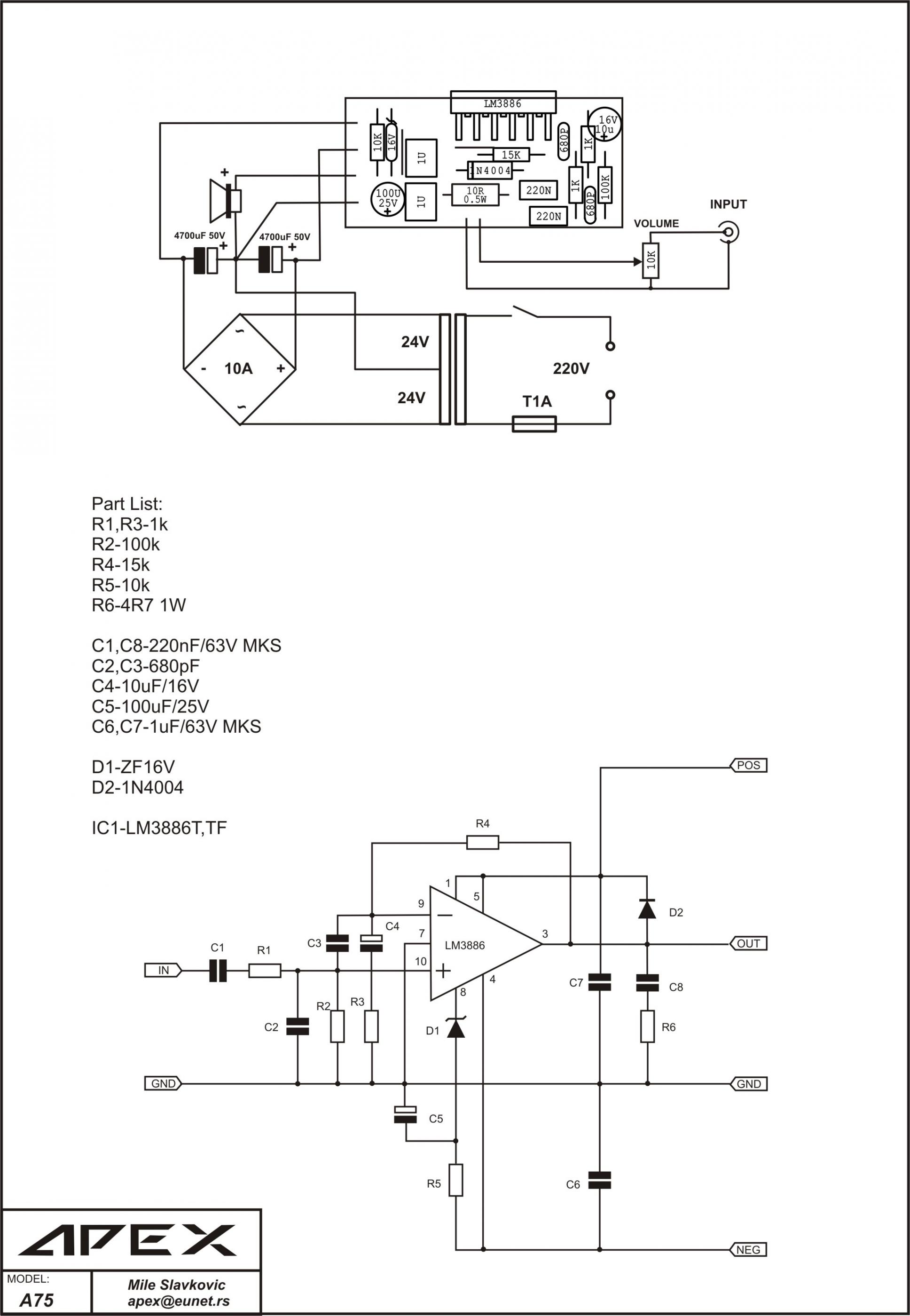

I have tried these parts doesn't work for me:
D1 1N4007
D2 ZFC15v
for caps 220nf I have 270nf/100v
for caps 1uf I have WMA/100v
and consider LM chip in your picture also I have one without metal back just IC in black
anyway at your diagram in post 1 you put D1 to the right at your picture you put it to the left opposite side, and the resistor are different.
my question is what I could replace for parts cause not all available here, and does diode here effect the general diagram or just for protection as you post?
as I can notice the data sheet for LM have also different parts,and I'm really confused.

This is correct schematic and layout,
Regards
The file is not legible. Could you post it a bit larger please?

Any chance there is a DWG file available for the PCB and PSU (comp and solder sides)? I have access to a benchtop CNC and would like to try to mill a PCB.
Anyone have experience with that? Words of warning?
