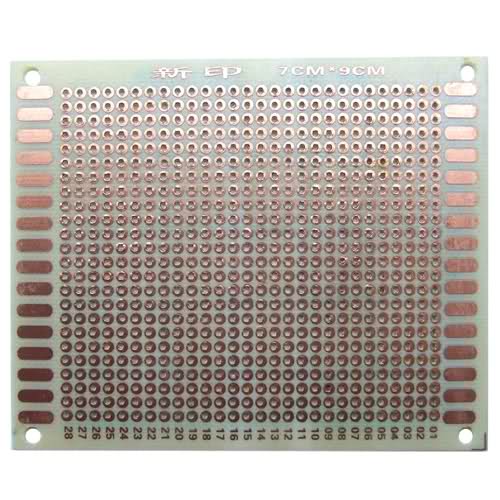

I'm going to use this (1st pic)
and these (second pic)
Then this guy (third pic)
To make this (4th pic) 😕
Then I'm all like: Oh yeah?!
