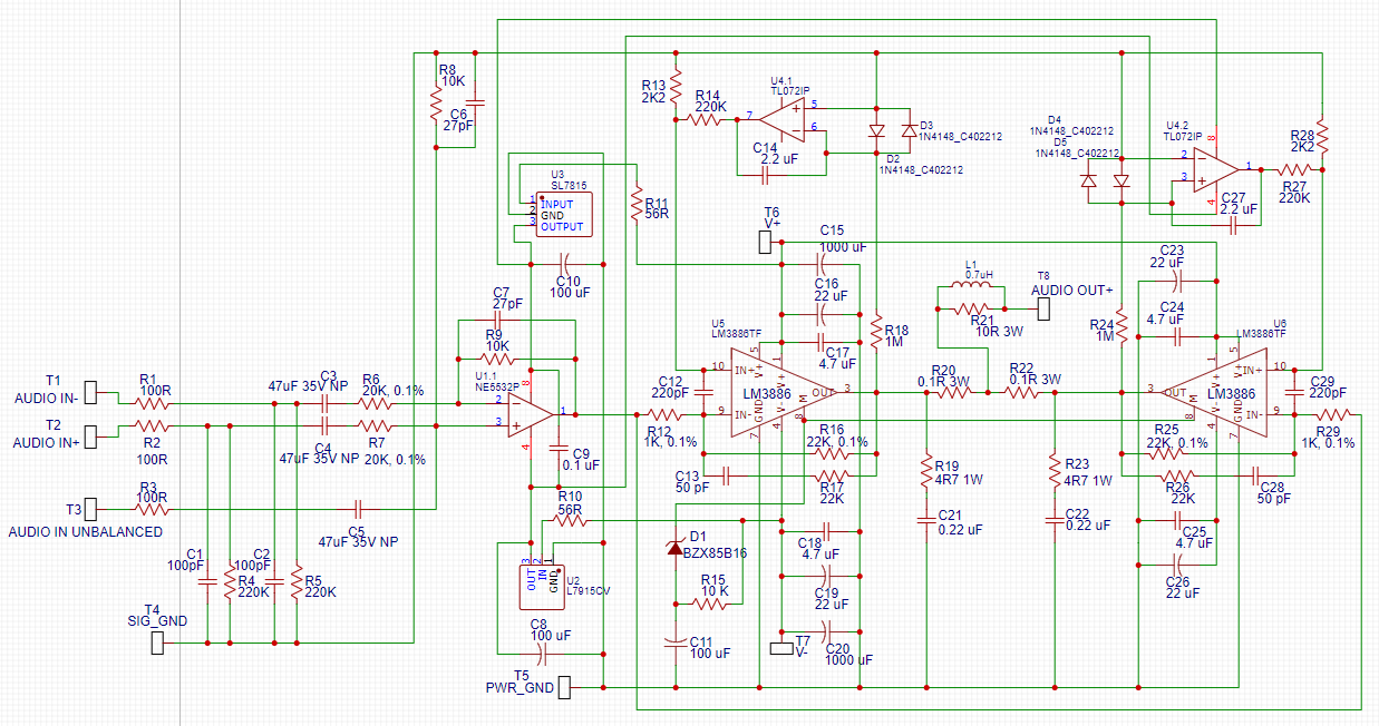

LM3886 in parallel with servo circuit build attempt
Fixed minor mistakes - see attached

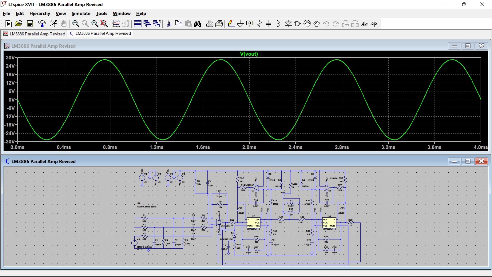

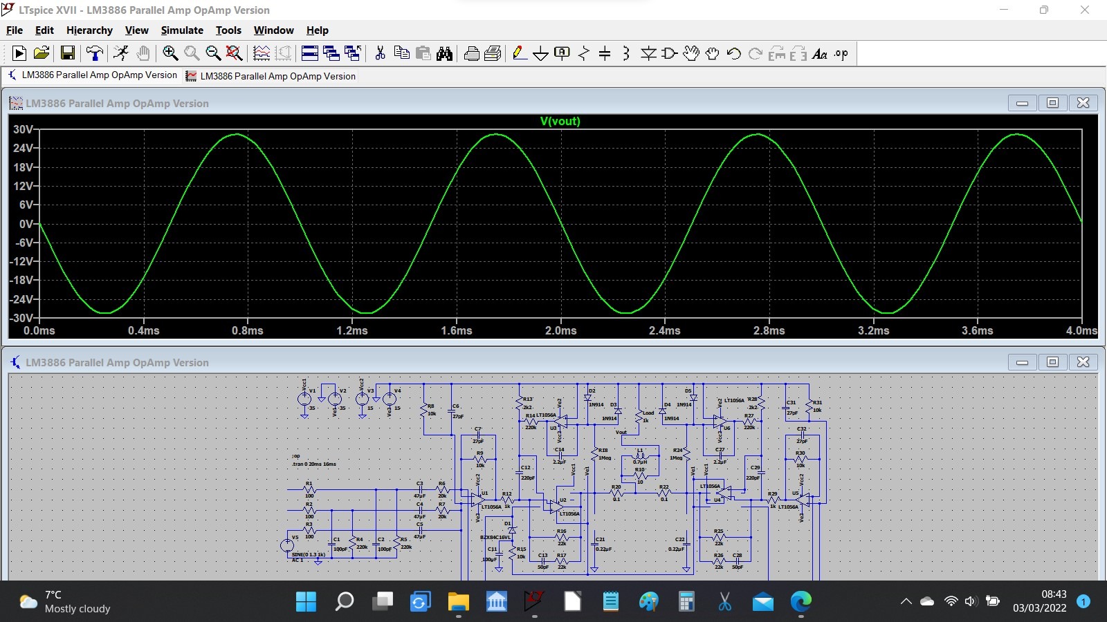

This might get you interested (and started) in simulation. This file should just click and run in LTpsice and uses opamps in place of the LM3886. The gain structure is the same.
Click my signature line to see how to get started.
I already loaded this file and I was surprised that all the hard work was already done! That file is just an exact schematics ready to be run! Thank you so much!
I just need to load the LM3886 module into it somehow. Will dig into the tutorials.

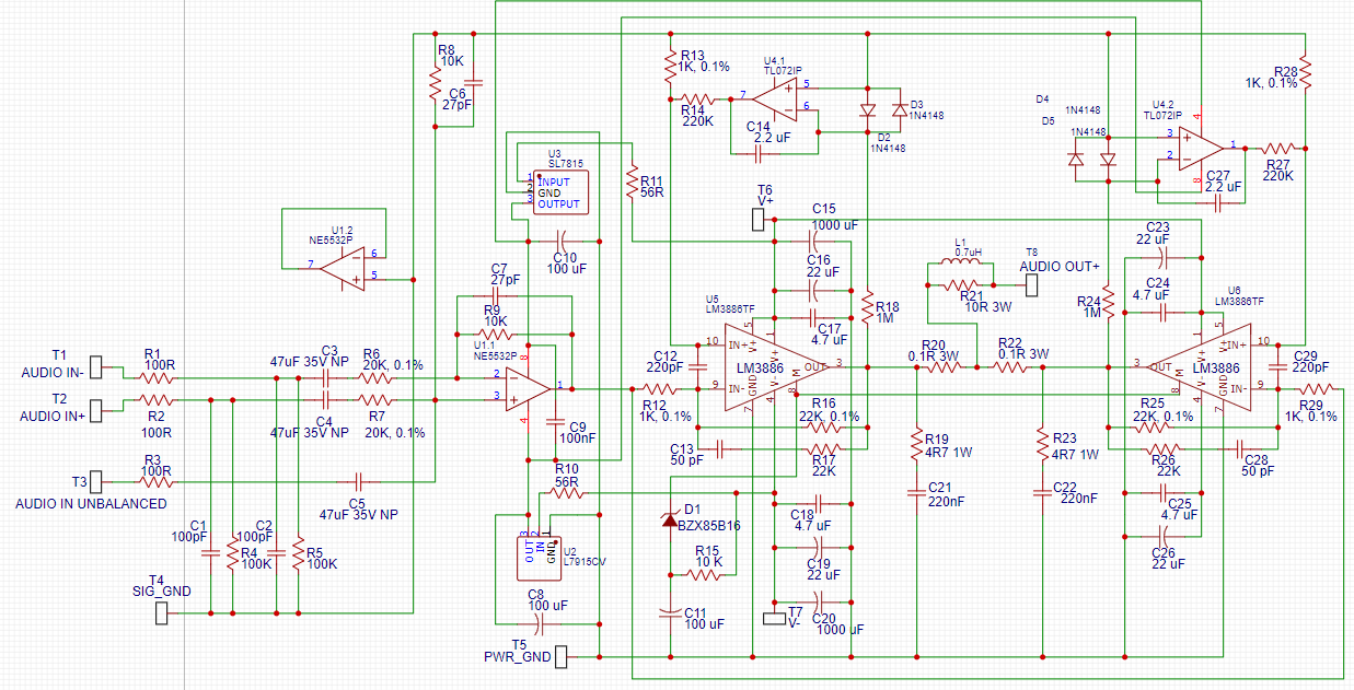

Updated resistors R13 and R28 to 1K. According to AN-1192 they should match resistance of Ri (R12, R29).
On the same note, R14 and R27 should be 10 times of R16 and R25 (feedback resistor) respectively.

I would be quite happy with a TL072 as a servo. The output offset is typically going to be in the couple of millivolts region using one of those.
You can't go far wrong with an NE5532 as a linear amp although the LM4562 is possibly a better option on paper. Given a choice I'd go the LM4562,

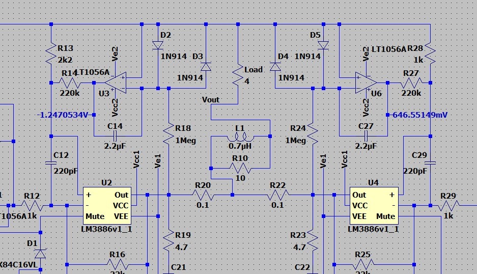

It probably makes no difference in practice simply because you have a DC servo to correct any offsets. When the amp is built for real then ideally you want a value of resistor that gives 0.00 volts DC at the output of the servo opamps. In the simulation the DC voltage is around 1.2 volts with a 2k2 and half that with a 1k. Remember you have up to -/+ whatever the opamp supply is as a correction voltage and so its a non issue.
Here is 2k2 and 1k
Reactions: pbilous
