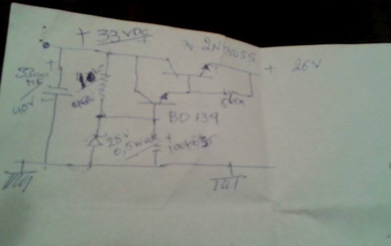

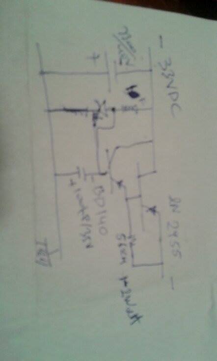

We also built two stabilizing circuits as in the pictures attached and used the original transformer. we removed the bridge from the board and soldered it with tow extra 3300 capacitors. that way we had only stabilized dc voltage going to the pcb. but the hum was still there.

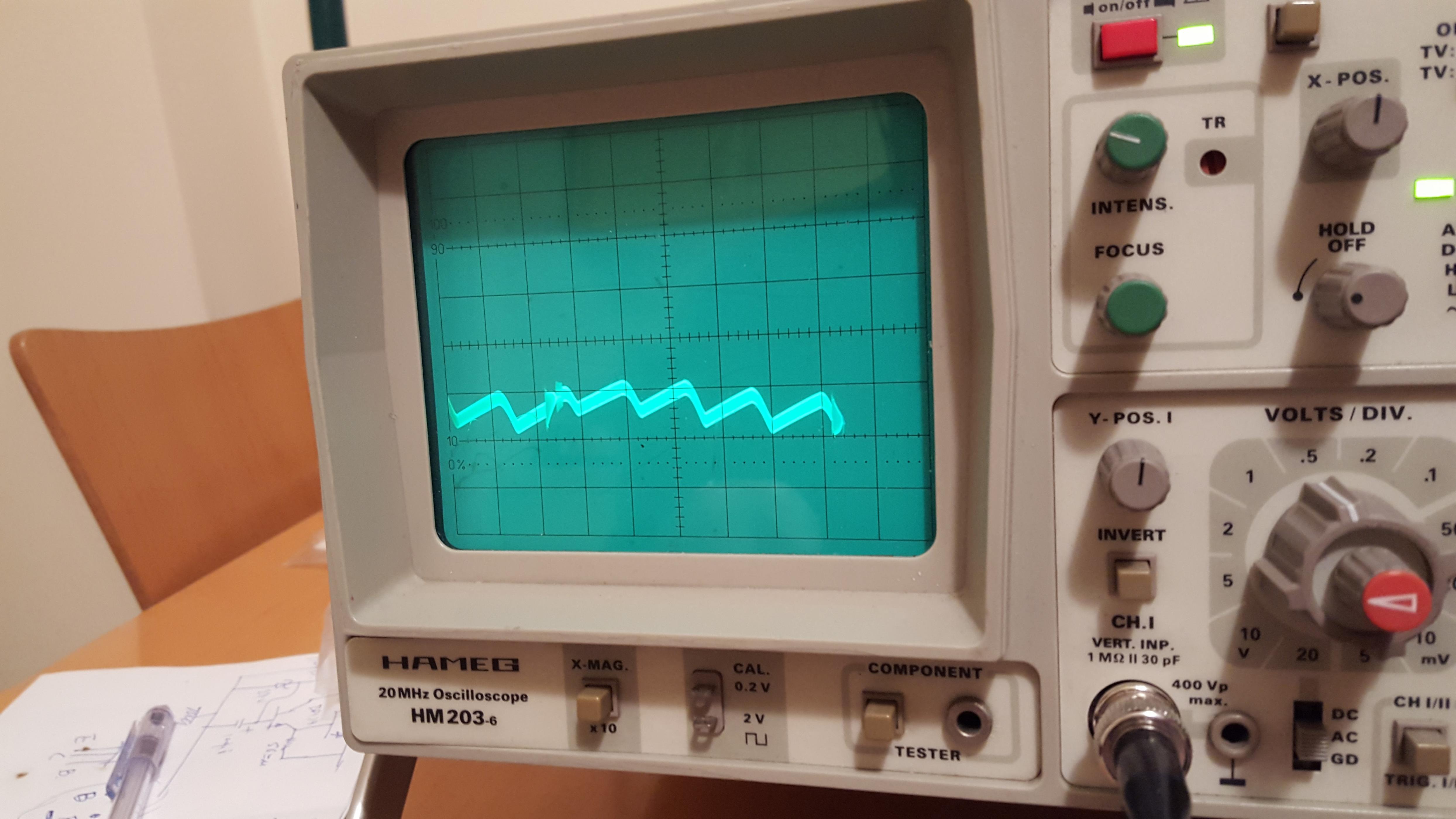

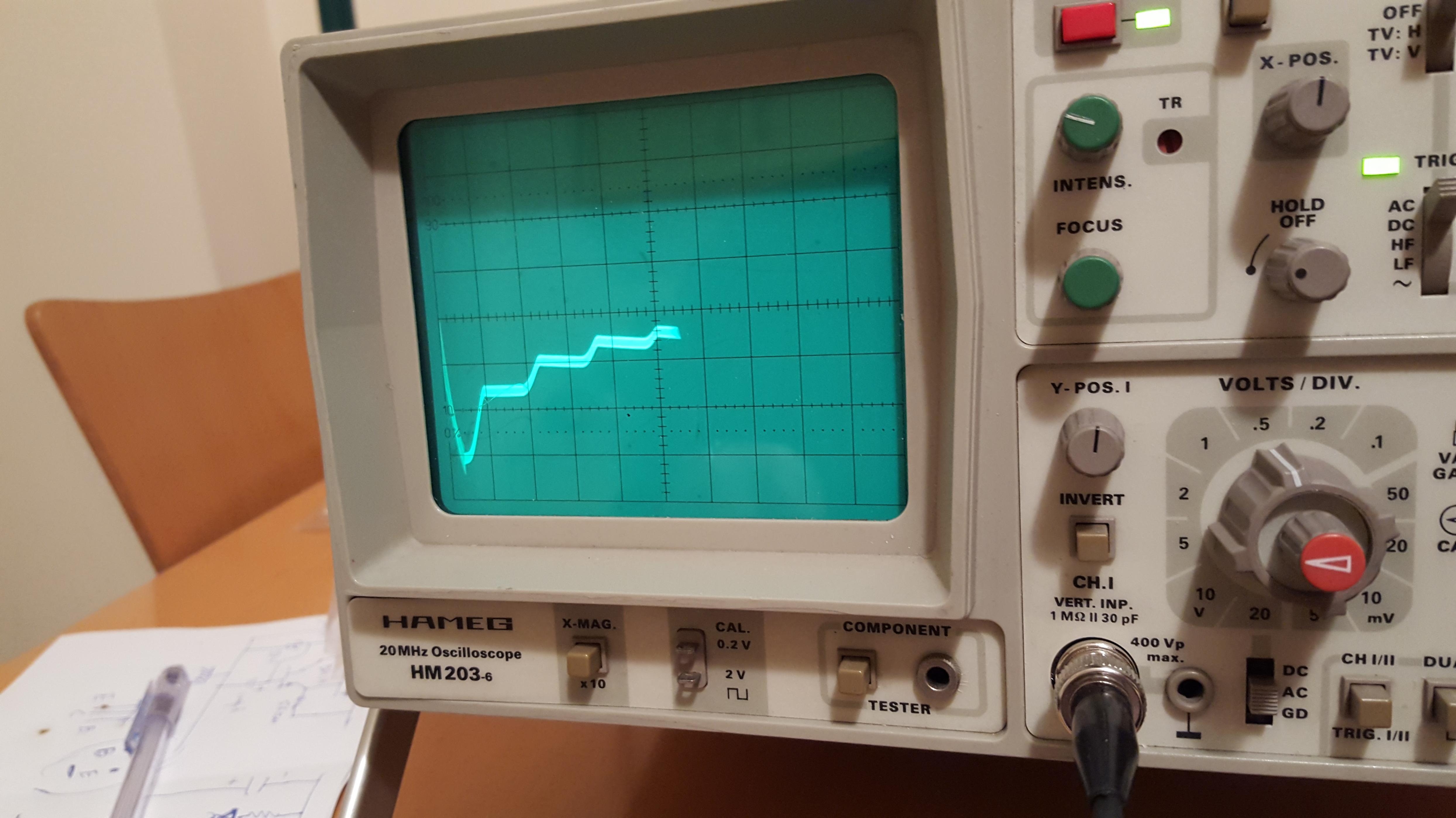

when we put the whole assembly on the oscilloscope we noticed something weird with the bridge rectifier. As in the pictures attached the positive and negative output of the bridge is different. So we thought that something might be wrong with the bridge. After changing the bridge the hum is still there.

The +ve ripple looks fairly normal from peak to peak. What value is that reading?
The ripple on the power supply is very "thick",
Is that thickness made up from a very fast oscillation?
I also see an intermittant break up, that looks like interference.
Can you get that interference to disappear by switching off all nearby fluorescent ligts and LED lights and soldering station and anything else that has switching PSU?
The -ve ripple looks weird.

the thickness is due to the oscillation. I didn't bother to adjust it and make it look better before taking the pictures unfortunately.
both pictures are at 0.5volt/div as you can see from the knob on the right. I dont remember the exact voltage. But both pictures are taken at the bridge (before the two extra circuits I built) If I'm not mistaken. I guess its around 33volts? not sure though
I cant recall which picture is from the positive and which from the negative of the bridge. But the first picture is ok, my problem is with the second picture.
in the second picture there is that drop that I think is the problem.

Is that trace the ripple on the PSU, or is it the output of the amplifier?
It's on the PSU
It should not be oscillating.
Remove the regulator.
Test the transformer alone.
add on the rectifier.
Test that assembly.
Add on the smoothing capacitors
Test that assembly.
