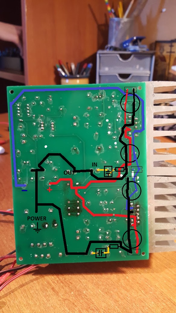

The PCB layout has some problems. The ground layout looks something like this:
Power->Output->Input->R5->C25->C26->C6->pin7->C1->C2
The power rails are not any better. Power connects to the chip pins and then connects to the capacitors.
Can anyone see how we can improve the ground layout without cutting traces?

can you explain that further?
There are charging currents to and from the capacitors (Power GND->C26 and Power GND->C1). These are passing though the same traces as the input ground (Input->R5->pin7->?). This could be the cause of the hum.
One must never take the audio circuits to the PSU charging circuit. NEVER !
Resolve the charging side as a compact low loop area layout that minimises the radiated interference.
Then take the PSU power out as a twisted pair/triplet to the power input of the receiver.

You can remove the bridge from the board and mounting it outside the board. Use the one that you can mount it in the chassis. I never like to mount the bridge on the amplifier board. The best it is to mount it outside and then bring the dc filter voltage to the board.

I found from a friend a 2x12 transformer and I'll try powering the amp with it just to eliminate the possibility that the hum is from the transformer.
Morky, if you test the amp with lower voltages you will probably need to reduce Rmute (R9+R12 and R24+R25). Even at +/-35V DC the 44K that is used here is higher than normal. When you switch off the amp how long does it continue playing?

The mute does not work like a switch. If Imute is slightly low it becomes unreliable and half mutes the chip.

They show the graph of mute attenuation vs mute current. Read it and ensure the 3886 does not start to enter mute when supply voltage fails a bit due to supply rail ripple.
As supply rail voltage falls after turn off, the mute current falls and the mute attenuation increases.
The reverse happens at start up. As supply rail voltage increases the mute current increases and the mute attenuation deceases.
What you do not want is mute attenuation varying as supply ripple changes the supply rail voltage.

The THD starts to degrade quite a bit once Imute falls much below 500 uA. I aim for 500 uA at 2/3 of the nominal rail voltage. There's a 3 V drop from GND to the MUTE pin. Use Ohm's Law to work out the resistance:
Rmute <= (0.67*Vsupply - 3)/0.0005
Don't forget Cmute. The 100 uF mentioned in the LM3886 data sheet seems to work just fine here.

My guess looks to be correct. A 44k Rmute and the 12VAC transformer, that you want to use for testing, gives you Imute less than 350uA and the amp never un-mutes.
