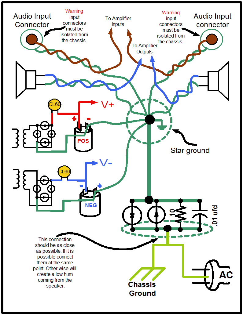

Sorry to belabour the point but on your diagram on the 'An Example of Star Grounding' drawing (on your website), the final iteration would have the output terminal swapped for the + output thus shortening the ground tracks and the feedback ground (incl signal ground) is fed directly to the output ground point and the separate track for the power ground comes from between the bypass caps C2, C4, not the electros - presumably, the Zobel filter goes here also, if I've got this right - and really wide copper tracks or layers instead of tracks, yes?
I imagine the 0 volt wire to the raw supply end up here also? And if using a 'ground lift resistor', this would also connect here too?

your post28 pic breaks the rule: close coupled signal wires.
a.) The RCA to amplifier signal wire PAIR must be close coupled all the way from the RCA to the amplifier.
b.) The Speaker pair must be close coupled all the way from the speaker terminals to the amplifier.
c.) The positive power supply pair must be close coupled all the way from the PSU to the amplifier.
d.) The negative power supply pair must be close coupled all the way from the PSU to the amplifier.
Wiring the "star ground" as you have shown brings BIG LOOPs into all those signal pairs.
