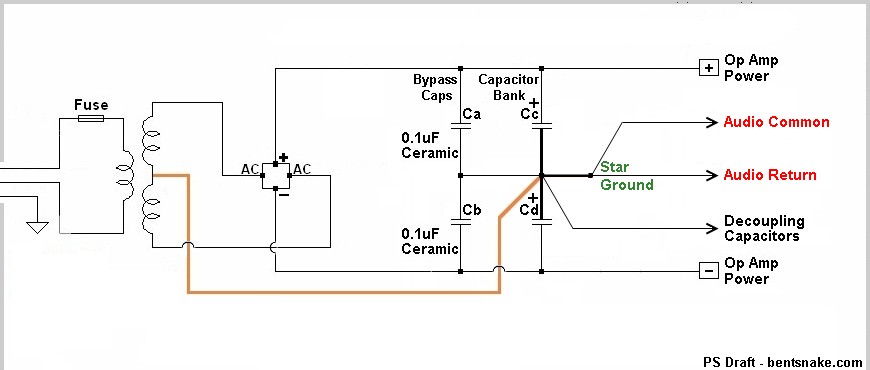

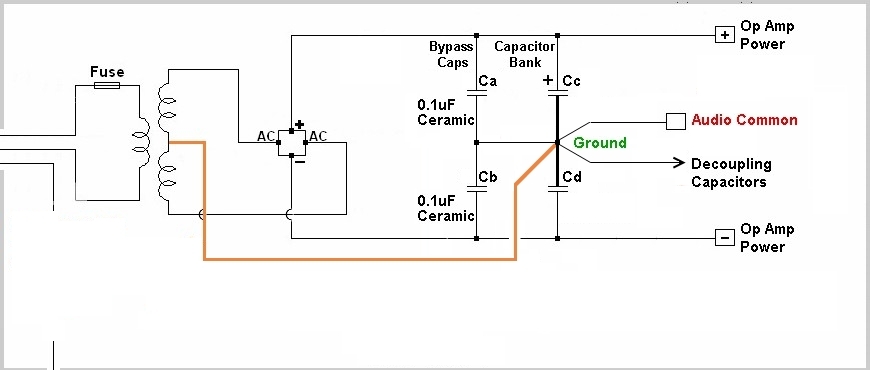

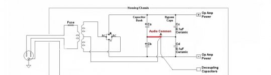

Not, it's not anymore because the audio current loop and the charging current loop share a track again..The second is still yours, but I've moved the connecting point for the capacitors and other connections. No other changes.

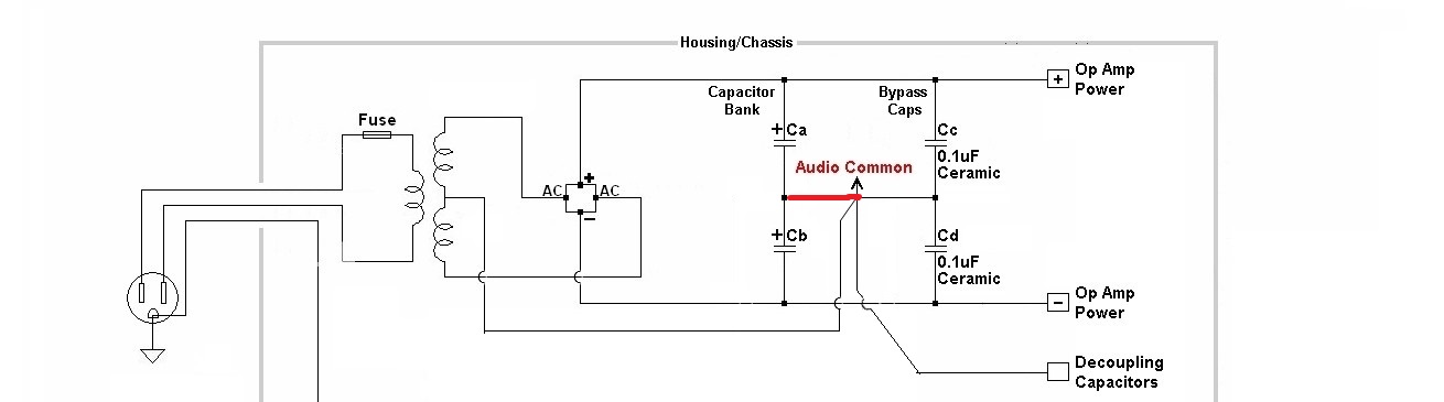

Nah. I attach below exactly what Self means in his book (removing all unnecessary things for now).Right, with the connecting point moved to Mr. Self's "short spur" point you've simply redrawn my schematic.
edit: in the second attachment, I highlighted in red the piece of wire that is the problem.

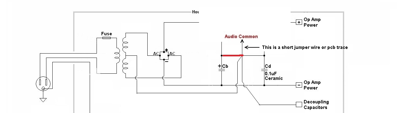

Now wanting to make sure I understand what you're saying, which at the moment I don't think I do.
Your second attachment above I yet again edit, just to make some room.
Is my arrow with the note, "This is a short jumper wire or pcb trace" in accordance with what you're saying?
(Or do we agree that this is, in fact, a short jumper wire or pcb trace?)

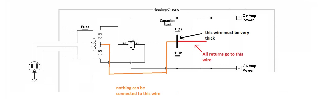

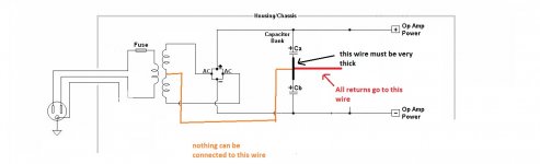

What I'm saying is...
the track you're pointing must find its origin at the caps terminals (it's the red track in my first pic). Currently, it is connected to the wire coming from the CT and going to the cap . See again my sims in the other thread to see why it is a bad idea.
edit : basic fact: the most "stable" points wrt voltage in your circuit are the terminals of the reservoir caps. The audio returns must go to that point. Allright that far ? Let's go back at the circuit just above. Every 1/100 of a sec, the point where all the wires come together (at the "bottom" of the short wire) is raised by the impedance of the red track multiplied by the charging current spikes. It isn't thus a stable point and a fortiori not the place to put the common ground.

So you have a PSU board and a AMP board with three ground wires connecting them?

Bentsnake, that was sneaky. You altered your schematic after I placed my post. My questions are still relevant.
Rethinking. In for a penny, in for a franc.
Getting good. If you want to further refine, this thread is a goldmine: http://www.diyaudio.com/forums/chip-amps/252436-lm3886-pcb-vs-point-point-data.html
Seems original poster tbj is long gone, and who can blame him. Still I'm finishing the current thought with an updated schematic.
Many thanks, 00940, for your help. I was looking right at the solution without seeing it, but no longer.

Please pardon my ignorance with the following questions:
What do you mean by "decoupling caps" which you have going to 'A' ? I have seen decoupling caps in series with the signal, but not grounded. Do you mean additional storage caps near the load?
Ca - A - Cd "conductivity." My meter doesn't do siemens. 😱 For practical terms is this typically measured in ohms? Is it measured from the -Ca lead to +Cd lead?

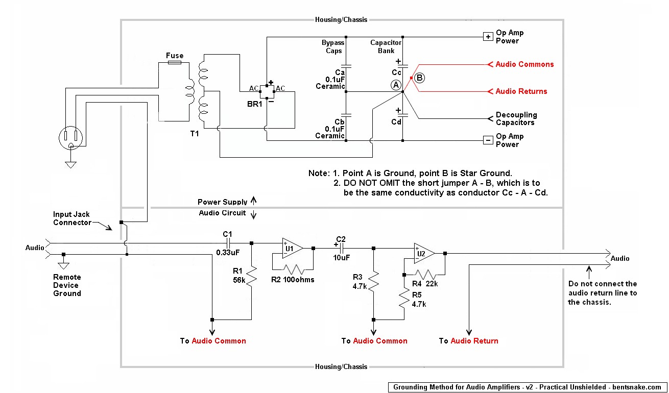

Can you explain why the A-B jumper is needed?
Thanks a lot!
I do mean the additional storage caps near the load (the op amp itself), commonly specified as 100nF, by me as 0.1uF.
In my experience capacitors in series with the signal are usually called just blocking capacitors. Not to imply that "decoupling" is not a correct term.
Note also the bypass caps I call out in the power supply. Very unfortunately, the terms decoupling and bypass are used interchangeably by many, so nobody knows what anybody is talking about. I googled both terms, and used the first definitions that came up in Wikipedia.
Don't measure anything, it just means use the same size (gauge) wire, or the same width trace on the printed circuit board, throughout. Which you'd probably do anyway, but don't use heavy gauge conductors throughout the power supply, and then go down to #24 for jumper A - B.
You can come into point B with #24, or whatever size wire or trace you're using for the audio circuit. Which with me is usually just the component leads.
Ask me anything, but don't ask me that.
On its face the whole thing looks silly to me. What difference can a quarter- or half-inch length of conductor make?
However, more than one guru (someone published, or else widely recognized as knowledgeable) insists that such a jumper is needed. Supposedly they have the expertise, and hopefully the measuring equipment, needed to make such a claim, so I simply accept it as fact.
In such a case as guru Texas Instruments they certainly have the equipment. Whether they use it I don't know.
Thanks very much for asking. Clarity is what I'm working toward, so finding out that something is not 100% clear is valuable to me. For instance, I wasn't crazy about the term "conductivity" in the first place but it's all I could come up with. I hope something else will occur.
In a sidebar I guess you're thinking about building an LM1875 amp? Good move, they're very widely built and liked.
This just means that A is roughly in between the - terminal of Cc and the + terminal of Cd.Ca - A - Cd "conductivity." My meter doesn't do siemens. 😱 For practical terms is this typically measured in ohms? Is it measured from the -Ca lead to +Cd lead?
"Jumper" is a bit misleading. It must be a thick piece of wire (or a large track or a plane on a pcb).Can you explain why the A-B jumper is needed?
If all wires had zero resistances, it wouldn't be needed. The problem, illustrated in this post, is that you must avoid placing the audio "0" reference in the path of the charging currents going from the transformers to the caps Cc and Cd. In practice, not anywhere in the wire going from the transformer's center tap to the point A.
By creating this "tee" A-B (to use Self's term), you ensure that you're not doing that mistake. Another solution is to make the point A a very low impedance point (a plane on pcb, a small copper plate) and then everything can be connected to A.
As an aside, while 100nF caps are kind of a standard in decoupling opamps and the like (and I'm guilty of using them quite often), it's not always ideal. With modern low esr electrolytics in //, the combination can lead to resonant peaks. These days, it might be advantageous as a rule to go to 1uF or 2.2uF x7r caps; they're pretty cheap today. Decoupling is another wide topic....
As another aside, I'm not certain Ca and Cb are that useful to be true.
