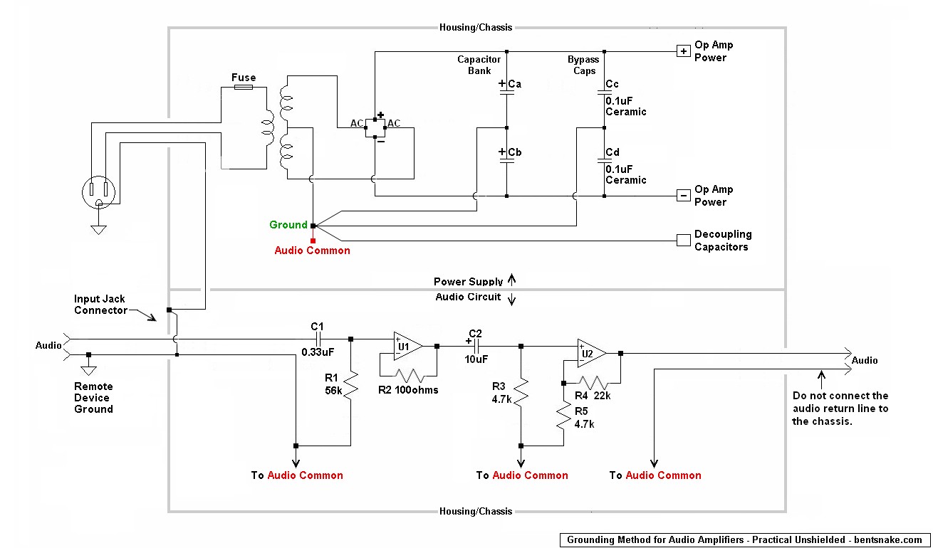

I am just trying to figure out the best way to wire the grounds on my LM3886 chipamp.
The boards will be of my own design - I have separated the power/speaker ground and the signal/feedback ground as per the layout:
This amp will also have a phono preamp and an active equaliser, powered by a seperate +15/0/-15 supply.
I am just wondering the best way to arrange the grounds as I know it's an important consideration with these chipamps. I've put a (very bad) paint diagram below of what I'm planning to do. Is this right? What's the best way to go about grounding this arrangement?
Cheers
Anything can be made complicated, but remember that the main idea is just to keep the audio signal separated from the power supply. Half the battle right there.
As a reminder, you can build with printed circuit boards and still use jumper wires. Sometimes makes things easier.
Below I'm posting my understanding of "the right way to do it." Which I put in quotes because there is no such thing, everybody has his own pet theories. But possibly of interest.

If you don't have the experience or desire to design something better, it may well be easer and cheaper to purchase a PCB/kit.
If you do want to design a PCB there is a good layout guide in the datasheet.
A few problems that I can see are:
No mute circuit.
C4 GND connection should be close to C1/C2/C3 GND.
Feedback loop (R1) can be smaller.
The input layout and input GND to power GND needs to be redesigned.
Speaker GND could be moved to power GND.
Are you convinced that you do not need any of the optional parts?

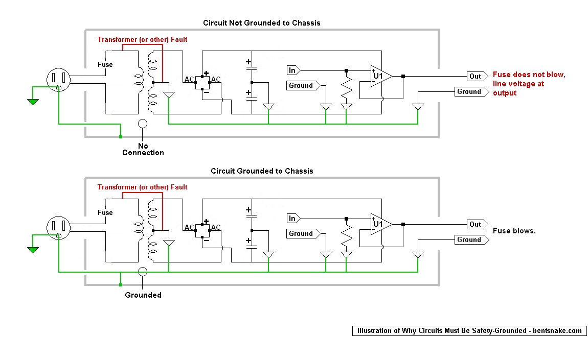

I will not ground the earth.
Please reconsider. For one thing, chassis grounding is required by law in pretty much all jurisdictions.
For another, the danger of having an ungrounded system is real. The posted illustration is intended to show that under some circumstances, any of various faults can result in line voltage being applied to what should be the safe, low-voltage side of the system. The consequences could be fatal.
Unlikely, true. But "unlikely" seems like poor odds when you're betting your life.

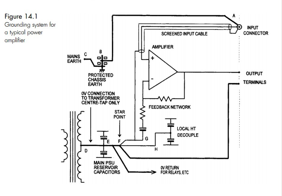

See the difference between your way and D. Self's proposition below (one you quoted yourself actually). And especially what Self means by "0v connection to CT only". If a physical implementation makes things clearer, go to Fig.2 here: Power Supply Wiring Guidelines

<< It's still the wrong way to do it...See the difference between your way and D. Self's proposition below (one you quoted yourself actually) >>
It's not "my way," as I keep explaining. Does anybody actually read these posts, or do they just look at the pictures?
More directly to your comment, thanks for posting. I'm well familiar with Mr. Elliot's work, as well as Mr. Self's.
But as for seeing the difference you speak of, no I don't. Which is the reason I didn't include any such difference in my circuit to begin with.
If you'd care to actually point out and explain the difference you refer to, as opposed to just saying there is one, my attention will be riveted.

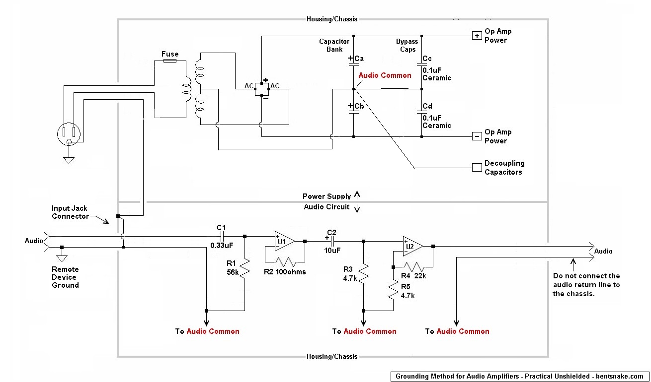

What both Self and Elliot take into account is that the low impedance 0V point of your power supply (from where current is actually sourced) is not the CT of the transformer but the terminals of the main reservoir capacitors. If you put the audio ground in between the CT and the 0V terminals of the main caps, you modulate it with charging currents.
That's what Self means by "0V connection to transformer CT only". If you have a look to Elliot's figure, you'll see the CT connected to one end of the groundplane he uses to link the 0V terminals of the caps and the audio ground taken at the other end. That's intentional, just as, in Self's picture, he has the CT link coming from one side and audio ground from the other.
Your scheme should at least be changed to the one attached. It would help to know exactly what you understand by "bypass" and "decoupling" caps to further refine. Just applying Self's proposition works in most cases so I don't see much the point of reinventing the wheel though.

In the present case the reference is Douglas Self's "Audio Amplifier Design Handbook," the section entitled "Amplifier Grounding." Mr. Self's comments in the text enlarge upon and explain the circuits shown, I've taken his comments into account in my circuit (I hope).
No, you didn't. Please re-read the section in Self's book. The key sentence is "Charging currents for the PSU reservoir capacitors must be kept out of all
other grounds."
Consider also what Self says about "reservoir ground" in the section about "power amplifier pcb details", a few pages above. The CT connects to that reservoir ground, NOT to the "tee" of the audio ground.
Although as before, as long as audio is kept separate from power I'm not certain else is critical.
You cannot keep them separate. At one point, you need a common reference and it needs to be clean. Your "compilation scheme" puts it at the worse possible place, a place none of your sources would endorse.
