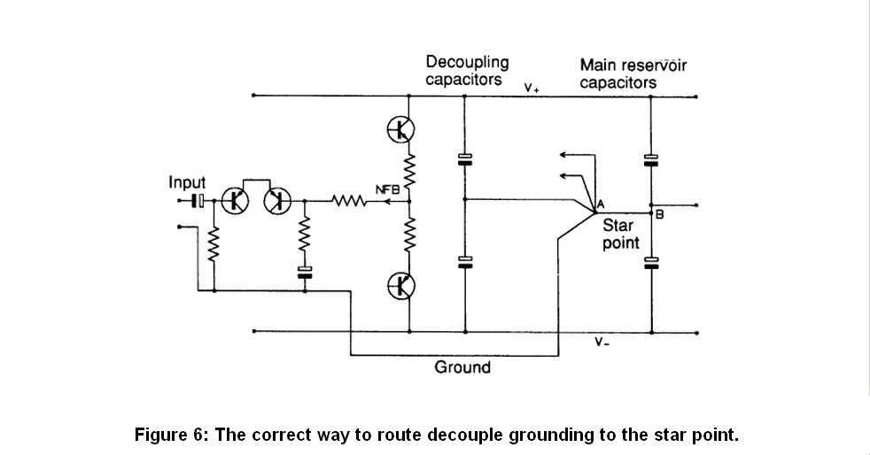

First a word of respect for 00940. This because he's the only human being on the face of the earth to actually comment on the circuit that's supposed to be under discussion! This as opposed to pontificating about some pet theory that has nothing to do with the subject at hand. And not only does he stick to the subject...he posts schematics!
In this case I refer to the schematic in post #15, posted again below. Unfortunately, depending on who you're listening to this week, it doesn't quite come up to the mark.
Since we're making free with Douglas Self's schematics I'll continue in that vein. His is posted first below. You know it, you've seen it before. The second circuit is 00940's.
Notice the small but critical difference. Mr. Self emphatically does not make any direct connections to the power supply capacitors. Instead he makes connections via what he calls a "short spur," which is simply a short jumper wire or pc board trace.
Is this jumper, or spur, really so important? Well, Mr. Self says it is, making his case fully in his "Self on Audio," the section entitled "Distortion 5: supply ground loops," page 272.
He makes the same case again in his "Audio Amplifier Design Handbook," related to the schematic in post #12 in this thread.
The same case is presented also in the Texas International publication on grounding that I don't reference again because everybody here knows the one I mean. Yes you do.
All of which seems to be simply (conveniently?) ignored by some. But speaking only for myself, I find all this acknowledged (by me, at least) expertise compelling.

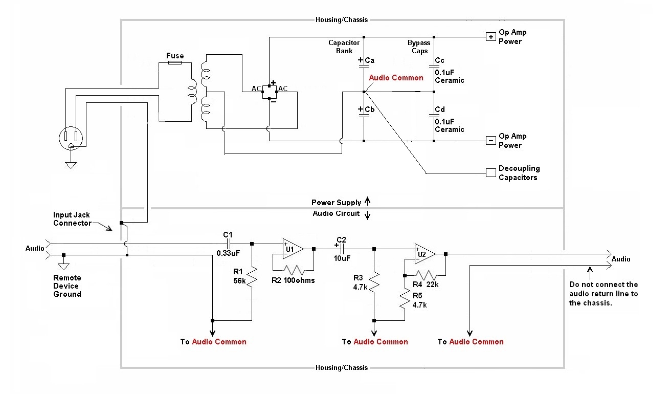

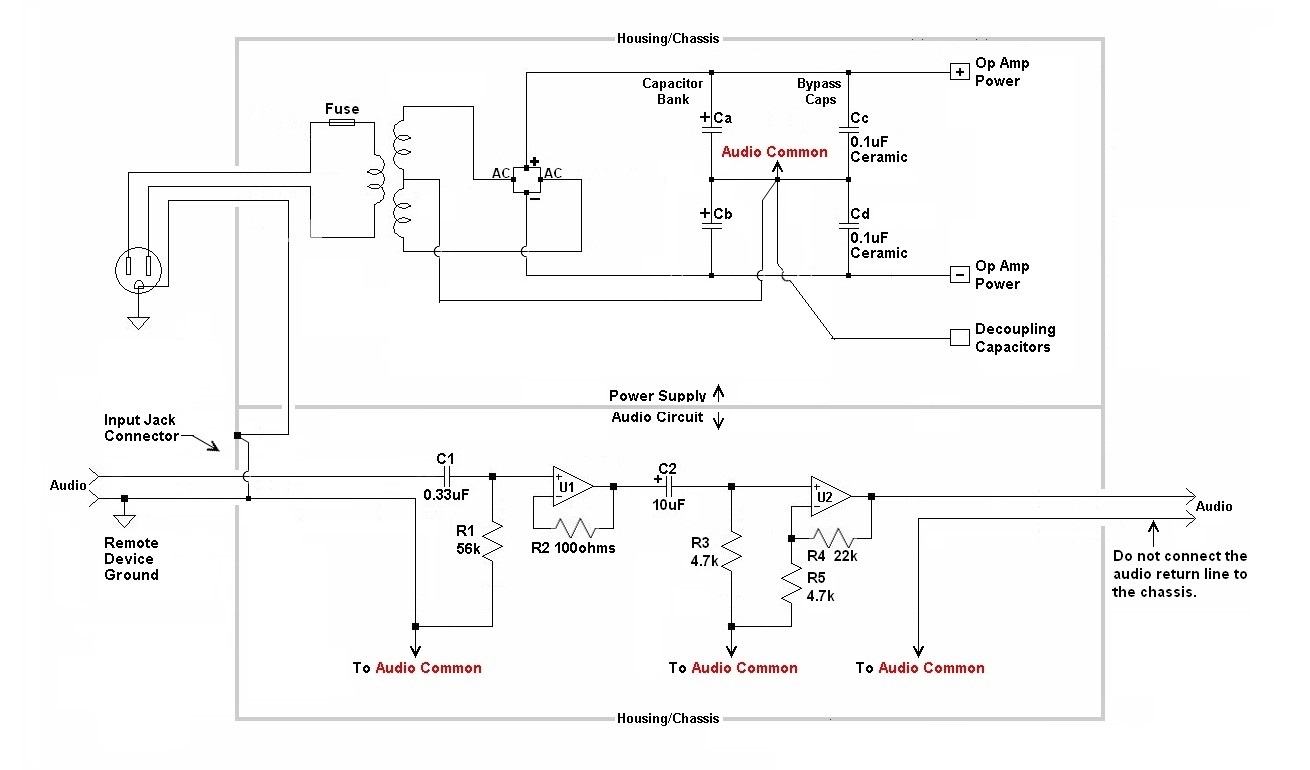

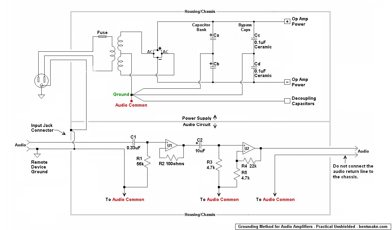

I probably shouldn't...what the heck, I am but flesh.
No kidding, 00940, you have my respect. You're the only guy around here with enough nerve to put a schematic where his mouth is.
Even so...well...I'm posting the series of 3 schematics you see below.
The first is yours. Actually mine that you modified.
The second is still yours, but I've moved the connecting point for the capacitors and other connections. No other changes.
The third is my original.
Right, with the connecting point moved to Mr. Self's "short spur" point you've simply redrawn my schematic.
Of course the whole thing depends on whether you believe in short spurs. Anyway I drew mine as I did hoping for clarity, but I wouldn't argue.
