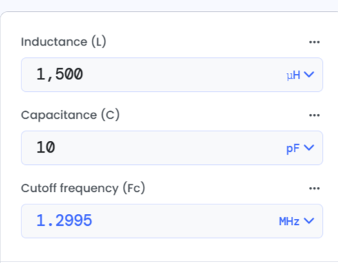

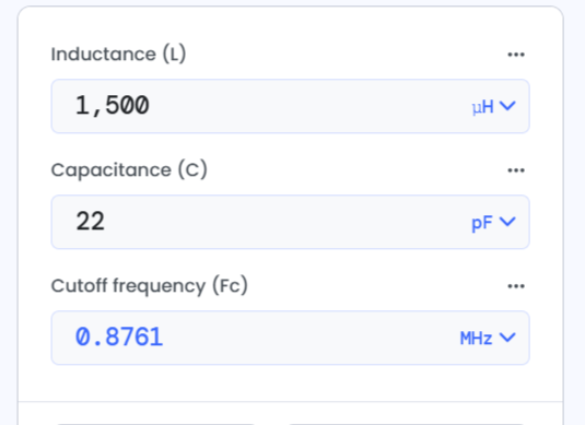

can I use cut frequency for this LC Low-Pass filter below 1MHz, like from 500KHz onward,Add an LC low-pass filter with Q ≤ 1 and a cutoff frequency around 1-2 MHz on the input.
and how to check Q ≤ 1 and what frequency?
Also, can I use LC Low-pass filter made of L=1500uH and
C=22pF with cutoff frequency of 0.876MHz or
C=10pF with cutoff frequency of 1.299mHz
l like to use what I have in my stocks , and I have inductors with L=1500uH Part No: B82442T1155K050
That's nonsense! The filter should be designed for a cutoff frequency of approximately 1-2 kHz, and the overall Q factor can easily exceed 1, as long as the filter is sufficiently separated from the noise band. It's always best to prefer smaller inductors and use larger X2 capacitors. The filter's internal resistance is more important than an overall Q factor slightly above 1; as mentioned, it's a prerequisite to have at least 1 octave of separation from the noise band. Filters in the megahertz range are a joke and won't eliminate your interference.
View attachment 1467481View attachment 1467480
l like to use what I have in my stocks , and I have inductors with L=1500uH Part No: B82442T1155K050 View attachment 1467490 4-reels and NP0 Caps C=22pF Part No: CC1206JRNPO9BN220 , I can get close to C=10pF by using two caps in series or I can buy new stocks NPO if I neeed to get Caps value less than 10pf required, but I don't like to get new stocks of different values inductors for that matter due to cost, for NPO I can bear some more extra cost, but inductors are different story.

So you want to cut off the top 3-4 octaves of the audio band in an audio amplifier? Then you might as well turn the amplifier off. That'd likely eliminate the interference too... 🙂That's nonsense! The filter should be designed for a cutoff frequency of approximately 1-2 kHz [...]
You're also assuming that an inductor that's inductive at audio frequencies is still inductive at RF. I bet many inductors used in audio circuits would be well past their self-resonant frequency at CB frequencies (27 MHz).
If the issue is that RF gets into the amp somehow and is demodulated and presented as audio, reducing the amount of RF that enters the amp would certainly cut down on the amount of interference. At the same time you'd want the filter to have minimal impact at audio frequencies, which pushes the minimum cutoff frequency to at least 200 kHz (10x the highest audio frequency of interest).Filters in the megahertz range are a joke and won't eliminate your interference.
If you also want good audio performance (for example, low distortion) you might want to push the cutoff frequency up a bit higher, which is why I suggested 1-2 MHz. Such an LC filter should have no trouble getting you 50-60 dB attenuation at 27 MHz.

So 1-2MHz range is the ideal minimum point, otherwise 500KHz can be a starting point for me.If you also want good audio performance (for example, low distortion) you might want to push the cutoff frequency up a bit higher, which is why I suggested 1-2 MHz
can you please give some insights on Inductor values , where I should start from if those 1.5mH aren't suitable for such LC filter and some on caps values and types
