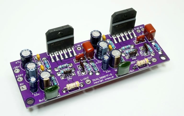

Obviously not but I did encounter RF when I was developing this kit with the LM3886. It was downright annoying. It's only a few components yet I had this RF issue. I have more than 20yrs experience designing discrete amps and never had this RF once.

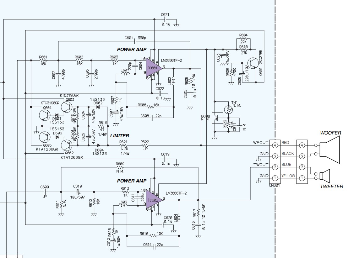

I did some research and chanced upon an interesting schematic of the Yamaha HS80M Active Speaker.
Apart the 220pF across the +- inputs, they inserted two inductors (L601/602).
My guess is to eliminate RF.
Don't get me wrong, the LM3886 is an excellent chip amp on it's own. You have brought it to a whole new level with your composite design. The DIY community should be grateful for sharing your work.
I'm just high lighting that one can encounter RF which is what the OP is having. Not everyone will encounter RF but some people do. I did.

Interesting. Could it be because you're missing the bulk capacitance on the PCB and that the other decoupling capacitors are pretty far from the LM3886 on your PCB?
Also interesting with the inductors in the Yamaha design. I fail to see how they would keep RF out of the LM3886, though. On the contrary, they would open the feedback loop at RF, which would make any RF issues worse. I suppose the LC formed by those inductors and the capacitor across the inputs of the LM3886 could do something, but if they do, I bet they're intended to tame any buzz or rail sticking that occurs when the LM3886 exits clipping.
If the issue was RF getting into the LM3886, why wouldn't Yamaha have added an inductor in series with the non-inverting input? For example in series with R602?

I'm sure Yamaha tried adding an inductor in series with R602 and found that it didn't help.
I think RF is picked up inside the chip amp, right at the input.
Because of that, no external filtering will help.
They solved it by tapping the RF from the output and injecting it into the -ve terminal.
That's where the inductors come in.
So basically, they are using the CMRR method to cancel out the RF.
Just an educated guess.

Interesting thought. I'm wondering what you're basing it on aside from that one bad experience that you haven't seem to have gotten quite to the bottom of.I think RF is picked up inside the chip amp, right at the input.
If that was the case, they'd be marked as wire links in the schematic. No company of that size will pay for inductors that don't do anything.I'm sure Yamaha tried adding an inductor in series with R602 and found that it didn't help.
And if you're now sure that Yamaha found the inductors ineffective, why did you mention them in support of your argument. I'm confused.
Look. I'm not denying that you've had an experience with RF pickup in an LM3886-based amp. But I am inviting you to look for alternate explanations instead of simply blaming the chip. If this was a widespread issue, we'd all know about it by now.
Precisely the point. So, explain to me why the inductors are there?
This is not the first time I hear RF complains from the LM3886. Check it out yourself.

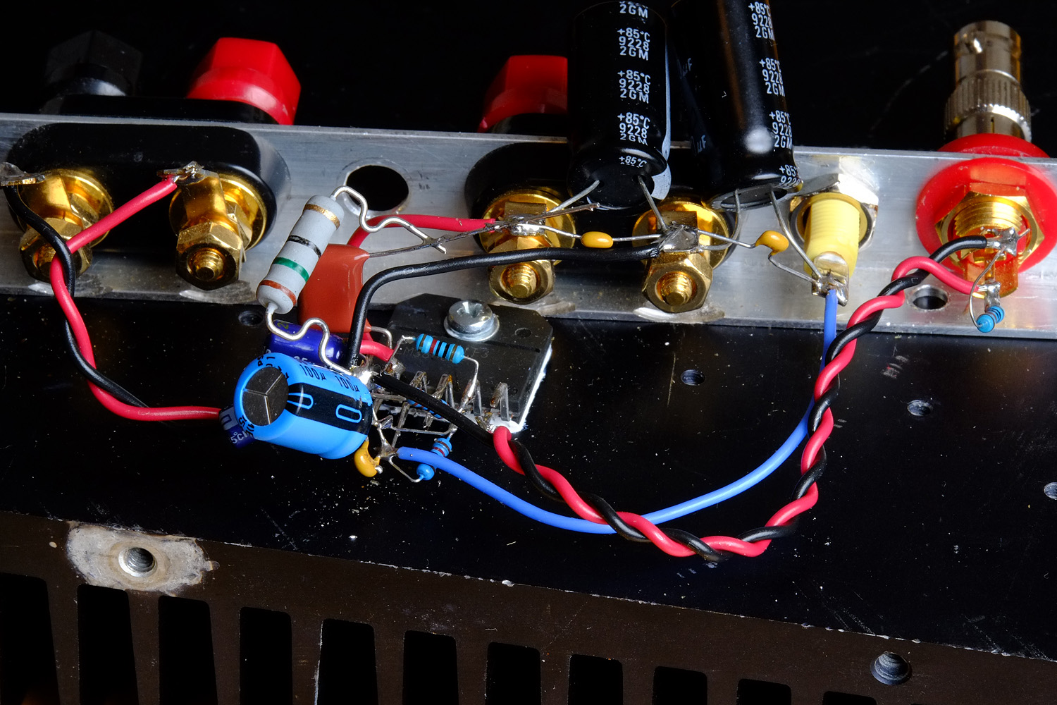

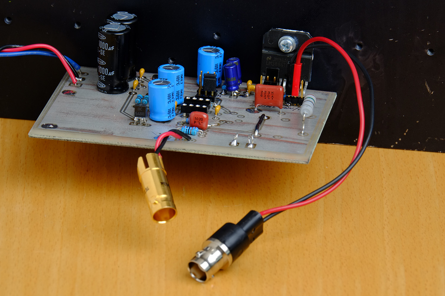

You could reference the inputs (left of Cin2) to GND either by a resistor per channel or by adding volume control. Change the filter to -3 dB point 100 kHz. A ceramic cap from the inputs RCA GND to casing may also work out OK. Another one to try out is to add tiny input ferrite beads around the input cabling. We can debate this to annoyance but without knowing the frequencies trial and error is a method just costing time while possibly offering a remedy. I always see it as a puzzle to solve with the reward being having solved it.I have an amplifier with several LM3886 boards I made. I knew them picking up radio might be possible, so I added a low pass filter on the positive input terminal. I have a 10µF blocking capacitor, and then a 20kOhm input resistor. This goes to the LPF of 1kOhm resistor plus 680pF capacitor. An online calculator says this is a 3dB cutoff of around 234kHz. This was noise free for the last year, but it suddenly started picking up garbled conversations of some kind. Just like once or a twice a day it'll pick up what sounds like someone talking into a tin can, sort of like that teacher from Peanuts.
Anything else I can do to harden this up a bit?
It is built into a metal casing (preferably connected to PE) I take? It definitely should be in a metal casing especially when being in a RF rich environment. Can be hard to solve! In tough cases RF may wander in via loudspeaker cabling and mains cables. Then ferrite rings and mains filters may be necessary.
RF/EMI has turned out to be audio's best enemy despite denial by many ("can't be heard").
