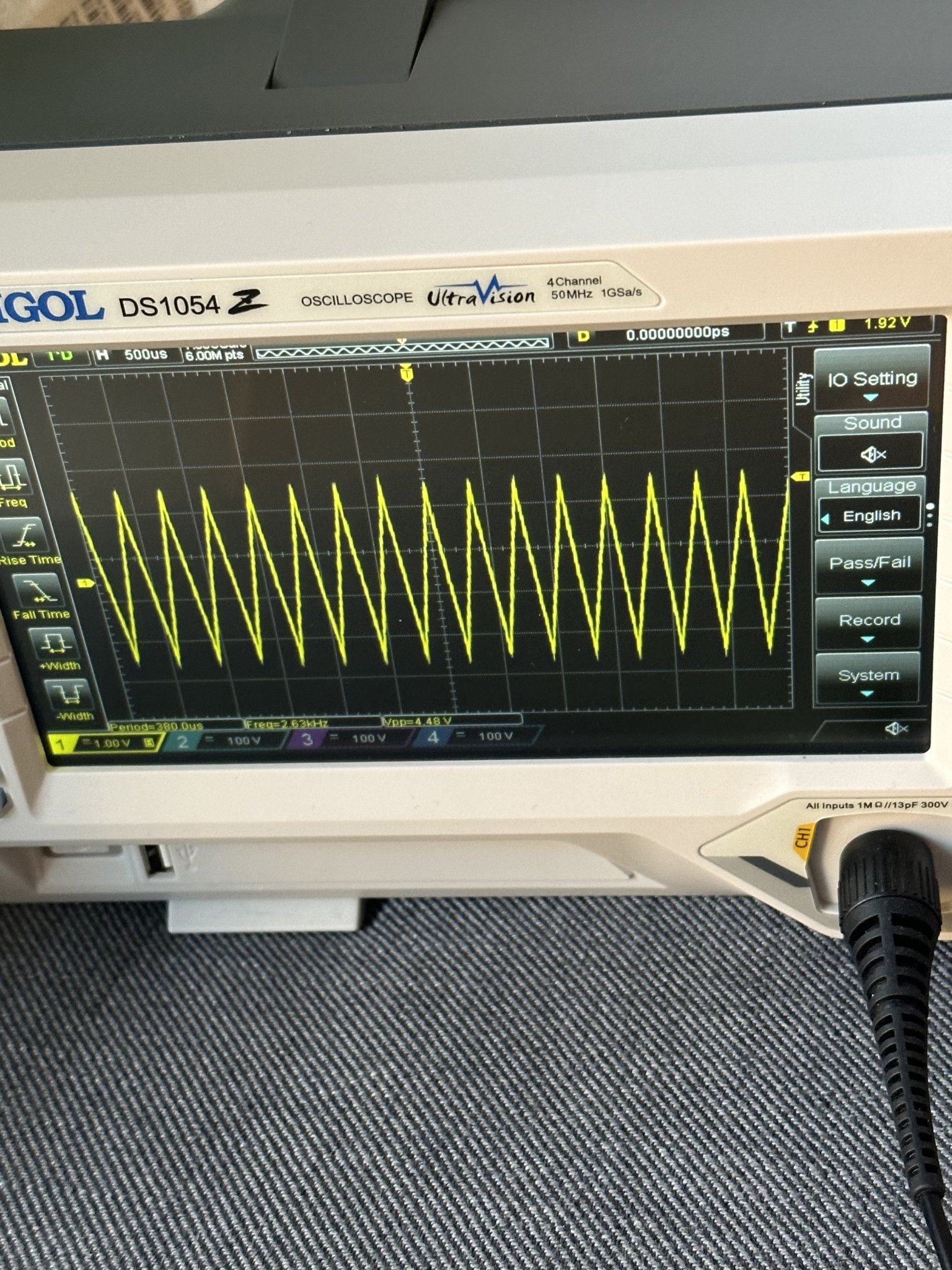

I built a DAC today based on the PCM1681. I don't have any speakers hooked up currently, but I watched the waveform on the output of it, and when I use the Beep Tone on the STA310, which the documentation says is a triangle wave, it shows up just fine as a triangle wav on the scope. So far so good.
That's probably OK.

1) triangle wave looks fine at the DAC output, but only if I apply attenuation in sta310 via registers. If I don’t, the tips of the triangle seem to fold over. I don’t think it’s clipping as they aren’t cut off, it’s like the DAC values start decreasing at the top of the triangle instead of increasing. Makes me thing it’s formatting at the stream level.

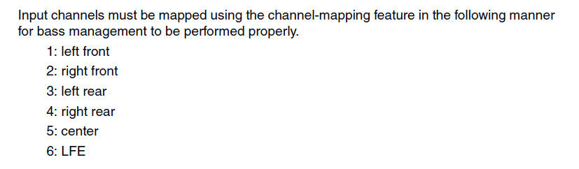

I went through my schematic again and compared it to the one you sent me. One thing I noticed is I have PCMOUT0 as pin 72, as per the datasheet (which says it's the prologic downsample). PCMOUT1, pin 73, is my left and right channel. That schematic you sent me shows PCMOUT1 as pin 72 (which datasheet says is PCMOUT0, and PCMOUT0 as pin 77 (which datasheet says is PCMOUT3). If the datasheet is right, then the schematic has mixed the channels up.
Datasheet says:
PCMOUT1 - 72
PCMOUT2 - 73
PCMOUT3 - 76
PCMOUT4 - 77
Schematic has it as :
PCMOUT1 - 77
PCMOUT2 - 72
PCMOUT3 - 73
PCMOUT4 - 76
Sorry, I only saw the first sentence when I read it before, must have been edited after.
I don't know, according to the datasheet it's wrong. I mean, it's possible to sort it out at the end by simply taking each channel the appropriate speakers. I'm just saying that it's not labelled properly according to the datasheet. So if someone thought PCMOUT2 was the channel for center and subwoofer , in the schematic it's actually the rear surround. At least that's how I read it.

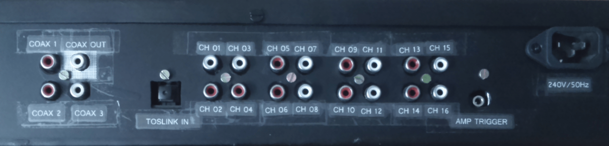

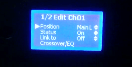

Well, it doesn't make a difference in my case as my setup has programmable channels that are assigned (mapped) to L, R etc. from the user interface. In fact, I don't use any names such as L, R etc. at all, below is a picture of my back panel with generic nomenclature. The user is free to decide which is which.
