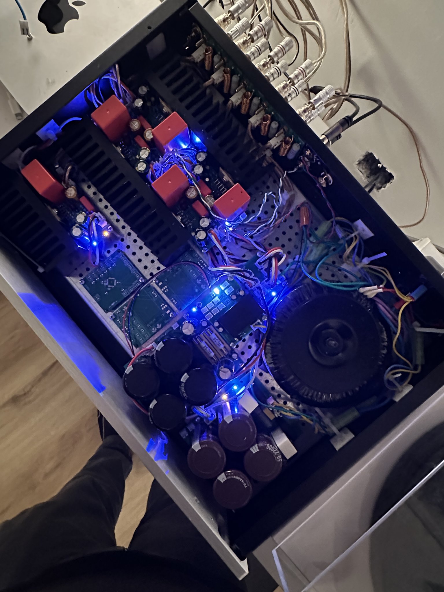

I finished the last two channels tonight. All five LM3886 channels are working and sound great with an RCA input. I'm moving onto the digital logic and the Dolby decoding shortly.

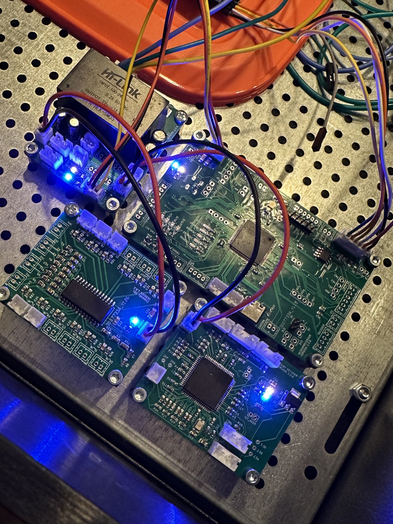

Spent the last few days assembling some new digital boards. I made my first attempt to communicate with the STA310 chip this morning. It wouldn't response to any address, and I finally realized I had it in perpetual reset since I didn't raise the reset GPIO I took to my microprocessor. After that it responsed, and I can confirm it's Cut 2.0 of the chip. I don't have it hooked up to SPDIF yet, but I did do all the configuration and activated the clocks at least on the STA310. I can confirm on the oscilloscope that the three clocks are running properly, and the actual data is all zeros, as expected, since I haven't turned the decoder on yet. So making progress.
You can check functionality without the S/PDIF by using the beep tone & pink noise generators on chip.
I don't have a DAC built yet haha.. But I have been inspecting the signals for the I2S.
What's weird is the L/R word clock is always 32kHz.. I can't understand why.. The bit clock is 2.0 Mhz, and the SCLK is 12.288 Mhz. Which seems right if the sampling frequency is 32kHz. I am using some cheap HDMI to SPDIF converter, I wonder if internally it's downsampling or something? But it seems to be decoding the TV signal. When I change formats that interrupt fires and I do a reset.
