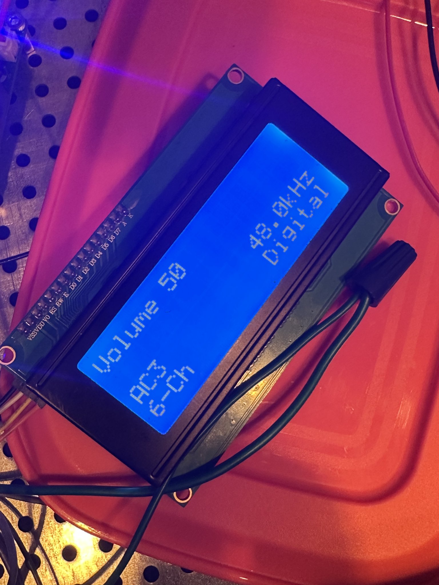

I'm pretty impressed with that chip so far. It seems to be working pretty good.. Almost too good in that I've had to adjust the audio sync on my Amazon Firestick as far as it can go just to match to the video properly. My Denon amp audio is lagging behind the STA310, meaning the STA310 is really low latency. I looked in the STA310 docs, and it doesn't look like there's anyway to adjust it. It's ok now, but if Firestick let me nudge it a bit more, I probably would a tiny bit.. But it's mostly sync'ed.
Reactions: aditya
The format detection seems to work mostly. I’ve only seen DTS once though. Sometimes when I play a DTS audio stream the decoder doesn’t execute a callback and still says it’s decoding ac3. But it still decoded. For all I know maybe the Firestick is transcoding it. But I coded that callback and have done my part at least. PCM to AC3 and back is always detected. But DTS programs don’t seem to trigger it. But like I said maybe the hardware in between is transcoding it. I haven’t had any audio dropouts since that original day. I think maybe a ground wire was loose and just causing a reset occasionally. But I’ve cleaned up some of the wiring and it’s been stable since. I’ve also made code
Improvements so the start up sequence is reliable now. Today I’ll probably test running the audio from it to the lm3886 power amplifiers, but using a 3.5mm cable. On the weekend I may try to hook them up directly, but I want to play with the volume levels and what not to calibrate the volume knob and initial settings first.

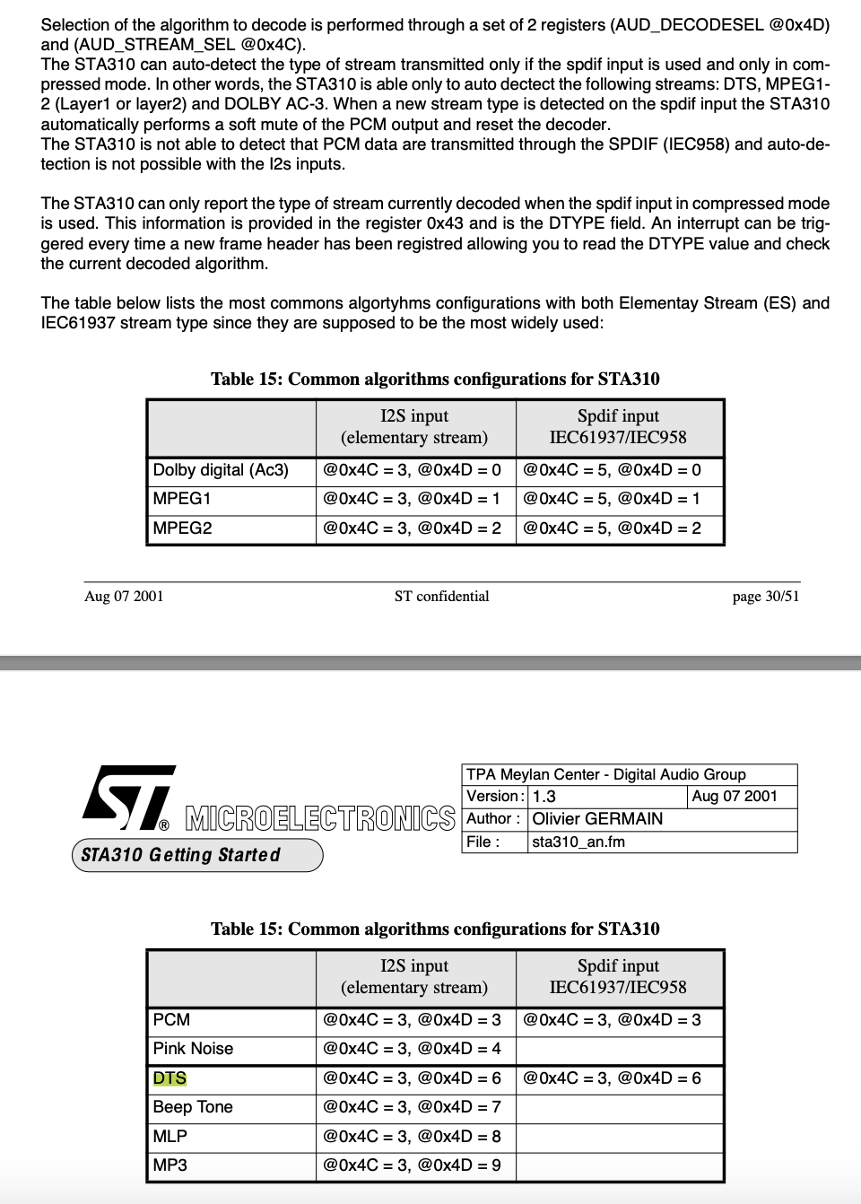

1) I haven't looked at the DTYPE, I can take a look. Is that what you recommend? I saw a note somewhere that the decodesel/streamsel is 0/5 for Dolby, but 3/6 or 6/3 for DTS. I did see that one time when I hit a breakpoint, but haven't seen it since. The Application Notes says that for DTS it should show a value of @0x4C = 3, @0x4D = 6. But I don't see that. I can check DTYPE though, maybe it's showing there.
2) I used the examples, which were just 1 of each (I think a value of 0).

Don't keep polling every 5 secs like that. Instead, enable the HDR interrupt and when it strikes, disable it and read the DTYPE and other status regs (after 100ms) to get the format, channels, bitrate etc. You can print them later, after leaving the ISR.
DTYPE is where you get the format information, not DECODESEL. STREAMSEL = 3 means elementary stream (header ignored), You need the DTS along with all the header information.
The STRSEL / DECODESEL is 5/0 for not only AC3, but DTS and 48kHz LPCM also !!!

Ok thanks.. But the application notes say something slightly different, which is why I was waiting for that. It does mention the DTYPE, but it also shows a different STREAMSEL/DECODESEL for DTS. 6/3 FOR SPDIF input and ES. I'll try it your way.

Since you need only one HDR per detection, you turn that off inside the its own ISR, which guarantees exactly one firing. When the next format is detected, you'd be soft resetting and repeating the whole init sequence anyway and within that the HDR would also get enabled, isnt it ?
The document is correct in that STREAMSEL / DECODESEL for DTS is 3/6 (ES) or 5/6 (SPDIF), but a value of 5/0 also seems to successfully loads the DTS decoder, and that is the value that the inbuilt autodetect puts into these registers.
The actual datatype is in DTYPE, which appears to be pulled out of the SPDIF header directly (see attachment). Wait 100ms after HDR interrupt to read the status regs (bitrate etc.).
