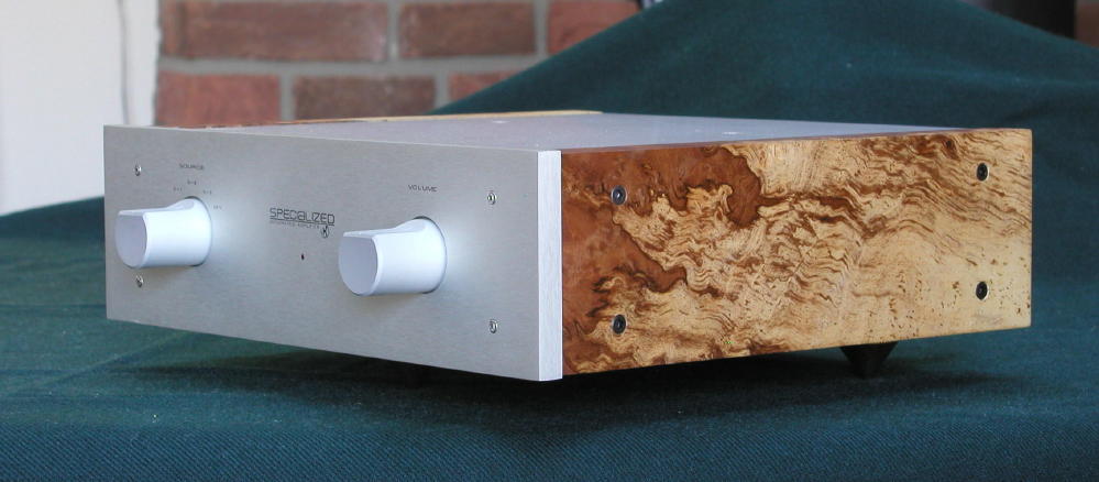

dfdye said:BTW, is that a spalted burl you used on the sides of those cases? They are quite nice. 🙂
This is actually cork floor panels, they worked better than acrylic I used later in production models.
As to the burl, that amp uses Mardone Burl: http://www.diyaudio.com/forums/showthread.php?s=&threadid=76609&highlight= This is also the best GC I've built so far 😉
Another example of burl in attached pic.

Peter Daniel said:As to the burl, that amp uses Mardone Burl: http://www.diyaudio.com/forums/showthread.php?s=&threadid=76609&highlight= This is also the best GC I've built so far 😉
Its beautiful.
