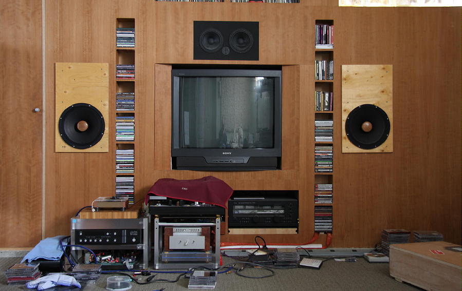

I'm presently testing 12" Electro Magnet Speaker drivers: http://cc.msnscache.com/cache.aspx?q=72918736801214&mkt=en-CA&lang=en-CA&w=e1b40950&FORM=CVRE and the bass is more than I've ever dreamed of. And I'm only using 100uF at the chips.

Those drivers are 98dB efficient and most speakers I was using with chipamps had efficiency of 90dB or more.
There are additional 1000uF in the PS and nothing more.
In fact, some people use my amps just for the bass drivers, the best example is that system, where GC monoblocks (1000uF supply caps) power the 30-foot long straight bass horns: http://www.6moons.com/audioreviews/westernelectric/300b.html
These are the actual amps used in that system:
