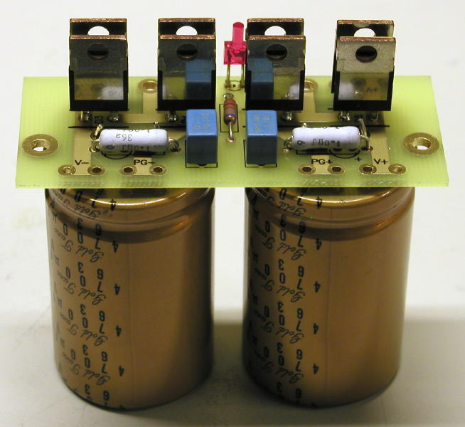

The audiosector kits have a very minimal PSU. I would consider buying a (couple of) PSU kit from chipamp.com. That PSU is a snubberized design with large smoothing caps and I think most people agree it's a pretty decent PSU offering good performance without being too complicated or expensive.

Yeah, I was looking at the Chipamp.com PSU, because 1500uF seems like a pretty small amount of capacitance for a power amp. The audiosector kit puts a 1500uF capacitor on each rail of each channel, so 3000uF per channel. The PS board just has the rectifier diodes and some 4.7uF caps. It is nice that the 1500uF caps are close to the amp boards, though. If I switch out this PS for the chipamp one, can I just leave the 1500uF caps on the amp board?

Yes you can...
I have been using 1000uF per rail at the amp and 16,000-20,000uF on the PSU board to good effect. As a matter of fact, it is usually suggested to have 1000uF or so right at the chip when using a larger bank of caps at the PSU

Ok, great. That's what I figured, but I wanted to be sure. Lots of smaller caps in parallel provides a lower ESR anyway, I think, so having those smaller caps close by should help.
Peter Daniel said:
You can use more capacitance with my PS boards, if you want. You can also implement snubbers and Zobels, if that's your cup of tea:
