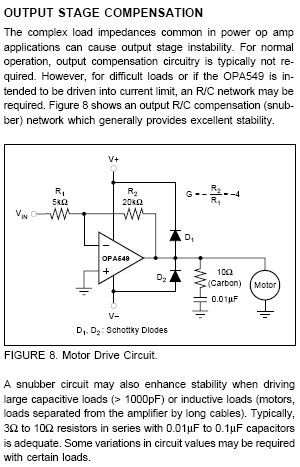

Bricolo said:btw, what's the difference between a snubber and a zobel? 😎
That's a good question.
I call a Zobel to an L around an R on the output of an amp.
But an RC to ground is usually called a zobel, when applied to speakers.
But some (like TI/BB) still call that a snubber.😀

Bricolo said:the odd thing is that a zobel is 0.01-0.1uF with 5-10R
completely different values
Because a speaker is a different thing.
Although the principle is the same.
I don't want a PSU with 5~10 ohms impedance at a certain frequency, 0,47R is more appropriate.😉

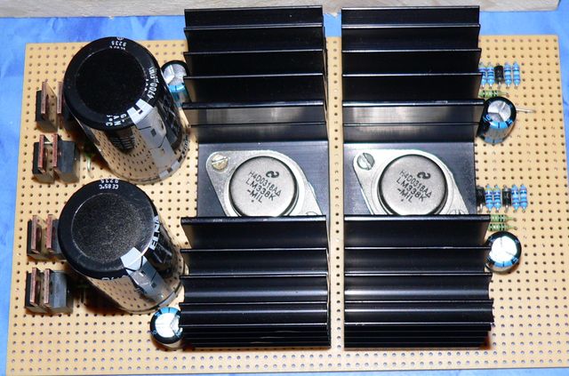

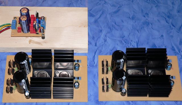

Hi Carlos, the moment that you have been waiting for is here! I have finished my snubberised, regulated GC (SRGC)! 😱
It took me longer than expected as the 'testbed' that I am using had quite small heatsinks and I had to modify it for something larger.
So, what is the verdict from the Dungeon?
Well, this is clearly the best GC PSU that I have tried - apart from the SMPS! I find there is a little more fine detail with the SMPS, particularly run at +/-12 volts. I felt that the timing was better with the SMPS too but in fairness, I have bad stomach ache today and that may have affected how I feel about the music! I will reserve final judgement until I have listened some more.
But I would thoroughly recommend the SRGC too without hesitation. Performance across the board is improved from the standard 1000uF per rail and it is a big improvement on the un-regulated snubberised PSU (at least in my system).
One surprise too. The chips run much cooler than they did the first time that I tried the LM338 regulated PSU! Is this down to the snubbers or the fact that I am using one supply for both channels instead of one each?
Anyway Carlos, a big thank you for this design and here is my humble version. I should say that I copied your design as closely as I could but I used 10,000uF Slitfoil caps and 1200uF Panasonic FC's on the chip pins. Oh, and output voltage is 27 volts (and the regs don't get too hot).

Well Nuuk, yes, it is THAT good.
The difference here, against your SMPS, is that this regulated PSU, besides amazingly detailed, allows an LM3886 amp to drive almost every speaker you throw at it.
And this is with just a single PSU for two LM3886 chips (a stereo amp), more than enough.
I am still avoiding paralleling LM3886 chips, which I think may degrade the sound, and concentrating on the PSU, which is the most important thing.😉
Btw, the "new" unregulated snubberized PSU is at the same level of performance as this.
