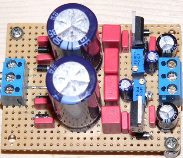

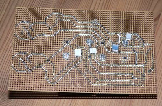

slackman said:Hi all,
(nearlly) finisched my PSU-modules. I took protoboards 'cause i didn't want to etch...
Here's a pic...
Did you use the 470nf caps (C3/C4) directly on the regulators' pins?
I can't spot them...
You could have opted for a slightly different layout, as the right side reg is far from the caps...
You should have no problems if you used the 470nf caps under the board, on the regs.
No,

I changed the output voltage to a little over 34 volts (2x 470R // agj to out, 2x 3k09 -- adj to ground) to make better use of the trafo (30V sec.)
