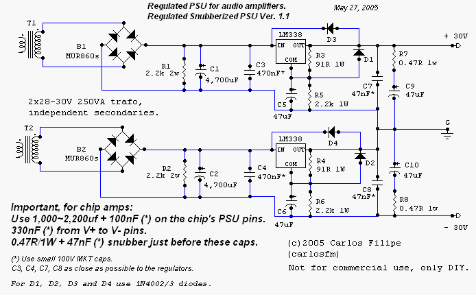

slackman said:did anyone calculated the resistors for voltage regulation (R3...R6) on the chip?
In my calculations, they only have to be 1/4W , max. 1/2 W. So why are these so great ones? For R3, R4 i come up to 0,01W, so 1/4 W would be large enough. R5 and R6 need 0,27W so here 1/2 W would be fine...
I ask this because in smaller dimensions it's easier to get the fitting Resistors.
I design my PSUs to last for a lifetime.

peranders said:Notice that those diodes are completely unnecessary in this application.
Come again?
When you have a Cadj. cap of more than 10uf it is recommended to use that diode (from Adj. to output).
I use a 47uf cap, so...
The other diode is not mandatory but doesn't do any harm either.
Better go read the datasheet, Per...
Nuuk said:Yes, you are right Michael. I think that I used IN4002's there, I'll update the site when I have time.
Nuuk, i'll send you a revised schematic tonight, with the diodes type.
But not the brand.

Upupa Epops said:2.5 A * 120 V is 300 W. How is, by you meaning, efficiency of this amp ? 300-120 = 180 . Look at datasheet, where you can read, that Ptot = 120 W.
Maybe the power factor (cos(fi)) does not equal 1.
Also, power losses in the transformer, rectifier etc. must be taken into account.
Milan
Milan, losses in rectifier are several watts. By transformer of this size is it up to ten watts. Practical efficiency of similar amp is around 60-65 %. For 120 W you don't need toroid transformer 300 W. BTW, by " musical " loading you can without problem overload similar transformer twice times, which is often used at amps for musicians.

Upupa Epops said:Which particular application ? Here we are talking about transformer for SS amp in class AB used for home reproduction, not about transformer for FM transmitter .
Any decent amplifier should have a transformer whose power is at least double the nominal output power. Higher transformer powers pose no real dangers (on the contrary). Diyers may experiment with different transformer power/output power ratios but should keep in mind that if they are going to drive their amps in difficult environments at nominal powers (e.g. active subwoofers), the ratio should be at least 2:1 to prevent transformer overload. Many commercial amplifiers do not abide by that ratio but, then again, this is a DIY endevour.
Modern FM transmitters have SS PP AB/B blocks and do not differ all that much from a diy amplifier. At least in terms of efficiency.
Milan
It's a question of costs and benefits, as with everything. However, we've been discussing the benefits so far. The actual budgeting is a matter of personal choices and priorities that everybody has to deal with on their own. I imagine not all diyers are downright destitute
