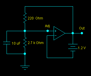

janneman :
Floating regulators are very tricky since the voltage reference is relative to the output, not to ground, so it's better to think twice before writing...
The capacitor from 'Adj' to ground causes the regulator to work as a 1.2V reference follower at high frequencies, so all the AC error voltage present on the output is feed back to the Adj input without being divided by the voltage divider that sets the DC operating point
In theory, the capacitor could enhance both line and load regulations by a factor of 'R-gnd-to-adj' / 'R-adj-to-out'
You can imagine the floating regulator as an opamp whose non inverting input is the 'Adj' terminal and whose inverting input is connected to the output through a 1.2V reference
Just a stupid drawing...

Eva said:The capacitor from 'Adj' to ground causes the regulator to work as a 1.2V reference follower at high frequencies, so all the AC error voltage present on the output is feed back to the Adj input without being divided by the voltage divider that sets the DC operating point
Bingo!
Finally, someone giving the National guys their due respect, .
What is "confusing" is that the "divider network" really isn't a divider network. R1 is there to generate a constant current flow into the lower resistor so that a voltage can be established on the Adj pin, in order to adjust output voltage.

Richard C said:Eva's picture paints a thousand words which is exactly what this thread needs.
two problems I have with it is that a) it has a positive feedback loop; and b) R1 should somehow be linked in the 1.2v loop.
Yes, floating regulators have positive and negative feedback at the same time, but negative feedback has higher magnitude
The purpose of the capacitor is to reduce or eliminate positive feedback at AC in order to enhance AC regulation

Eva said:The purpose of the capacitor is to reduce or eliminate positive feedback at AC in order to enhance AC regulation
I thought Jan said the cap made it no longer a regulator, .
What gives?
Richard C said:Negative feedback dominates via the 1.2V ref.
I think that's right. My 2nd concern wouldn't be valid as the non-inverting end will be essentially 1.2v lower than the output so the R1 is essentially in a loop with the 1.2 Vref.
