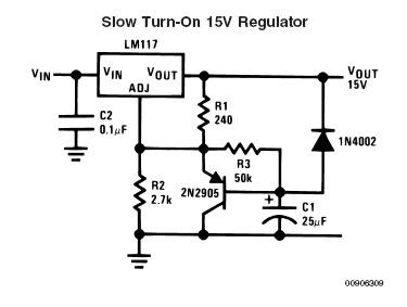

didn't I mention I was disappointed that people say things before reading the datasheet?
Let's just say that on page 14 of a certain datasheet the design team at National called such a circuit "Slow turn-on 15v regulator".
I understand that some of us know far more about lm317 than those engineers at National but that's not without exception.
edit: here is a snapshot of that National circuitry. enjoy.

I don't think something was lost in the translation of Mr. Slone's book; the circuit is just a familiar one from the databook of the manufacturer. Mr. Slone seems to have just copied it and added the wrong explanation.
Although a soft start circuit with just a capacitor across the grounded adjustment resistor would be easier, as you propose, the capacitor value should be a lot bigger than in the circuit shown. The adjustment resistors have a pretty low values because of the current tolerance of the adjustment terminal.
As for the remark of Jonathan: his proposal will work, but with a slight decrease of temperature stability, just as you (Fred) already mentioned. But that is dependent on output voltage; at lower voltages it will be more prominent.

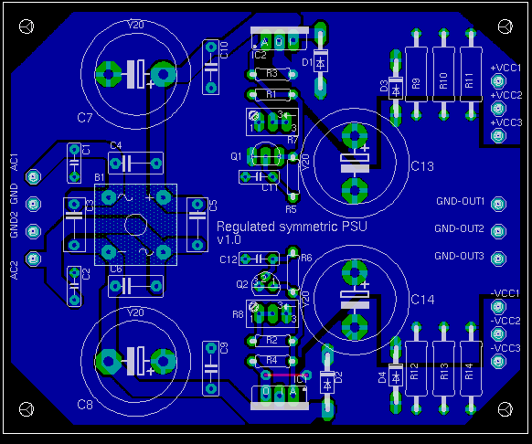

Re: Re: Shall I proceed to PCB this circuit, then?
Anything else? And thanks for all the inputs so far. I'm learning faster than any book could have taught me.
Yes, boss. (Never argue with a moderator. -- old jungle saying.) Hope the image below will indicate what I've done. Am now wondering whether it would have been better to just make space for one of those white box-shaped 5W resistors instead of three cylindrical ones?SY said:Double that power rating. A little margin is a good thing.
Me quite confused. DO you mean to say that I've kept too little space or too much space for the 'lytics? I have some 2200uF 65V caps at home, and they are 2cm in dia, the same as the space I've kept on the PCB. I was hoping that 4700uF 30V would be about the same size.moamps said:C11 and 12 have bigger dimensions (can be electrolytic).
This has already been discussed threadbare by minds more able than mine. I've attached a modified PCB below showing the added resistors. PCB layout seems to be about the only contribution that I can make to a discussion as sophisticated as this one.Steady current is too high (why wasting ca 6Watts)?
I kept the two regulators on the edges of the PCB, with their backs facing outwards, so that I could easily bolt heatsinks on them if needed. I have some neat finned AL extrusion heatsinks (unlike the bent-sheet types which most small heatsinks seem to be) which are about as wide as a TO-220 package. I guess those will easily fit on the regulators without disturbing anything else on the PCB.What about heatsinks on regulators?

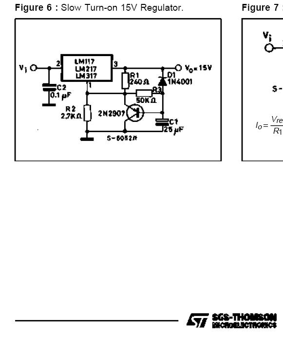

millwood said:to make matters worse, the same "incompetent" engineer works at SGS Thomson and TI, to name a few. Here is the SGS' version of the slow turn-on circuitry.
Fred and Millwood, are you guys serious? I mean not trying some private joke or anything?
Fred says " the intent is ..." Are you now in mindreading, Fred? This is a slow start, delayed start or whatever. That Slone doesn't get it, doesn't make it a different circuit. And Millwood, what do you mean by "incompetent engineers?". This is a slow start circuit that works. There are probably an infinity of other slow start circuits that also work. So?

janneman said:This is a slow start circuit that works.
sorry, Jan, this is certainly NOT a slow start circuit. As those "incompetent" engineers at National put it, this is simply a slow turn-on circuit. While "the concept of the circuit is fine, but the implementation is wrong", as Fred had correctly pointed out in one of his earlier posts (here: http://www.diyaudio.com/forums/showthread.php?postid=331667#post331667)
I would suggest that we all hold our breadth until Fred releases his correctly implemented "slow start" circuit.
In the meantime, everyone, especially those "incompetent" engineers at National, please try to understand "how the adjustment terminal works or how to correctly bias the emitter follower". OK?

Thank you Fred for bringing in all "regulation, PSRR, or noise" into this discussion: we laypersons certainly didn't think about it in prior discussions and I am sure they all are relevant and key to understand how the "soft start" circuitry works.
But I have to take exception with your calling it a soft start circuit. as you had correctly pointed out a few posts ago, the concept here is fine but the implementation is all wrong. Those guys at National, SGS Thomson, TI and potentially other places totally botched the job and this stuff in their datasheet is clearly wrong.
I breadboarded this thing a while ago. while the voltage does raise slowly on the output pin, I suspect it is because of my two DMMs not working properly.
We eagerly await your circuitry that will show us, and those guys at national, how to correctly implement a soft start on their devices while improving "regulation, PSRR, or noise".

"did I mention that their inplementation of "soft start" is totally wrong, as Fred had mentioned?"
I never intend to say that the circuit is a failure as a slow turn on circuit. Until the cap charges up enough for the base emitter junction to be unbiased the ADJ terminal follows the emitter and the base follows the charging capacitor. Looks like a slow start circuit to me.......
