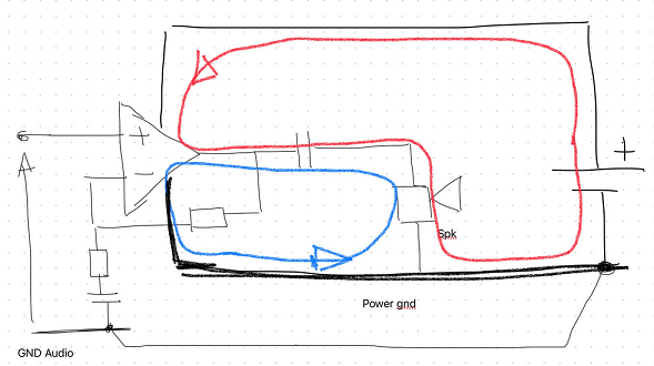

What you want to achieve is to avoid or minimize effects of the output on the input.
From a pcb routing perspective, in audio frequency domain, that means to avoid or minimize effects of high current path of the output on the input side. First thing to do is to ensure that input side ground path are not shared my output side ones, in which flows high currents. That’s a consideration of pcb routing, and it doesn’t necessarily appear on the schematic. But if you want to make that appears on the schematic, you define two grounds (as you did) and explicitly connect them at a single point located on the pcb (with the net_tie) or even on the supply with a star based grounding scheme.
Here's a sketch which shows where high currents flows : supply rail, output of amp and the payload: the speaker. Speaker and supply should share the same ground distinct from the input one but connected in a single point, usually close to the power supply. Same for the Zobel even if it draws much less current tan the speaker. The relay as no effect as this is DC current. The 100 Ohms could be removed, but you should install 10 Ohms between pin 4 of relay and power gnd, rather than a direct connection.

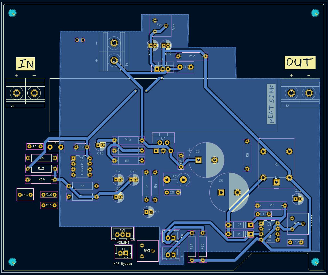

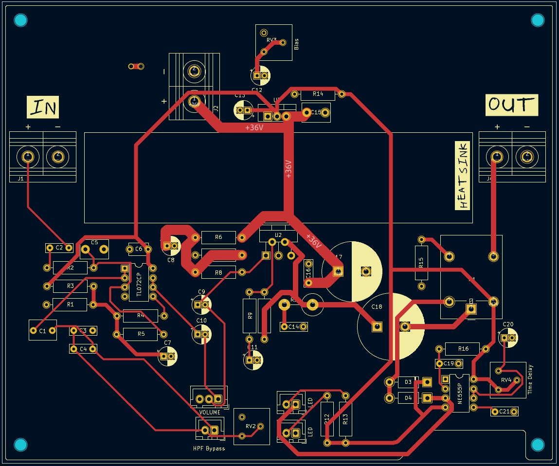

Thanks @AIM65 . Ive had a pretty big flare up with my chronic fatigue to its taken me a while to get this together.

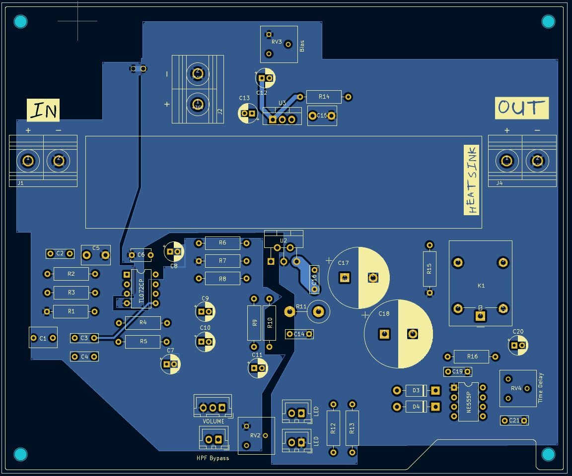

Does this look better?
Ive attached the Schematic I've redone and also the front and back of the pcb copper layers. I think it's alot better, but with my brain being a bit mushy at the moment theres a chance I might have missed something.
The divider and their cap should use Audio gnd, not Power gnd.
I just noticed this. Is this for all of the dividers & their caps?
  • Schematic.pdf
    Schematic.pdf

Some comments on the schematic :
  • C13 should be 100pF, not 10,
  • 2W for R5 is enough,
  • use carbon for R6, not metal film, this resistor can take up to 3.5A peak,
  • the two lower parts of the dividers (resistor and cap) should be connected to GND_Audio_Input. That's because they set the bias of the amplifier, every signal or parasitic on those wires will be amplified by the amplifier s (x1 for the two TL072, X16 for the LM1875)
  • you don't need to have a 'GND_Audio_output', just connect speaker and Zobel to the 'GND_Power'.
This last point will change your pcb layout : you'll basically will have two ground planes, connected together on one point : the Net_Tie.
I'll review pcb later. But the power tracks (the ones in red and blue on my previous sketch) are too narrow, make them wider.
Chris

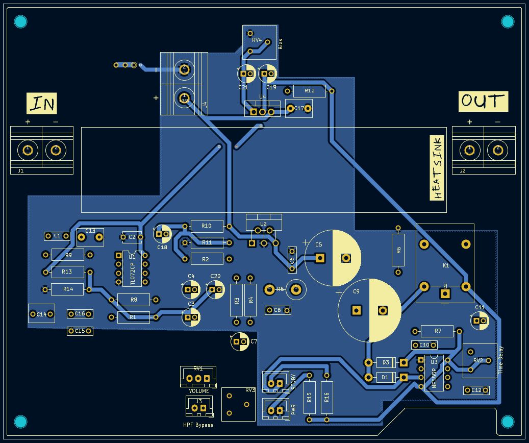

Thank you @AIM65. Getting there, but its always a slow process.
Thanks for the explanation. Ive reattached the changes.
  • C13 was a typo on my end =/
  • R5 is actually 1W. Yet again....Fatigue.
  • Changed the dividers as per your comment.
  • Consolidated the output ground into the power ground.
As for the Power Tracks, they are 45 mil / 1.15mm. I thought that would be output current is less than 1A and the power not much more. Happy to be wrong though 🙂
Thanks Again Chris
  • Schematic 2.pdf
    Schematic 2.pdf

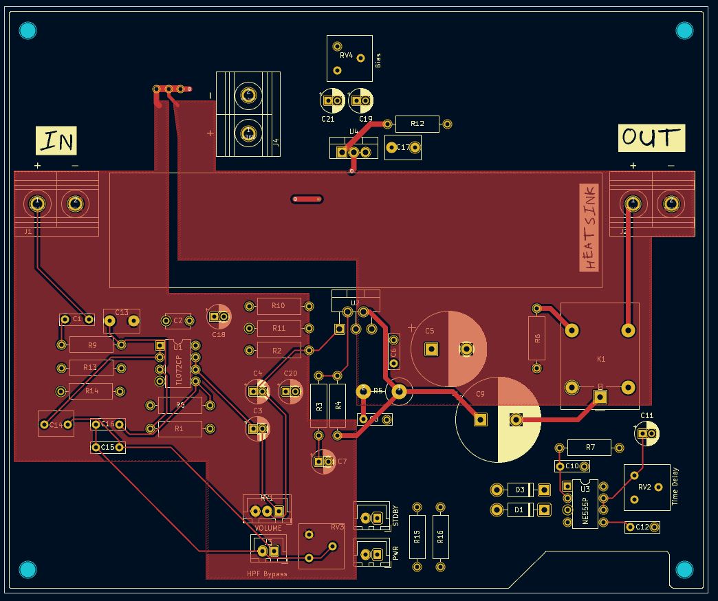

Usually, on a 2 layers pcb, tracks are on one side, gnd plane is on the other side with the few tracks that could not be routed on the other. Problem is that the gnd plane should not be interrupted by tracks, but when you have to, you have to think about where current flows inside the plane. This is true in audio frequency, but different in HF.
On your front side (blue) there’s an issue with the gnd plane in the red oval. The green arrows show the return current flow from the speaker. You have a high current path flowing through the very narrow piece a copper into the red oval. To fix this purpose, extend the gnd plane to the top border of the pcb. It’ll be better, even if not optimal.
You have the same issue with the yellow oval and to ground connection to C5 and C9 which are also high current. For minimal changes to your layout, implement bridges with a cluster of vias following the grey lines. An example of bridge is attached; the vias and red tracks connect the green ground plan, which is interrupted by a fat green vertical track.
In addition, you can remove the +36V track under the black cross and route it according to the pink line, and don’t forget to widen the high-power tracks, at least 3 mm. Move the nettie close to the negative pole of J2: speaker.
On your back side, widen the high-power tracks;, under certain circumstance current may reach LM1875 current limit between 4 and 5A.
Chris

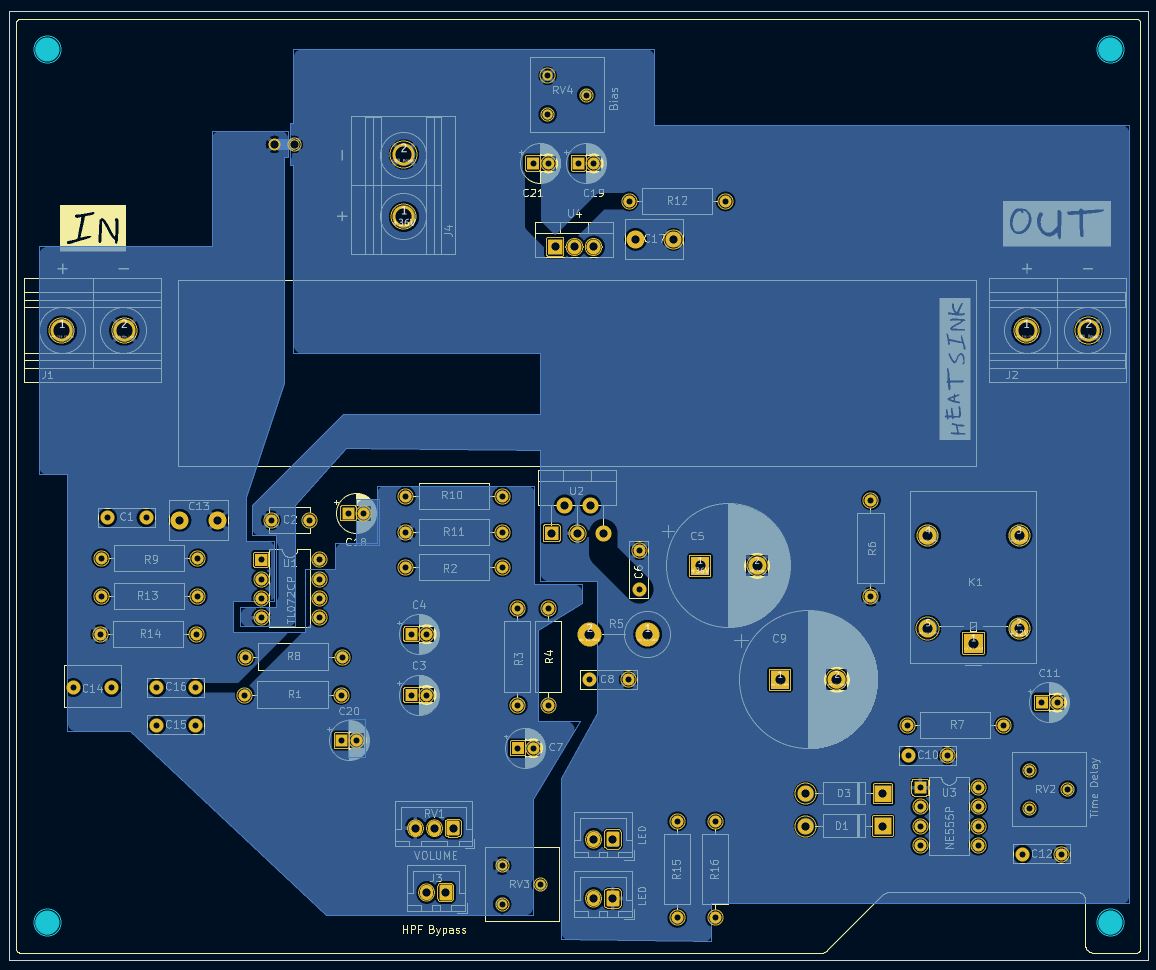

Ok Feeling much better about this! Can the 2 ground planes be too close together and cause "Pollution" of the signal ground?
You'll see 2 zones (C18 and C20) where i changed the fill to solid as I couldn't get the thermal pads, but they are overlapping and connected to the input ground.
This has been a great learning experience @AIM65 and i feel much better with the guidance you've given.
You're getting close the time you'll submit your order to the pcb factory !
I don't think, but honestly I don't know. I usually use a minimum clearance of 0,5 mm.

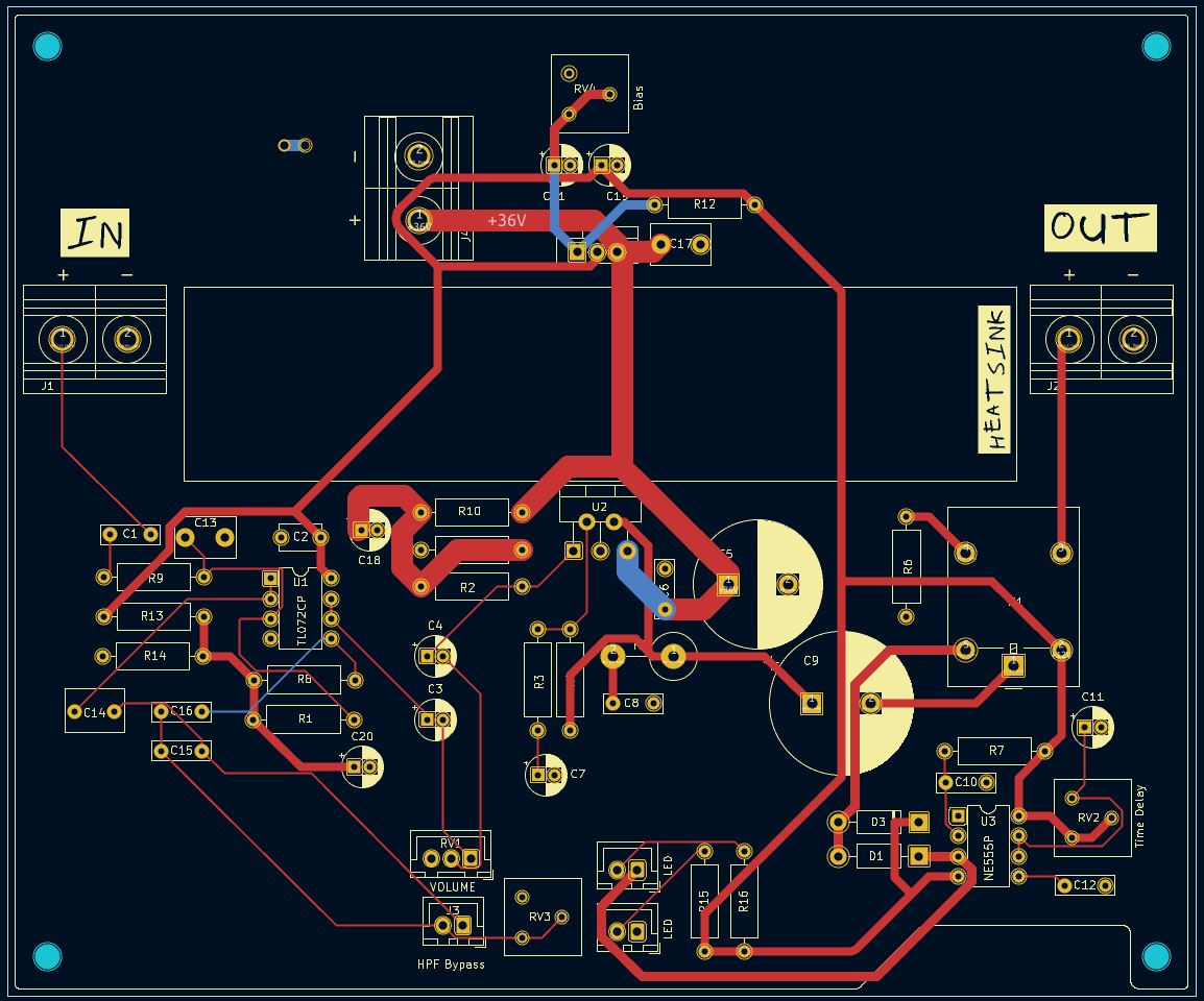

The path U2/pin4 -> R9 - > C9 -> K1 -> J2 must use wide tracks, this is a high current path.
That probably require you to shift right C6 & C5 and shift C9 down/left.

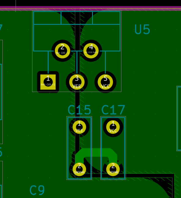

I do not like the loop U4/pin2 -> C19. C19 should be close to U4. Route +36V track to J4 below U4 not above, It'll free some space to set a short connection between U4 and C19.
You can also slightly shift right power ground plane below LM1875 in order to cover only power pins : 3,4 and 5. Pins 1 and 2 are input ones and could be covered by the signal ground, or nothing. The illustration below shows a signal ground plane on the left and a power one on the right.
And to finish, make the very narrow tracks wider. Narrow tracks are fragile and as it is DIY, tuning and rework are common... 🙂
If you're interested in pcb design, for DIY, read the paper attached. Author is Dave Jones from EEVblog. Content is very useful and practical.
Chris

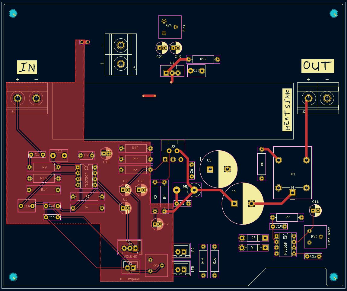

I've followed your advice and i think im good to go now 🙂 Thickened Tracks, Changed a bit of the ground and also completed the parts you mentioned.
Hopefully this will be the last post!

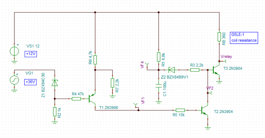

I don’t get how your 555 delay works. At power up, 555 should be triggered by a negative edge on TRG pin, but the circuit only provides a rising edge… does it really work ?. Does the trimmer position have an influence on the relay switch on delay ?. Usually, power up delay circuits with 555 looks like this one :
https://electronics.stackexchange.com/questions/353112/delay-turn-on-circuit-using-555
If you want power on and power off protection, the circuit become more complex. Feasible without 555, with some transistors.
ie:
At 0.00 this is power on; at 4.00 this is power off. Relay is On when Vrelay is low
This has not been tested, only simulated.
if you want to keep the 555, use the circuit described in the link above and part of the circuit above : Z1...T1..T2 then connect VF2 to the RESET pin of the 555 and also to a 10k pull up to +12.
