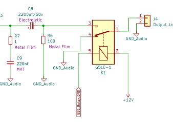

Hi Aim65. Sorry for such a late reply. Yes the trimmer and the cap set the trigger time. Once the delay is initiated the relay is grounded through the output pin of the 555, engaging it.
I feel that the reason why the turn off isn't instantaneous is because to the cap holding charge. I'm wondering if a smaller RC combo might allow for the cap to discharge quick enough to close the relay for turn off or else maybe I can use a discharge resistor?
I've used this scheme before without trouble, but in the future the MOSFET looks like a good idea too.
