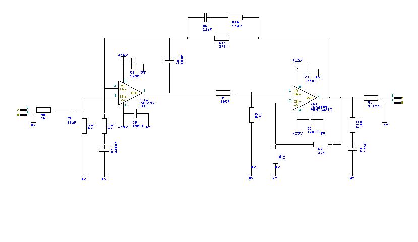

I am very interested in the concept of taking a cheap TDA2030 and improving it with a nested feedback loop. To this end I have draw up a version of your design based on a TDA2030.
Could you confirm that I have it right. I tried to make it easier to read so I could understand it better. So the drawing looks different to yours. I have just stuck your values in for now, clearly they will need reworking. I have put the amp and opamp on the same rails 15V as this is sufficient for the TDA2030 and the NE5532 can cope with 15V.
I wondered if it would be sensible to have an option for a resistor in parralel with C6 so the gain of the NE5532 loop could be reduced if required for stability. At the moment the design will vary with the open loop gain of the NE5532, but a 1M or poss smaller resistor would define the gain. What do you think?
Drawing below (hopefully) Regards, Andrew

The overall closed-loop gain of both op-amps is 28, and the closed-loop gain of the TDA is 23. That forces the swing at the output of the NE5532 to be fairly low - less than 1V peak. However, the closed-loop gain of the combination is not 5, it's still 28.
You can use a high-value resistance in parallel with the 68pF Integrator/dominant pole capacitance to reduce the dependence on the open-loop gain of the NE5532. I need to plug the values into LTSpice to see what's reasonable, but 1M looks ok.
Some errata in the TDA2050 schematic:
The outer feedback should be taken outside of the 0.22 ohm resistor at the output of the chipamp. This is important for stability, as well as controlling H3.
The Boucherot cell should be 10R (or lower) + 100n. This isn't actually necessary for the LM1875, but is probably helpful for stability - it contributes a few degrees of phase margin.
The input network should be have a 27k or similar to ground.

Hi linuxguru
Thanks for your feedback.
The 27K was a typo, I have also added the HF filter which I had left off.
Thanks for the info on the 0.22R, I thought it was just to isolate the output from cable capacitance. Do you know the mechanism by which it reduces H3 or was that discovered impirically.
Your right 1M probably isn't required with an amp like the NE5532 and with the TDAs gain being defined. However I worked on a compound opamp design in which the origonal designer had not controled the open loop gains of either of the opamps, relying entirely on the single loop to control the behaviour and they went unstable all the time as the loop characteristics changed. So I am a bit over sensitised to leaving opamps open loop locally, even if the entire loop gain is controlled. I have added a location for the 1M resistor, I don't have to fit it if its not required or detrimental.
However I have found in the past that controling the open loop gain of internal parts of an amplifer so that it is flat accross the audio bandwidth can improve the sound quality. So it may be worth me doing some experiments to see what effect it does have.

I plugged a gain-limiting resistance in parallel with C4 into LTSpice, and there is minimal impact on distortion and sonics between 470k to 1M, and up to 10 dB higher distortion at 100k. On the whole, the impact is minimal, so one might as well include a 330k..470k gain-limiting resistor for repeatable stability, especially with faster or higher-gain opamps like the LM4562 or LT1469. I'll post an updated schematic with the resistor and a slightly optimized compensation network in due course.
Using an LT1208 with a slightly tweaked gain and compensation network actually shows greater phase margin (up to 80-85 degrees) compared to ~70 degrees with the NE5532. I don't think it matters much to the sonics, but it might be worthing rolling op-amps and auditioning.

Depends on the drive capability from the VAS (?) of the NE5534, but perhaps possible if the resistor network at the input(s) of the chipamp is made higher impedance, say of the order of ~10k.
> if a NE5532 was used, would it be possible to use the second opamp as a servo and WHERE should it be placed for stability and precision?
I haven't thought about a DC servo yet.
> Would it be much different if NE5532 was A-class biased (f.e. 6k8 to "+" supply)?
Not much - at low swings (< 1V), the NE5532 seems to have fairly low distortion already. I'll plug in the 6.8k resistor later and check - it's an inexpensive improvement.
> Is it possible to compensate the range of National Chipamps when used at a gain = 2?
In the sims, the LM1875 can be used below the recommended gain of 10 with suitable compensation. However, I'm not sure that it extends all the way to a gain of 2. For unity gain or similar operation, the TI/Burr-Brown OPA549 family may be more useful, since they're unity-gain stable.
I have been using a similar circuit for several years now, but with the
differences of the op amp runs on +- 15 volts, output +- 36 volts
I am wondering if this cct will still work as well if the op amp voltage is reduced and the input divider network to the LM1875 reduced by half.
This is optimal for me because the output is not limited to the op amp's
maximum supply voltage.
