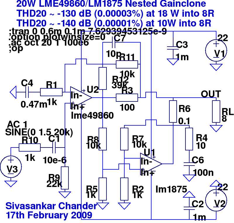

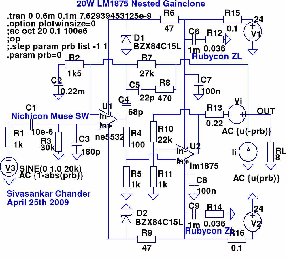

LM1875 nested Gainclone
My apologies! NE5532 has not yet arrived.
The reputable JRC NJM4560 did arrive and I could employ them if you think they are compatible with this project.
There's probably no harm in trying out the 4560 instead of the the NE5532 here. Is it also a dual op-amp in a standard 8-pin package?
It's probably a bit faster than the NE5532, but the compensation scheme should take care of that - though the sonics may not be optimal. You may want to go with lower +/- Vs rails initally, and check for HF oscillations with an oscilloscope before going to 28 or 35 V rails.
NXP NE5532, 10mhz, Slew9V, unity stable
JRC NJM4560, 10mhz, Slew4V
*Pin compatible
**4560L isn't pin compatible, but rather 8 pins straight in a row, and its rated to 800mw PD although it can do 1 watt, in this larger version--I have these.
Could you please upload the LM1875 LTspice model...I have the Modpex model, but it's spice3 format and I'm not smart enough to convert it to psice format, thank you.
Here it is:
http://www.diyaudio.com/forums/chip-amps/138762-lm1875-nested-gainclone-3.html#post1813245
Pedja probably converted it to PSpice. No guarantees about its accuracy - it seems to have far more diodes and than transistors. It seems to pass sanity checks when used in simple inverting and non-inverting configurations.

With NE5532 and 4580, stereo op-amps feeding single power op-amps, why not use the NE5532's or njm4580's 2 channels in parallel to turn some noise into a tiny bit of heat? Just a curiosity, but I noticed that Each channel on the Revo 5.1's silver 1/8" jack has a stereo op-amp, and there are four good size "47R5" resistors right before the jack. That sounds great! But, the green jack with just one stereo op-amp is lackluster and just downright boring. So, what do you think of parallel?
Question:
It will increase the current drive of the op-amp, for sure, but in this topology the NE5532 is not pushing too much current (a few mA at most) at any rate. I don't think there's any benefit here.
OTOH, for a headphone amp, paralleling op-amps outputs is a generally a sound idea.
Well, I'm curious. If it isn't pushing much current, then is there an advantage to getting it to push some current, as in partial biasing to class-A?
Partial Class-A biasing of the input op-amp might be worth considering - I looked at it a while ago in another context, and it did not make much difference in the sim then. However, for this topology it might help the sonics a bit. I need a structural (i.e. transistor-level) model of the input op-amp to model this right.

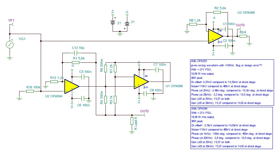

OPA604 & TDA7293
How about OPA604 & TDA7293?

Hmmm, 604 offset trim pins are ~ before / after "distortion rejection circuitry" ...
Hmmm mmmm, 7293 has separate input section and is easily 'stack-able' (better way: master and multiple slaves) for very high current to go along with its high voltage (±40V, test MAX ±50V, abs MAX ±60V) and has the buffer driver pin and boot loader / bootstrap pins

Follow Jung's rules for a composite opamp.
It should make for a very good signal and that may mean very good sound.
BTW
quoting 100W for +-40Vdc supply rails shows you are not interested in a good signal and certainly not interested in obtaining a good sound.
Interesting. How would you go about it? Same values as on the original combo?
What about DC offset? It probably needs some feedback decoupling on one or both chips.
It would be interesting to try it with an LM3886.
And it would be great if Walt was reading this and contributed some tip to go about it.

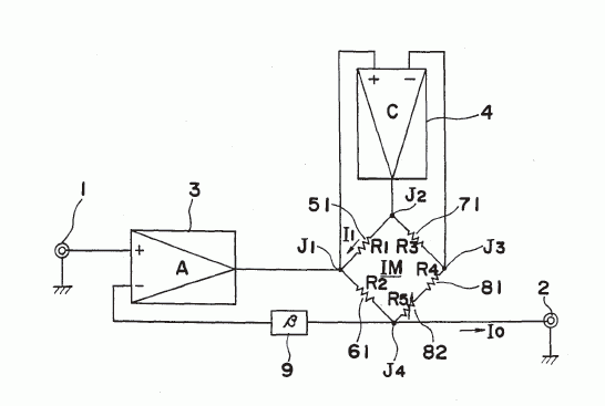

I eventually went with a Howland Current Pump as the power stage, nested within a traditional voltage-series GNFB loop, i.e. a composite amp with elements borrowed from Mauro's MyRef and Walt Jung's Composite Buffer. I did this on the hunch that it would be easier to stabilize with a transconductance amp as the power stage, and that turned out to be correct for the LM1875 (the key idea to stabilize it is a single small-valued cap or RC between the junction of Rz-R2, and the non-inverting input of the current-pump - which turns out to be an improved variant of the DeBoo integrator). The LM3886 in a nearly identical circuit turned out to be harder to stabilize, but I succeeded after borrowing ideas from the MyRef Rev C.
I looked at the TDA729x, but it had several issues:
1) It is reported to be finicky about power sequencing - it's been known to latch-up on occasion.
2) It requires a bootstrap cap, and I wasn't sure of the effect of the bootstrap (or lack of it) in a Howland Current Pump.
3) It doesn't have an official Spice model to help model stuff like 1) and 2) above.
So I stayed with the known LM1875 and LM3886, with no regrets.
Thanks for posting the heads-up about TDA729x, because I was just starting work on a TDA7293 version. Food for thought about perhaps stick with what I know will work.
The TDA7293 will probably behave very nicely if when using TDA7293 specific bootstrap hookup. At higher voltage, it turns out to be a pleasant tone rock the house classic mid-fi, with actually very good clarity and durability. They're also easily paralleled with only one voltage amp active, which is a great simplicity and intensely powerful.
The TDA7294 may behave if used at voltages typical for TDA7296/LM1875. Conveniently, in undervolted condition, TDA7294 supports slightly lower gain, at much benefit to imaging. Scaled even smaller than the LM1875, the TDA7294 can make a very high fidelity low wattage amplifier.
The majority of the trouble with TDA7293/4/5/6 ends if the power decoupling caps are 220u although parallel 220u (440u) may be used for more punchy bass. It is somewhat helpful if the bootstrap cap is 33u rather than 22u. It is rather extremely helpful if the nfb-shunt-cap (in- coupler) is sized up much larger, such as 220u with 2k7 for that RC. Also, the optimal gain factor and feedback current do both depend on the power voltage chosen. For TDA7294, the input cap (in+ coupler) should be 1uF or smaller. For TDA7293, the input cap (in+ coupler) can be whatever size you like (if when using TDA7293 specific bootstrap hookup).
Generally, the standby circuit is hooked up per the datasheet.
However, the mute circuit can be powered through only one part--a simple 10k resistor will do it reliably (no extra resistor, no extra diode, no extra cap needed).
I think that the easiest way to use TDA7293 as a nested amplifier is to use it in slave mode, driven by whatever you like for voltage amp, such as a natsemi driver chip.
