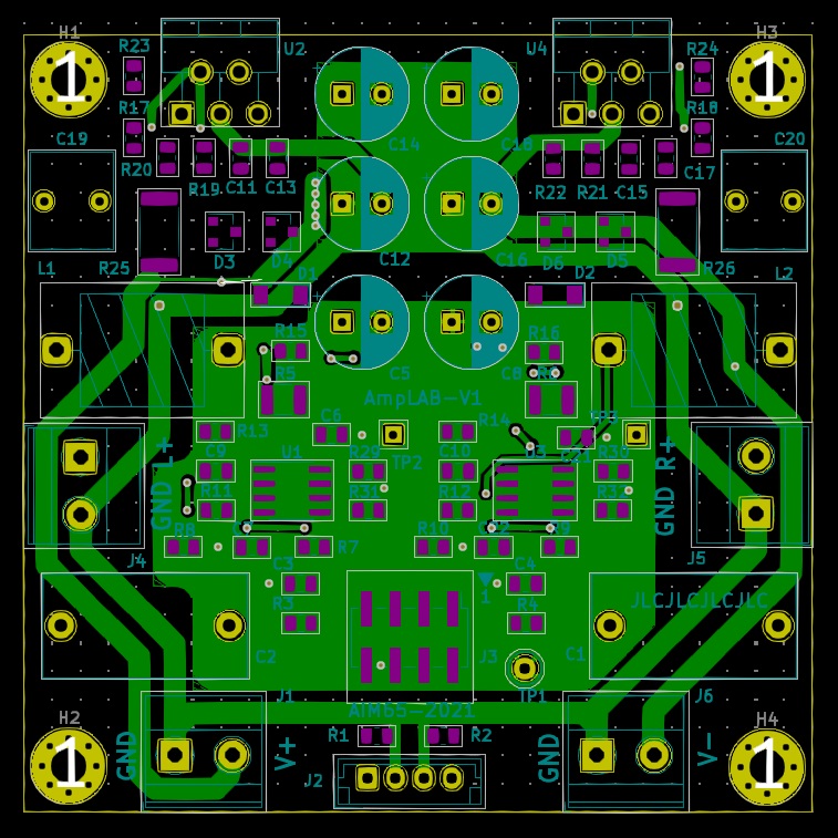

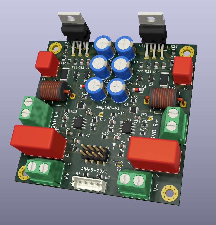

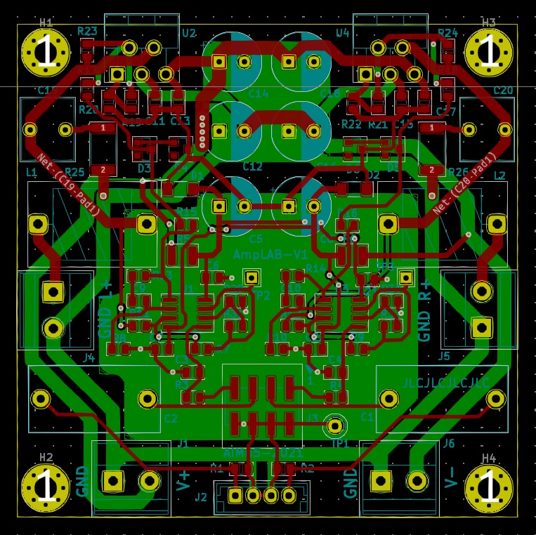

Hi Joensd
Here are some details about the amp pcb. Constructive criticism is welcomed, I still have some questions about some choices I've made, I also have an idea for an improvement. That's the one I've tested after post #665, but with no measurable effect. But let's see if my questions and improvements ideas converge with the ones of this thread readers...
Pictures are: Front - Back - Both then 3D views.
Chris
Hi AIM65,Chris
Its a wonderful board. i started one year ago with KICAD but after not using it any more i lost everything in my head.🙄😛
I am not able to criticize your work in making PCB. If you can sum of all your open points what are you planning and points from all other members as a LOP -list of open points then maybe for us its easier to check all of them and can discuss this easier.

Thanks a lot; I´ll have a look at it. Can you provide the schematic?Pictures are: Front - Back - Both then 3D views.
It really is a beautiful layout but as much as I appreciate nice looking PCBs, I am in the form follows function camp.
I would have tried to keep both feedback loops as short as possible; no matter what. So I would have moved the opamp near the LM1875.
But that´s me not having much experience with composite layouts, thinking they are terribly sensitive towards any additional inductance introduced.
I also would have tried to use the bottom layer more. Decoupling caps, especially near the chip, can go into the bottom layer, keeping top layer paths cleaner and shorter. Also the bottom is mostly GND-polygon anyway.
I´m not sure I would have put the capacitor/star-GND far away from the supply voltage input. To have the capacitors there might be good but then you better take substantial traces/polygons to that point.
What I definitely get rid of, if you ever make a new layout, is the GND-routing:
You basically created a little loop going from each of the screw-connectors (V+/GND & V-/GND) to the "star-GND". Not only that but the traces are also very thin.
GND is your reference and should be low inductance.
Without a schematic I can´t really trace the GND-routing but it seems you separated high-current-GND-return (speaker) from the rest but again, I think that "loop" and the thin traces rendered that very ineffective.

Hi
thanks for comments, some replies :
local feedback loop of the two amp are shorts.
I also would have tried to use the bottom layer more. Decoupling caps, especially near the chip, can go into the bottom layer, keeping top layer paths cleaner and shorter. Also, the bottom is mostly GND-polygon anyway.
- Amp op isn’t too close power amp as I wanted to separate control and power parts.
- No, single side parts were a design constraint, and the cap are very close opamp and power amp, this no HF. LM4562 may be tricky about decoupling, no issue here.
- I do not see the point but I agree that power tracks (+,-, Gnd and speakers) could be wider.
- This is 2mm, not so thin and don’t forget that amp is +/-17V, so 30Vpp max on my 8Ω speaker: between 1.8 to 2.5A max.
- ‘Signal’ and ‘Power’ grounds do not share the same current flow and are connected together at the input, this is where the center of the star is. On the output side feedback for the differential amplifier is taken close the Thiele network on the TDA side. That means that the voltage sensed by the feeback loop is the output and the TDA + parasitic voltage on the track between the negative terminal of the speaker and the input: center of the star. So yes, this small part of the layout is a ground loop. But, and I may be wrong, the parasitic voltage in the ground loop apply to the feedback signal of the map (large value) not on the input of the loop where it would have been amplified.
Put the connectors where it serves the best audio quality, that is not necessarily at the PCB edge, it may be on the center of it, or just about anywhere on the PCB.
- This is not the way I work; I have design goals and design constraints. This is a TDA2050 project: it very far from a ‘best parts available project’! There are always many trade-offs to deal with, TDA2050 is a trade-off, my smps is trade off, pcb layout is also a trade-off.
- Sure.
- I do not see the point at all. Take a step back and consider the whole circuit: PSU – cable between psu – and power track on the pcb. The power tracks on the pcb are just extension of the power wire so we really don’t care how they are wired…some even says they have to be twisted! In addition It’s an AB class amplifier main (high) currents are between + and GND then – and GND, not between + and - : no need to superpose the tracks on the pcb : - is not a return path of +. IMHO what matter is the path between ecap-TDA-speaker-return to ecap.
- Ok I get it: having a center ground terminal for the speakers in a stereo amp is a good point, this should also be the center of the star where to connect signal ground (input) and power. I’ll have to think about it for next project!
Chris
