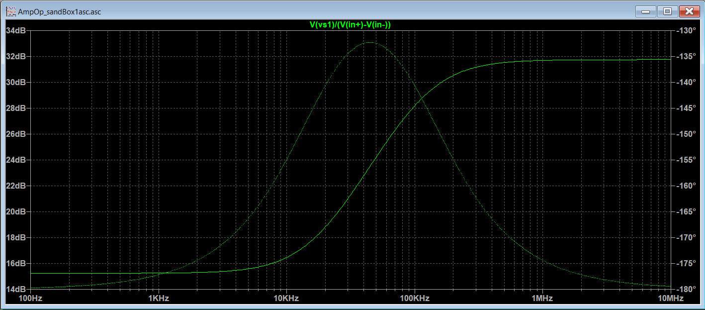

Keeping the right value of resistor between input AND with resistor between in+ and GND is mandatory to keep TDA stable with a signal gain lower than recommended 24 or 30dB. Beyond this theoric answer, I 've made some test with and serial RC network between inputs rather than a resistor. This allows to keep low noise gain at DC and LF but to have a sufficient one at HF where phase margin getting too low and amp tend to oscillate.
With R=510Ω and C=2.7nF, I get permanent oscillation (not only close to clipping) at 28kHz where noise gain close to 20dB. See noise gain plot attached.
IMHO this confirm the need to use the right noise gain, then I decided to stick with safe value : 510Ω.

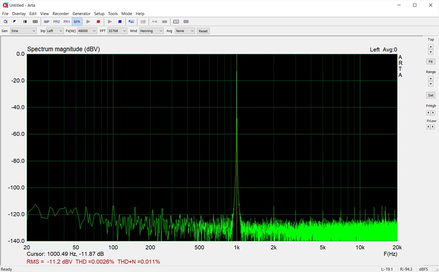

Thanks for your words and also thanks to remind me those order of magnitude related to the capabilities of my acquisition chain....94 is not 130 !. 94dB is 16bit ENOB wich is already very good at least for diyers !
Even if the current smps is cause of some unexpected defaults of the signal, this is not the main cause with lead to not so good THD figures : I have tried a linear supply and got the same the distortion profile : odd and even harmonics and values within 10db from H2 to H8 (8Ω, -3dB).

I took time to provide you a real answer, I made the test by removing resistor between inputs. Result: it oscillate, see picture where probe is 1:1 connected at the output and with input open.
Regarding your previous message and Mark comment :
He’s right, but in our very particular case we do not raise noise gain too much: we just raise it to its nominal value given by manufacturer, so nothing wrong with that.
In usual inverting or non-inverting configurations, TDA2050 is stable with a gain of 30dB minimum. In those configurations noise gain is equal to signal gain.
Within our composite amp, signal gain is lowered to a value where amp is unstable (4.8 on my amp), in order to get amp stable, noise gain is modified by R19 and R20 (not R19 alone) which set a noise gain of 38.7 (32dB) where amp is stable. Amp stability criteria apply on noise gain, not signal gain, but usually those two values are the same.
While Googling to get some education on the subject, I found 3 uses cases of this noise gain trick on opamp:
• Stabilize decompensated opamp
• Stabilize amp with too large capacitive load
• Magnify internal defect of opamp (such as noise or distortion) in order to qualify them
4th use case in our one: stabilize an amp part of a larger control loop.

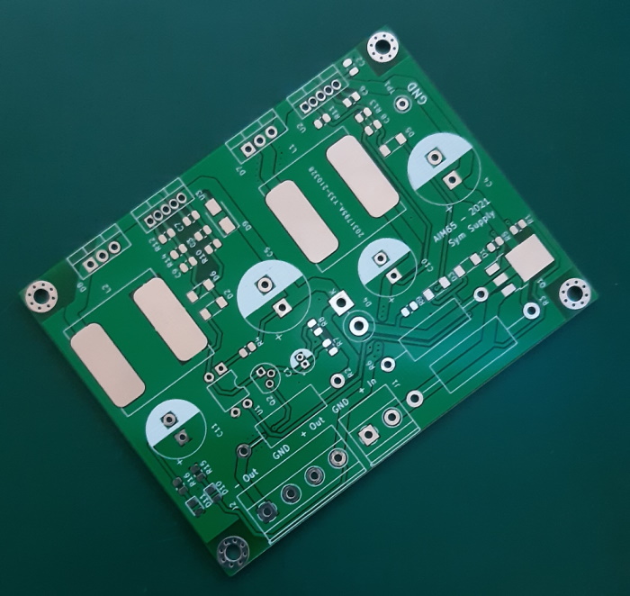

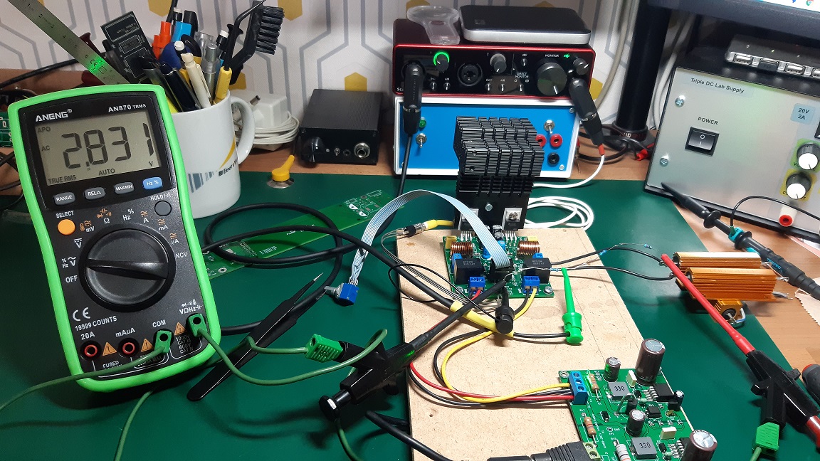

done some tests yesterday and found that I had a bad gnd connection for the input of the focusrite as it was connected to the gnd point of the load. Now focusrite output, focusrite input and amp signal gnd are all connected to the same signal gnd of the pcb...much better 🙂.
I also install new selfs and a new mosfet on the supply. This has a positive impact on THD+N, as those selfs doesn't go into core saturation. But this supply is still too small, V2 is still awaited. For V2, I've received today the pcb.

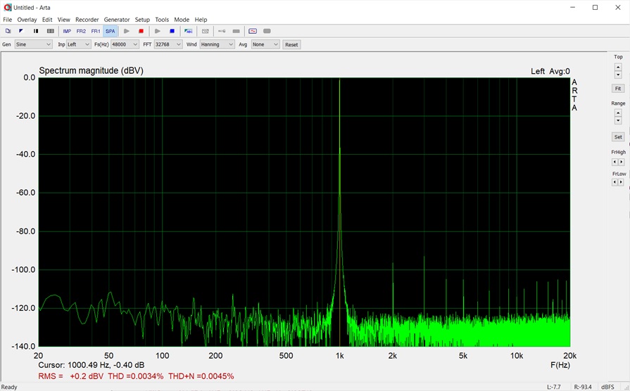

Some measurements :
Pic#1 : 8R / max power before clipping start
Pic#1 : 8R / 2.82V=1W
Chris

My Version 2 supply, which is ongoing, is built around an XL4016, which is 5pin and has on chip PMOS switch, 12A rated... With a 10A rated self, I expect it to be much more well suited to the little amp. But for now, it's too early to speak of results, as I haven't built it yet : I'm still waiting for parts from LCSC.
Version 1, built round LM2596 is not enough...at least of negative side.
Chris

Just a quick comment about the ARTA measurements though:
You need to make all your measurements at the same dBV level, othervice you need several loopback THDs of your system with different input levels.
You need to make an attenuator so that every measurement has the same dBV level, which must be the same as your system loopback measurement was made at.
0dBV that is...
Then the rest is pure mathematics.
Thanks for the hint. That looks like a promising candidate and I agree that an integrated switch makes life/PCB-layout at least a little easier.
LTC3780 would make a nice generic "power block" as it is buck&boost and could be used for a number of amps.
A transfomer+buck/boost-converter is still simpler than a AC/DC-SMPS.
I personally would like a regulated PSU as it doesn´t suffer from sagging rail voltages like a linear PSU.
There are ready-made modules on eehbay and amasin (XL4015/XL4016/LTC3780) just like the LM2596 which I have a few of.
Cheap as chips but apparently the LTC3780-ones are more expensive and don´t seem very well built.
I might give the XL4016 a try and yes, please report your findings about the design.
