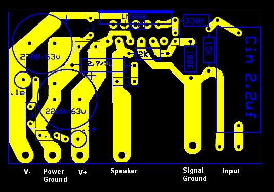

May be this time i have understand & implemented the correct type.🙁

what if i use 2200/63v cap of 30 mm dia??

Peter Daniel uses fairly high value decoupling capacitors in his designs. This allows him to delete all the smoothing capacitance from the PSU and still give him adequate performance.
Hi Neeraj
That last layout in post 46 is starting to look good.
The power supply decoupling is really nicely done now.
There's still a couple of problems though:
First, there's a 470uF capacitor that looks like it went in by mistake.
Also the Zobel network (2.7R, 0.1uF) should be connected to power ground, not signal ground.
I've changed the layout a bit and attached a picture to show what I mean.
I'm not sure how you want to organize the grounding.
You might need extra "Power Ground" connections on the PCB because all the following need to be connected together somehow:
A) "Power Ground" on the PCB
B) 0V on the power supply
C) The loudspeaker return wire
D) The chassis
E) Safety earth
I included a "Signal Ground" connection but you probably don't need it. The "Signal Ground" is often just connected to the "Power Ground" on the PCB with a 10R resistor, and not separately connected to the chassis. This works well but then the "ground" terminal of the input socket must be connected to the chassis where it is mounted.

Hi Godfrey🙂
The PCb layout looks more neat & clean then drawn by me.
As per AnderwT & Carlos FM's Schematic
1. Connect Cz to Power Ground.
2. Rz is connected to Speaker Out from Chip
3. 470uF capacitor is intentionally put there to block DC( As recomended by AndrewT)
what is the problem with using a 470uF NFB cap?
The RC in conjunction with 100r is 47ms.
The input filter (2u2F & 15k) is 33ms.
These values seem compatible.
But I do see a problem with the Rin value and the NFB values.
Neeraj has +IN seeing 15k33 to ground. The source is blocked by a capacitor
The -IN sees 2k0 to ground. the 100r is blocked by a capacitor.
This will introduce extra and avoidable output offset.

Any chance of a schematic or an assembly diagram in more readable colours than yellow on white? 🙂
Looks good to me, for what that's worth. 🙂 You could thicken a few tracks dramatically or use polygon fills to cover over zig-zags (dog-legs) but I can't see that it would make a lot of difference.

Hi random007,🙂🙂🙂
Sorry for my delayed reply.😱
1. Schematic is in Post#1
2. Ya can print in black also ( its on Express PCB)& i am doing the same on eagle free version also if you need i can mail so that you can modify to suit your need.
