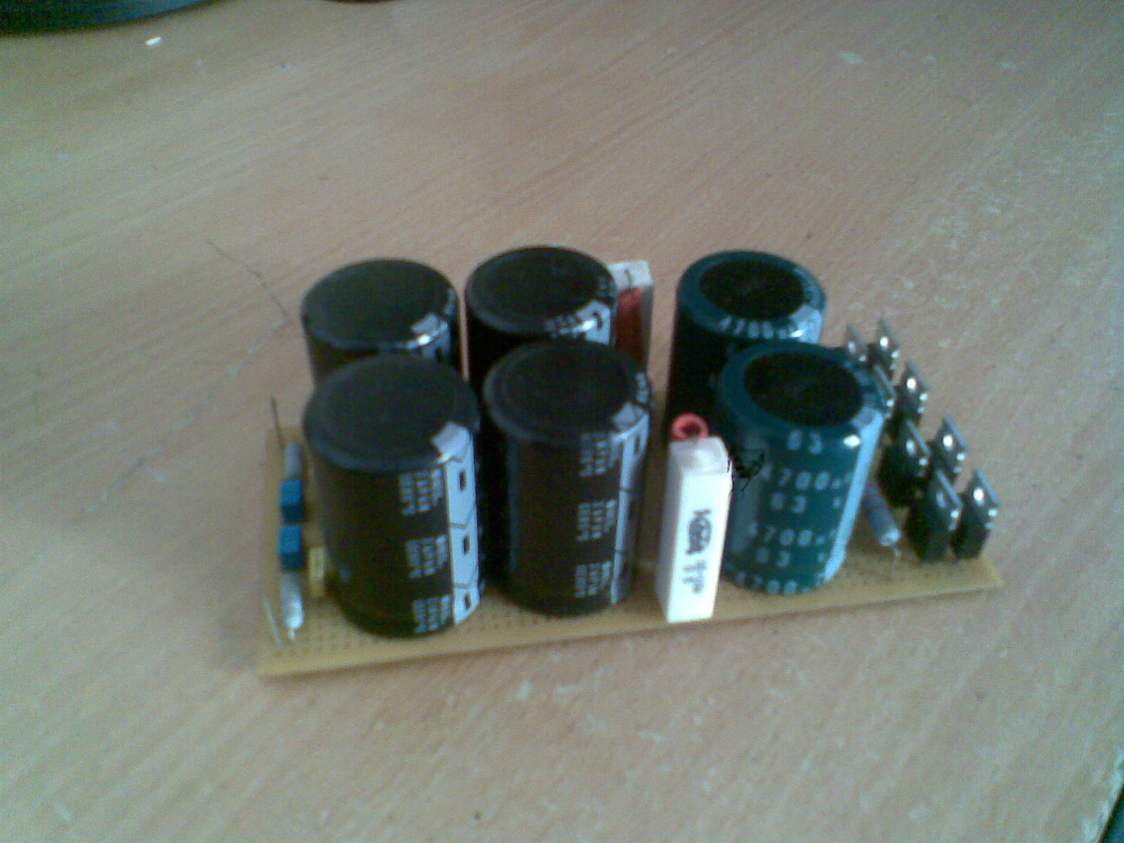

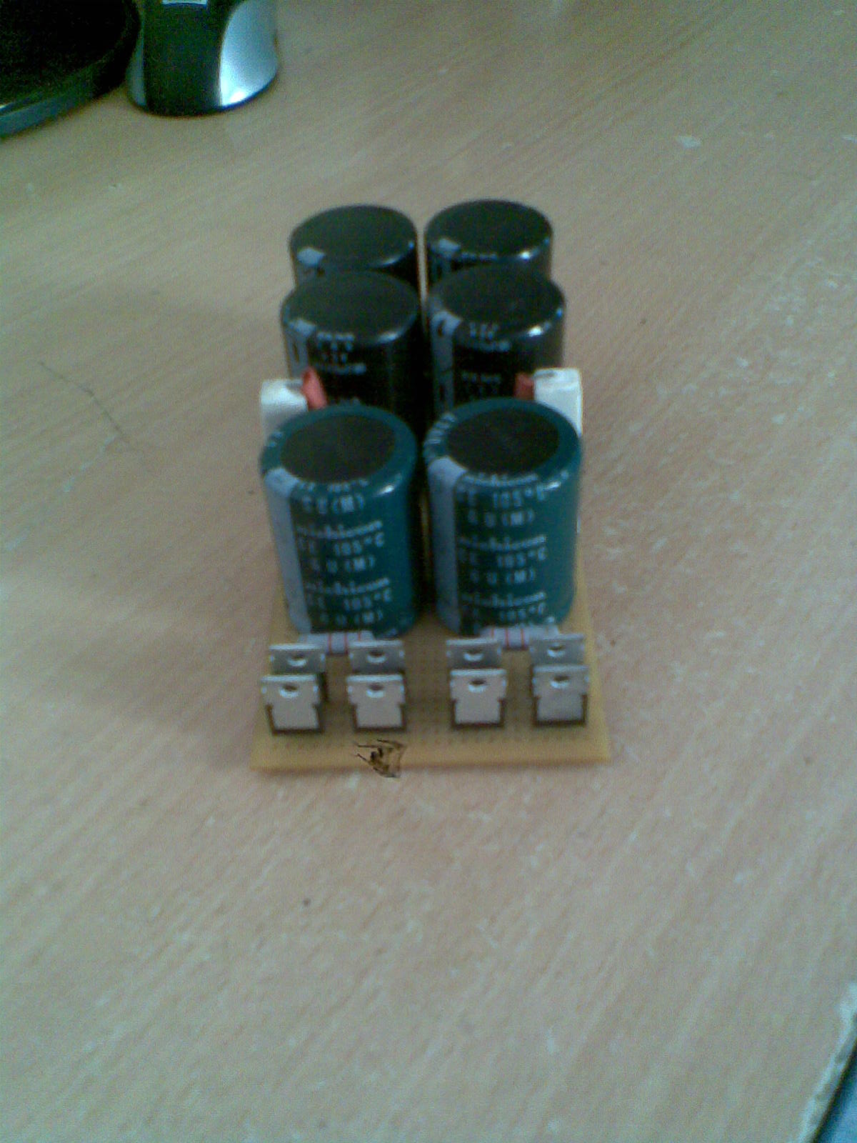

Hi ,
Kuldeep Singh PA Jee : Thanks.
AndrewT : Yes i remember that post. You are A good teacher for students like Me. Perhaps i um unable to understand the seriousness what u are talking about n will be glad fi you please explain. As told Low res photograph of
3.3mfd/100volt will be mounted directly on chip pins.my supply PCB
Random: Thanks for such appreciating words. i am working on your suggestion.
Godfrey: Thanks for the Hint.Actually Cz is connected to Power ground but the trace connecting star groud power & Power G was missed.
Now i have corrected the layout.
