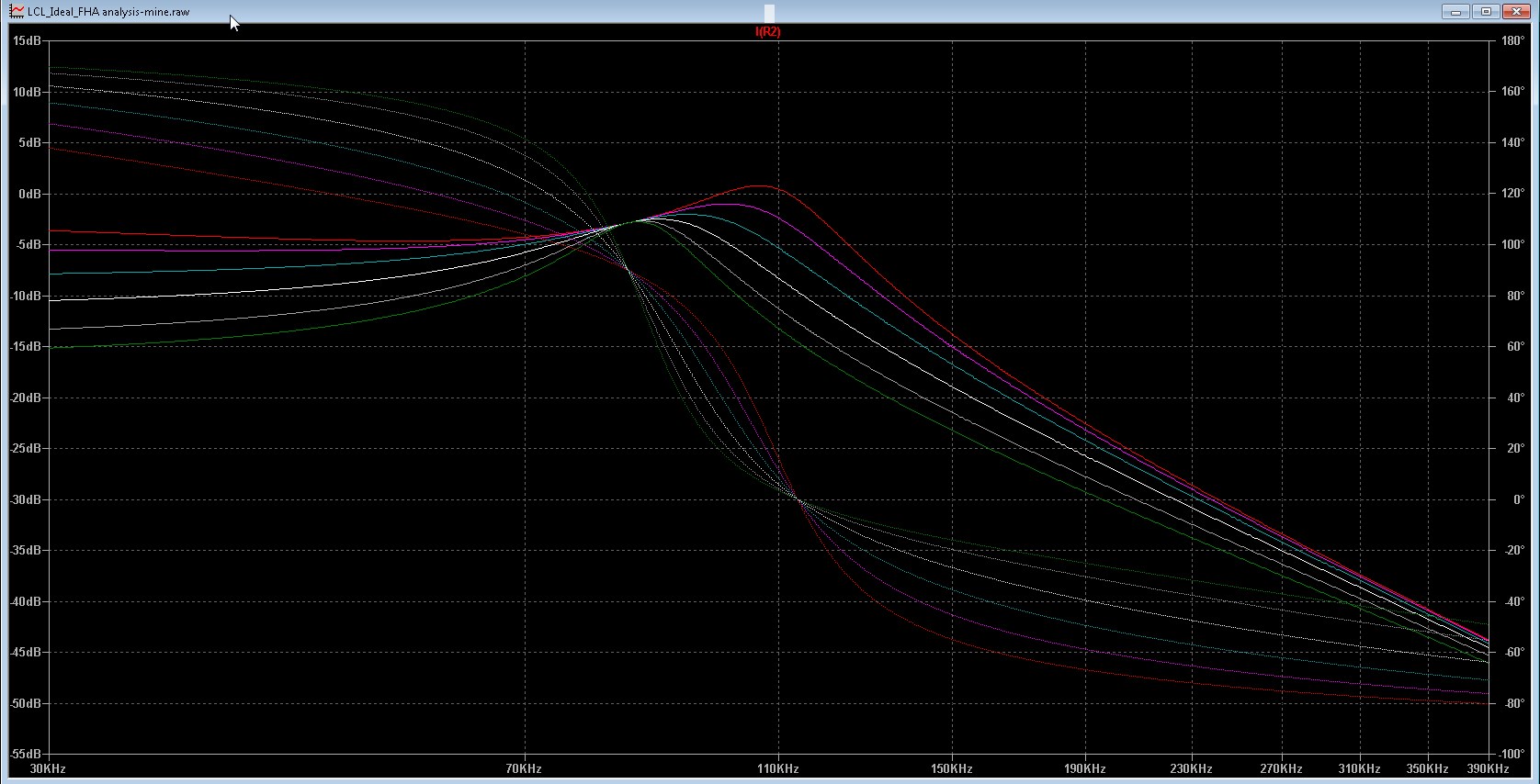

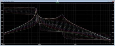

Yes Oke, there are a lot of different stuff about it.
For as I did read, a LCC has Cp Cs and Lr this is where circulation current be,
and Cs/Cp = 1 or 0.1 depending of what wide regulation we want.

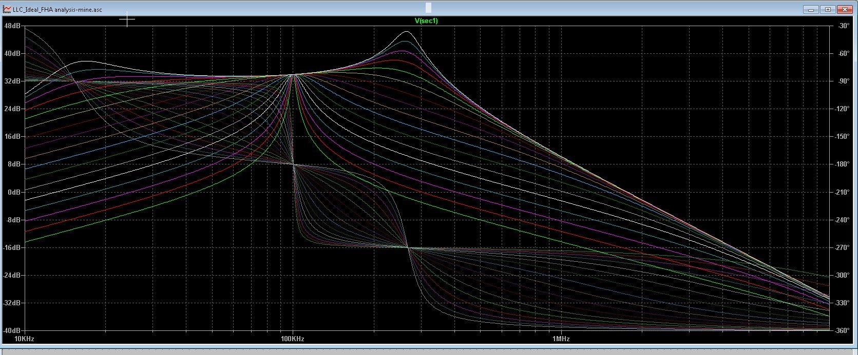

I have included a plot of the response of tank and transformer, If I use a small inductance in LCC
I get a extra resonance high in frequency, and to high load of the LCC tank, Cp is the one who
needs to do the trick, not the transformer who is just a isolation needed voltages.
The other plot is when I use inductance much higher as the Cp impedance, and lower that resonance
much below the working resonant points where it has to be.
I do talk about LCC?? I hope we have miscommunication about that? The LLC is a complete other thing
because here the transformer is a part of the resonance point and is indeed used for store circulation current
and if that inductance get wrong zvs will not occur. LCC has this circulation current into the resonance tank Lr
Cs and load cap Cp. We can include the transformer by put Cp on the secondary, I need that because of
I need high voltage, so have capacitance there in the windings I can use.
What concerns LLC you are right, the transformer is indeed a part of the whole tank, however I can just like
LLC can use a slotted bobbin for Lr using only Cp and Cs but is little harder to get right leakage therefore
a gap is used to trim, LCC needs no gap but maybe also need to adjust using one...

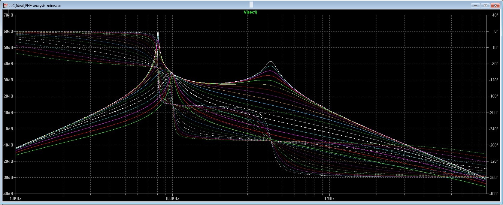

The LCL converter is also quite interesting, I did sim it and it can work fine without a load and still have zvs, but there is some higher circulation
currents lurking around, I have use M = 0.9 because under 1 vzs occur, above that zcs occur.
For audio amp supply purposes we need a fast regulating smps, open loop has higher output impedance's, also for LLC is this the case so
we are dependent of buffer elco,s like in normal supply.
LLC need a gap, these do not but can be used for adjustment purposes for transformer leakage.
here is LCL plot.

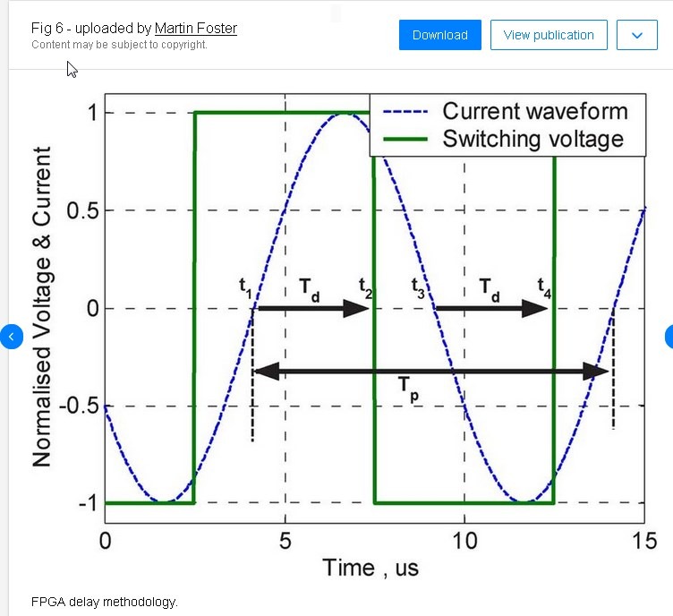

Again, with no gap, there is not enough energy stored in the magnetizing inductance to achieve ZVS. One needs to balance both the dead time setting and the magnetizing inductance to achieve ZVS. Operating above resonance at a higher frequency just makes the situation worse. Where I work, it is standard procedure to park the operating frequency just below resonance. This is especially useful if you have an application like a battery charger or an LED driver that needs a considerable change in frequency to control the output current. A small amount of loss due to circulating current is better than operating all the time in hard switching. If you are looking at using an LLC converter to power an amplifier, it would be useful to set up the output to run in quasi-constant power mode, so that the output sags instead of going into full protection mode, which usually involves auto-restart. Having the converter parked slightly beow resonance maximizes the frequency excursion needed to retain control in constant power mode.

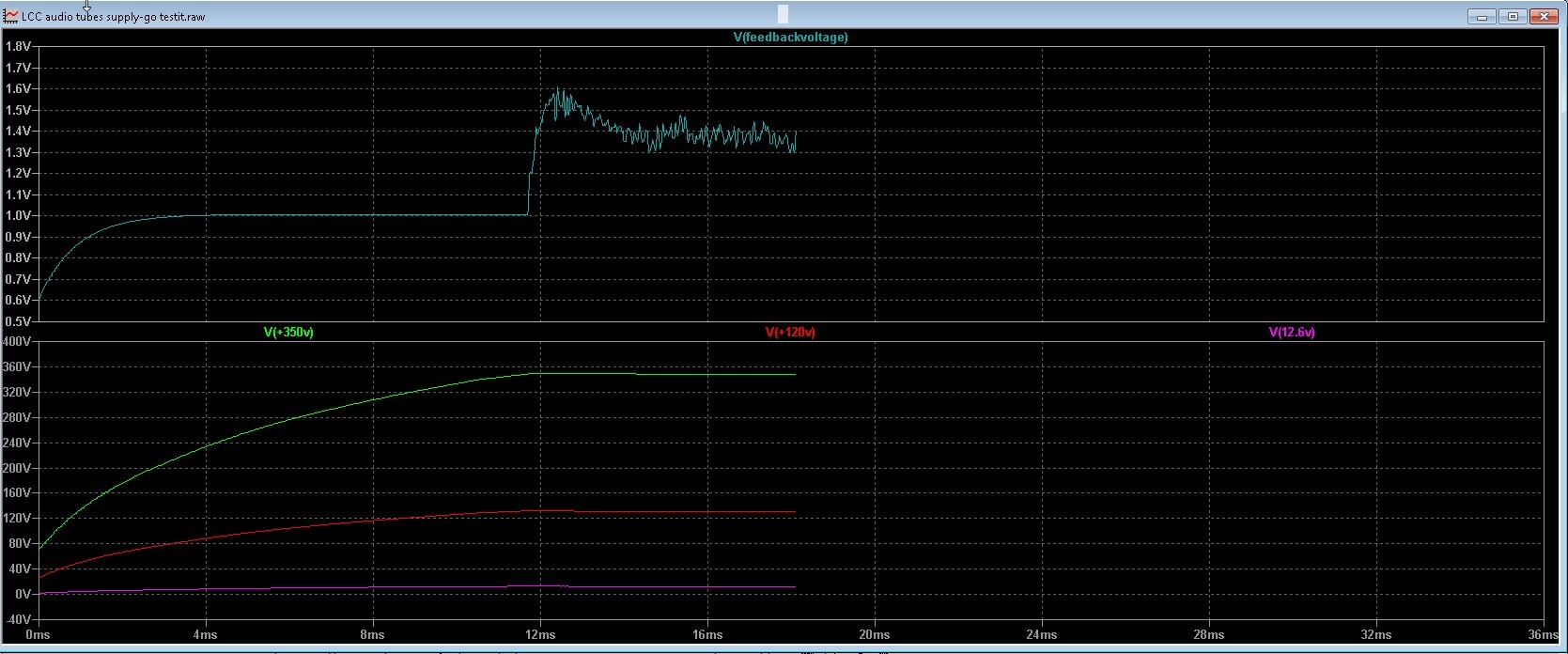

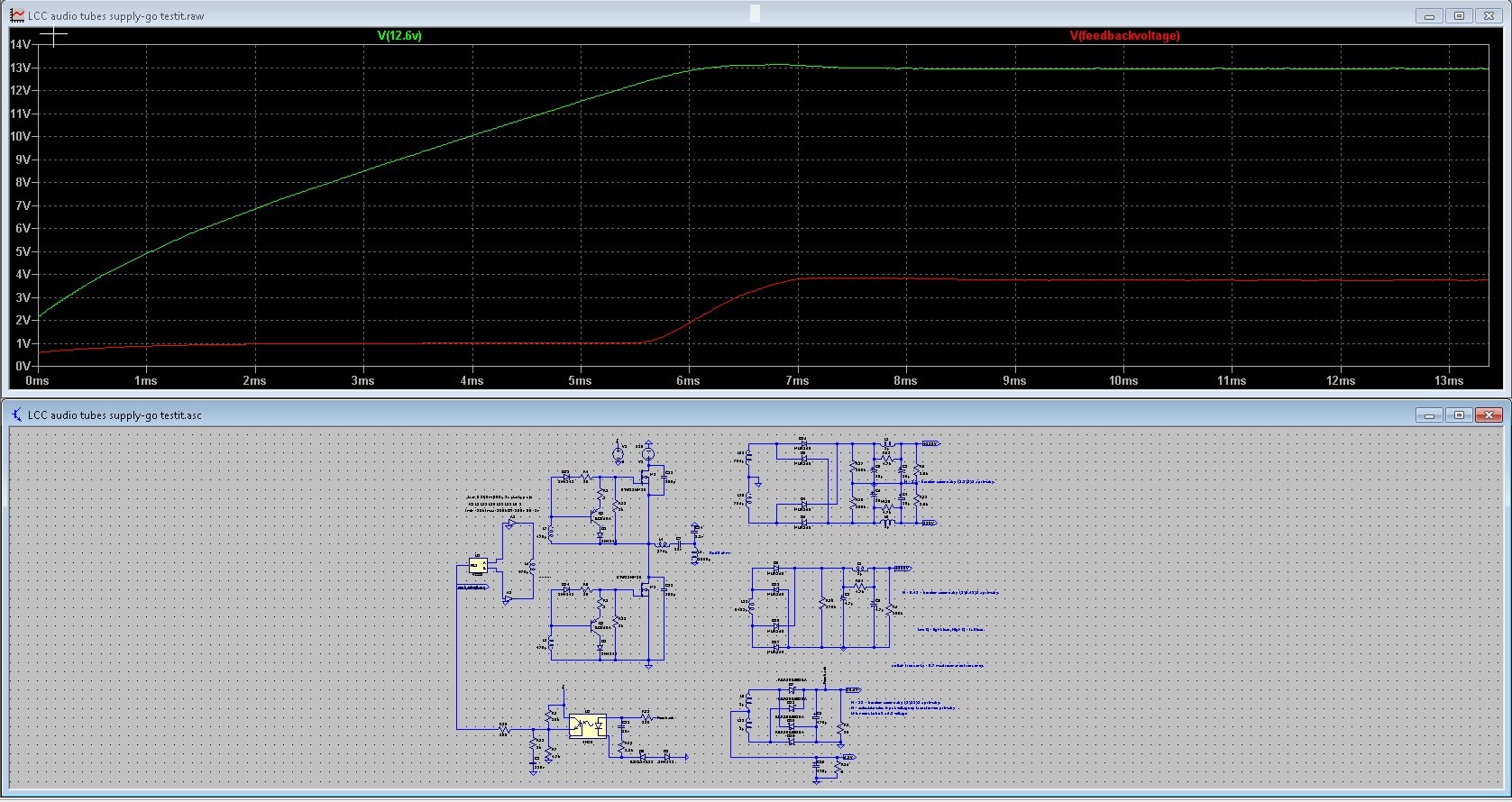

There is a problem I have to do yet, because when the 12 volt get regulated the open loop 350 volts and 2 x 120 is to low, I need to change the 12.6 6.3 outputs and lower the inductance so the voltage over the transformer rise, but maybe it is better to recalculate the locket transformer voltage who is then not 150 volts (half of input voltage) but get to 132 volts if supply is locked on 12.6 volts, so 132/350 = N 0.37 = (1/0.37squared)X primary inductance. (chooses for high Z what fit in transformer) and then it is right. or lower the 12.6 volts output inductance do work also, need more voltage from resonance tank, and nice it is a current source with the extra Cp capacitor so not more losses..
so I recalculate for new N for high voltages.
See pic of sims, I have recalculate the other open loop voltages after measure the transformer voltage on steady 12,6 volts what was 132 volts peak peak. And now I have the right voltages. but these change with load, not a problem with tubes. the sinusoidal signal has to be lagged on the square for zvs as seen on pictures.. I did lowering the 12,6 volt inductance where the transformer voltage did rise to above 150 volts peak peak, so as you see the current source works quite oke.
And the problem I have, and not yet know, is do I have to short all secondary transformer outputs for getting the leakage of the transformer? I have more then one

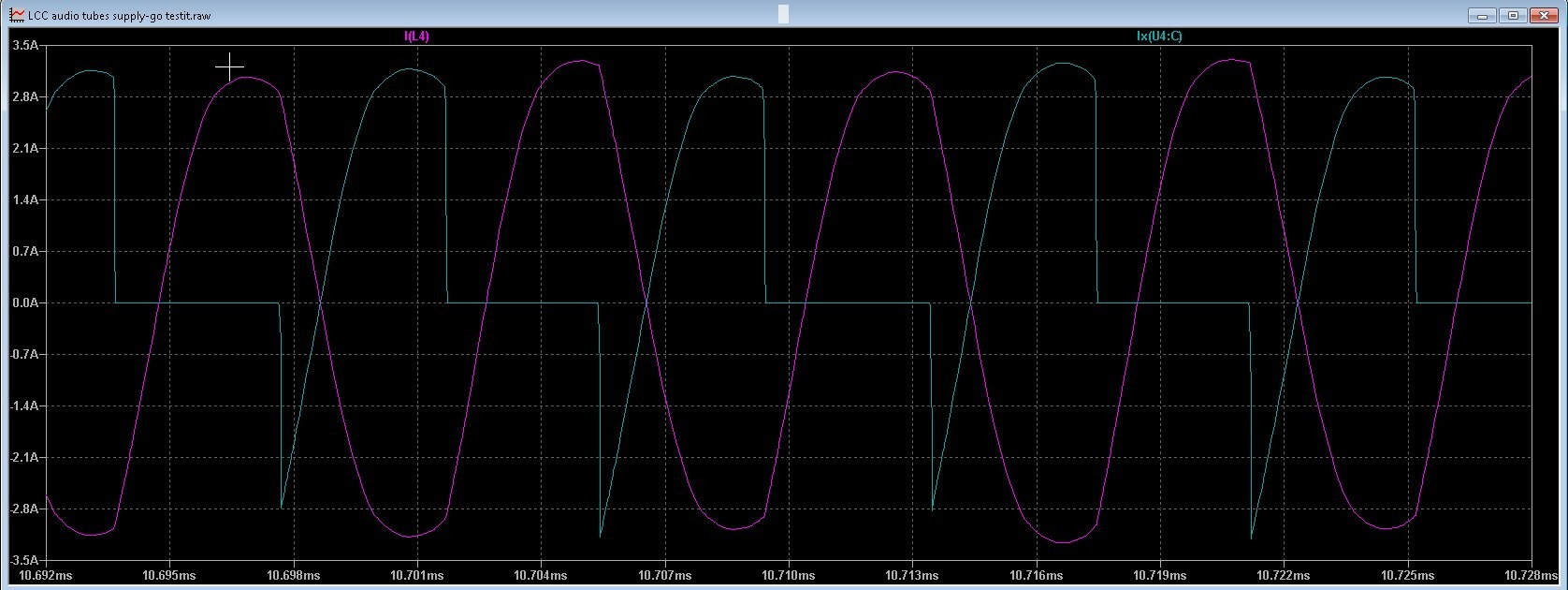

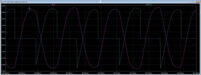

Now we are talking LLC, I have try the system to see if it does also high voltages, it does.
I did get as low load as 100mA and still it does regulate.
different is also the LLC when do the N of transformer right, it is around resonance and has a nice clean sinusoidal
on the transformer.
No I ask myself, can I also do two transformers one for the regulated low voltage high current and one for the HV voltages,
only the high current is regulated and the other is open loop because for tubes 10 or 20 volts differences she don,t care about.
The LCC do also nice but it does pulsing into the transformer, that is because of the Cp capacitor where the circulating currents is twirling.
And something else when measure the leak in a transformer, do I need to short all the windings in secondary? or just one of them? I did
never ask but do now for sure, because I think just one needs shorted, the transformer has multiply output voltages.
I do calculate the two LCC outputs separately because that is needed to get it right.
thanks.

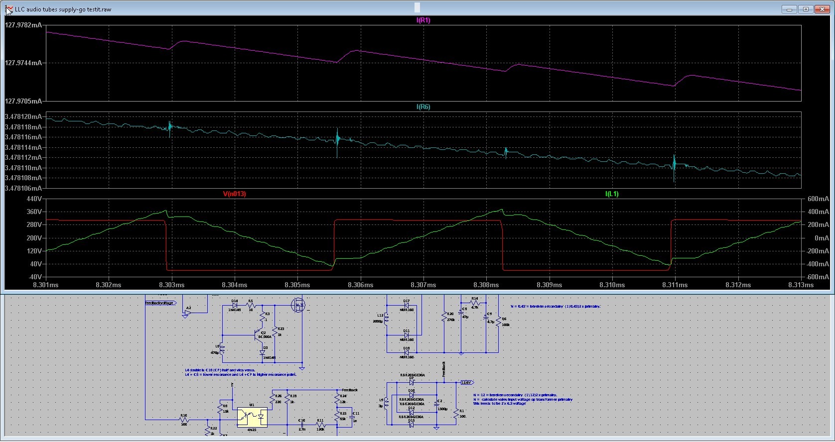

I have now in simulation a LLC and a LCC, last because I have a high voltage output for tube supply.
The LLC do also the high voltage quite oke.
Better ZVS in LCC.
regulation in current mode for fast response. Oke, I did see that calculating it is not that difficult, I can use the power transfer
equation only, and use a RLC calculator on google is all I need in fact. then simulate and watch the voltages
over the resonance capacitor and use a Q who satisfy the regulation from low to high.
